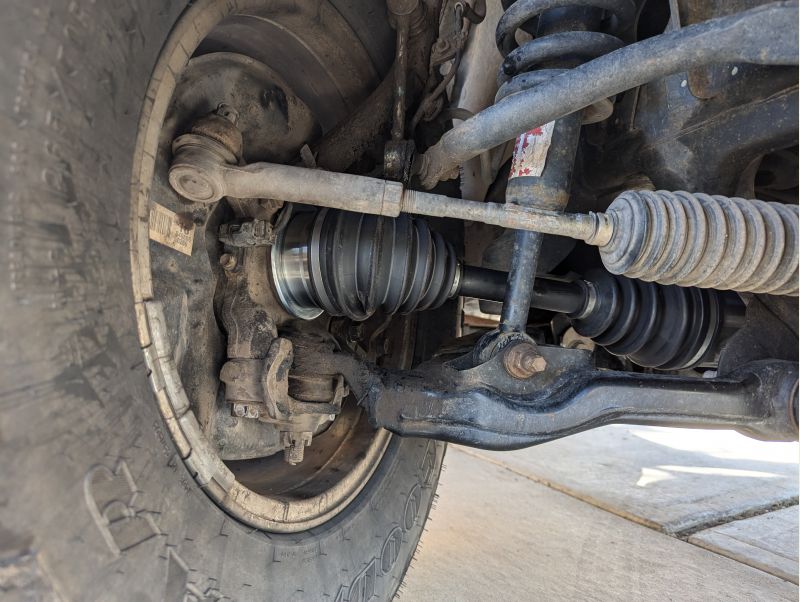

This week we hit a milestone of sorts. 261,000 miles. To "celebrate" I made a decision that will extend its life. And yes, it did cost some serious money, but the truck just keeps on going. Plus the $$Prices of a newer replacement Tacoma is bonkers. And there is no question about switching to any other brand.
So today we replaced the front left and right side axle and CV assemblies, plus the front wheel bearings. The noises and vibrations are now gone, along with about $1K for parts. Amazing how quiet and smooth it drives again. Last year we replaced some worn front-end suspension components, lower arms, shocks, and so on.
Soon we'll check the valve lash clearances as suggested by toyota_mdt_tech.
It doesn't look all spiffy and shiny. The paint clear coat is shot but that is only cosmetic and removes the concern of scratching the paint of a newer, shinier truck. Many of the mountain roads around here are overgrown. The sheet metal is all straight though, and everything else still functions.
I had help from a mechanic nephew.
CV boots were all cracked...
