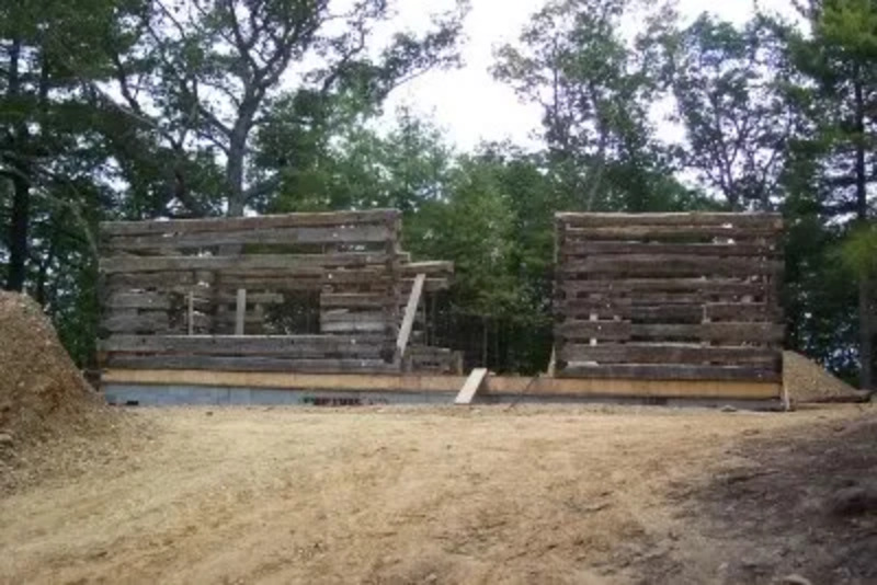

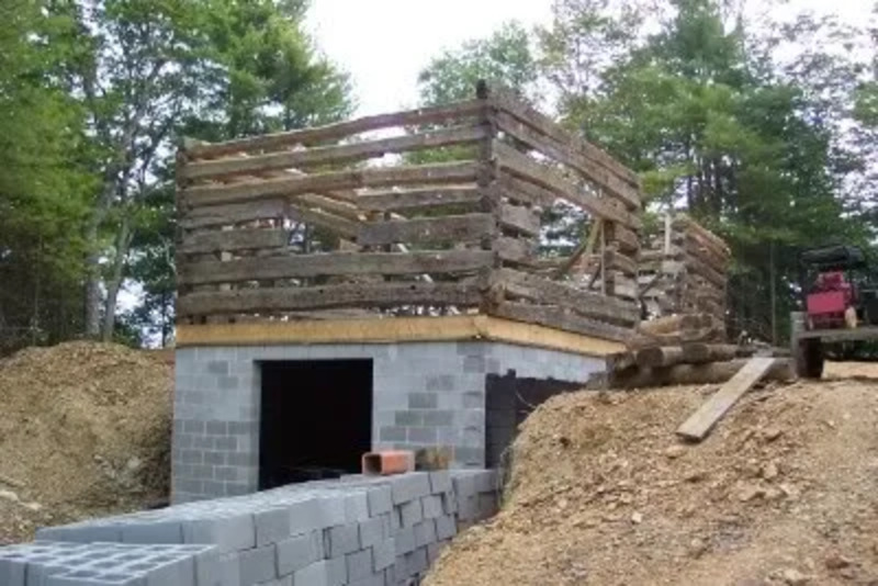

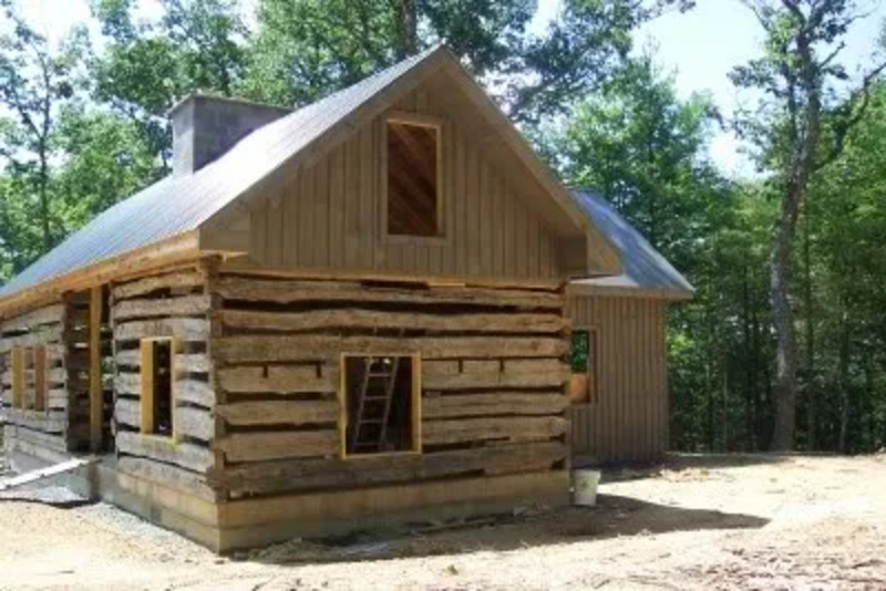

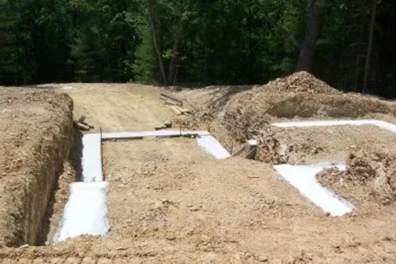

Here we go at gcrank1’s request. A short story about a home constructed partially from reclaimed old growth square logs and modern stick construction. The property is on the WV-VA state line; national forest on the VA side. The state boundary runs along the ridge so it wiggles a lot. The project was started 24 years ago and took a couple to get to be mainly complete; all the heavy duty stuff done.

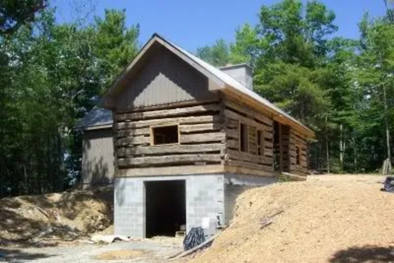

The old square face logs are from two early 1800s buildings that were derelict for decades. The structures were bought on site and dismantled. Many logs were too far gone for re-use.

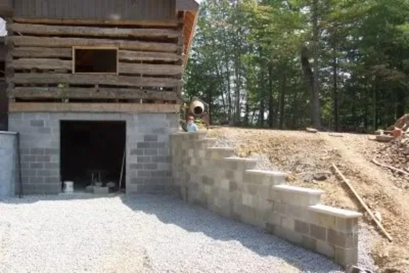

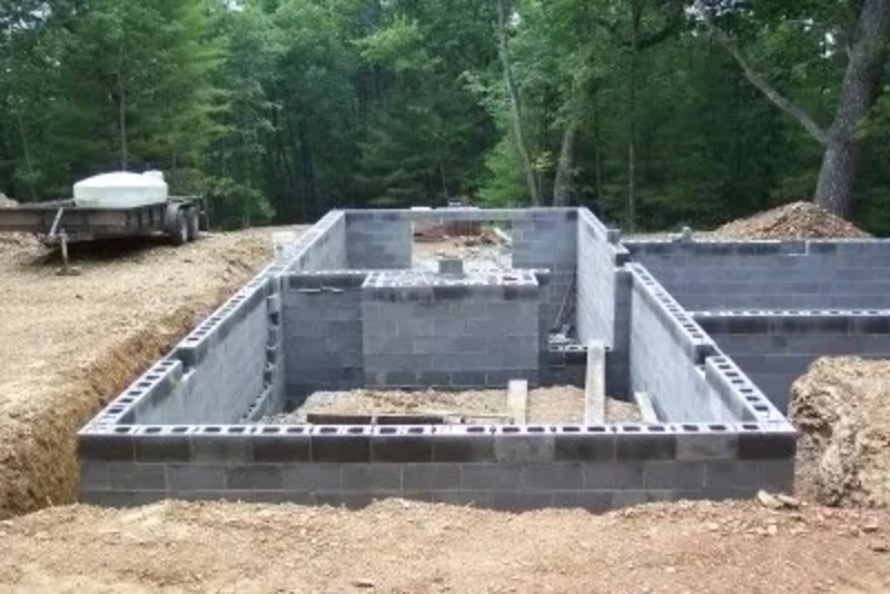

A proper concrete perimeter footing was poured and concrete block walls constructed on top. There is a walk in basement utility room plus some crawl space.

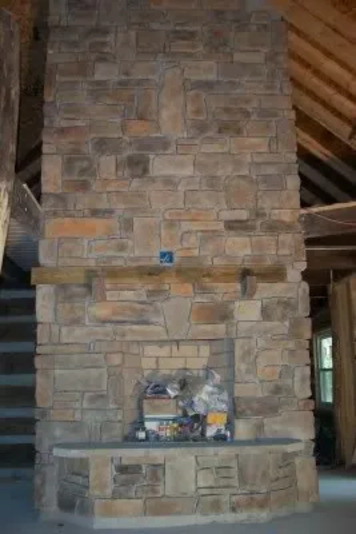

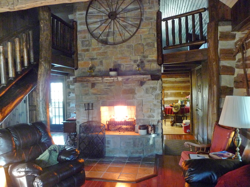

A masonry fireplace is central. The firebox is elevated a little which makes for less bending and stooping when reloading logs and cleaning ashes. There is a fresh air feed from below and an ash dump into the basement utility room.

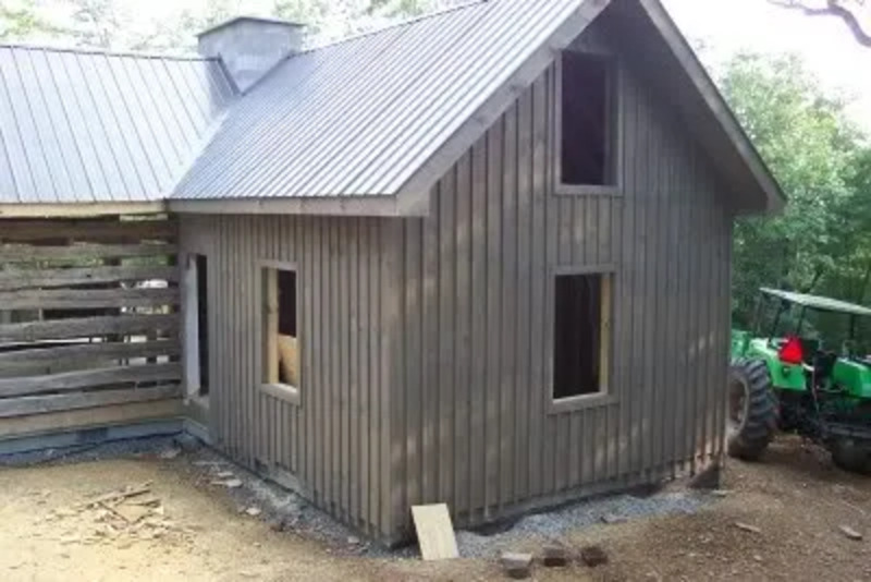

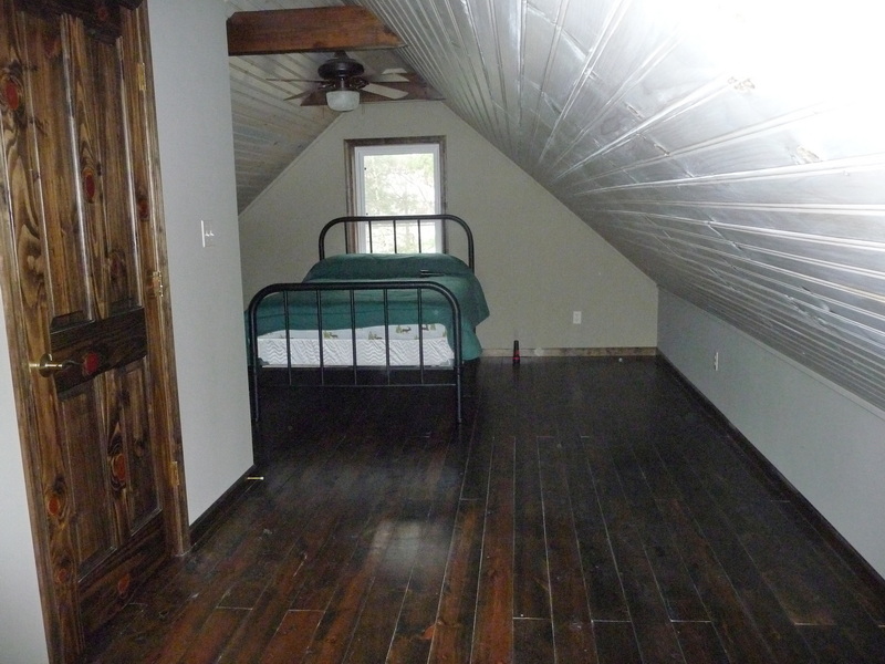

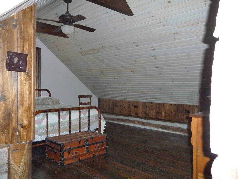

The chinking was done in two stages; an outside layer and then an inside layer with insulation between. There’s a bedroom and bathroom on the main floor in the stick framed wing. Upstairs there is a second bathroom. Upstairs is mostly open space with a bed and plenty of floor space for sleeping bagged guests. That encourages guests to come and stay the night but not for too long.

footing
footing
blockwalls
blockwalls

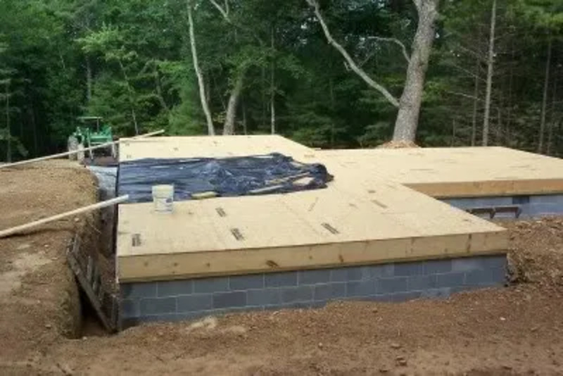

floor
floor
old logs on
old logs on

front
front

last set of construction images...
walkout
walkout
walkout 2
walkout 2

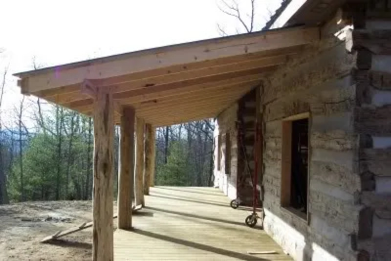

porch
porch
stone fireplace
stone fireplace

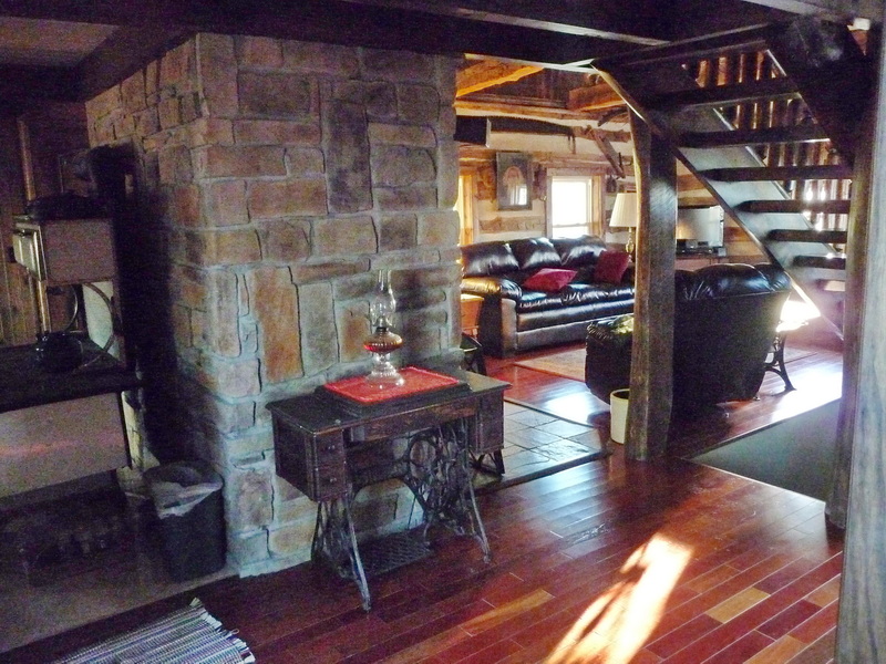

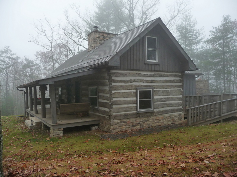

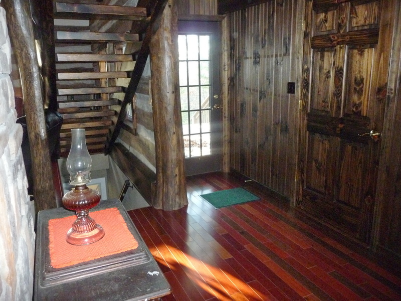

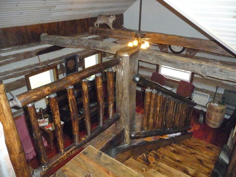

Interior and exterior "finished" images. I took these a few years ago before the rooftop solar was installed.
(I left there w/o taking current images as there were too many people still knocking about there; friends & relatives of the now-deceased owner and dear old old army buddy good friend.)
fireplace
fireplace

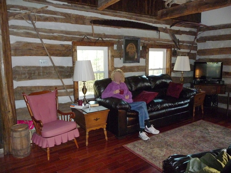

great room
great room

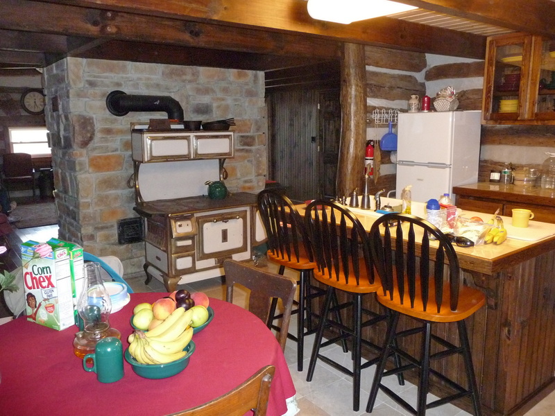

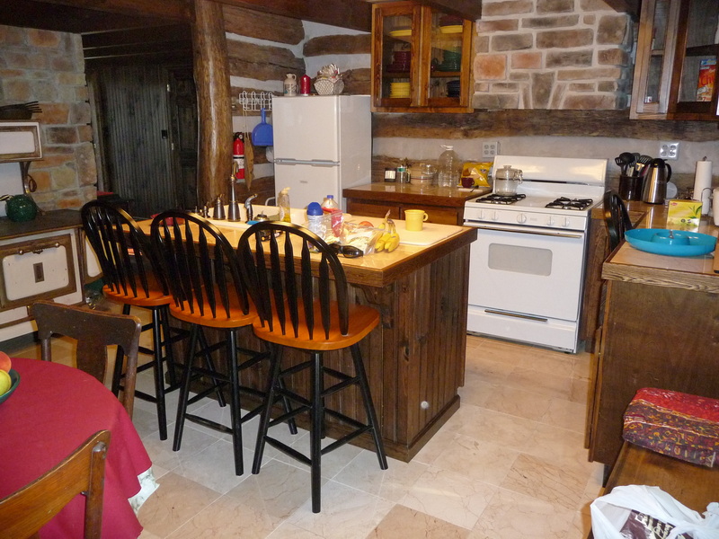

kitchen
kitchen
kitchen
kitchen
# Posted: 19 Nov 2024 08:02pm
more...
stairs
stairs
stairs2
stairs2

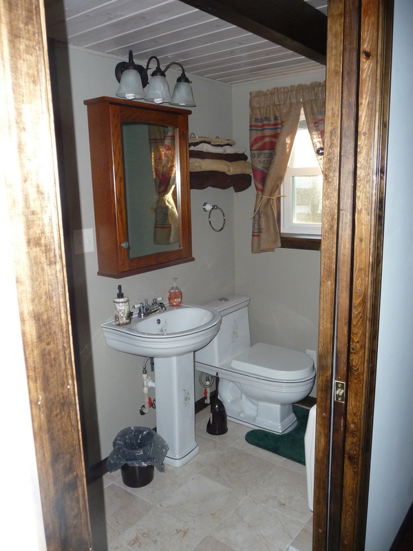

bath1
bath1
up1
up1
# Posted: 19 Nov 2024 08:04pm
more...
up2
up2
stairs up
stairs up

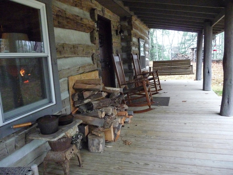

porch
porch

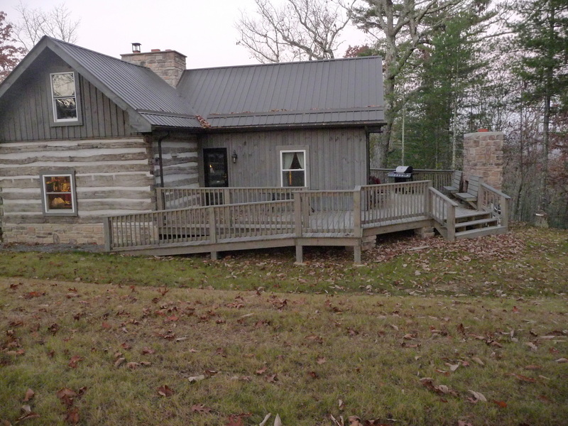

front3/4
front3/4
north
north
