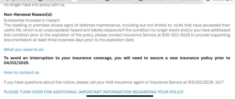

Any roofers here? I got a letter stating my homeowners insurance will not be renewed on our city house. I’ve had two roofing companies look at it, both stating it’s common now as they dig up ways to get out of the insurance business in California. I hear they are flying drones around. I do need a new roof, 70 year old original. No leaks inside, just the leaves.

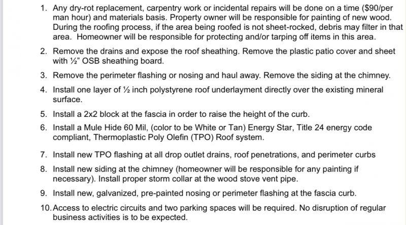

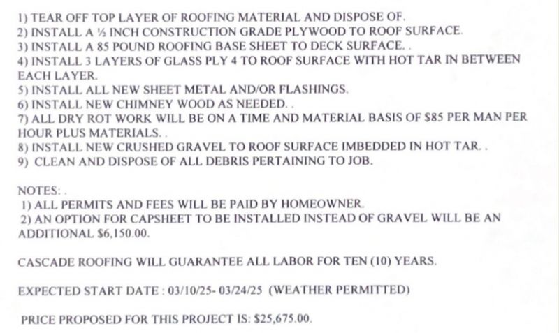

The first guy says they leave the original gravel, put a layer of thin foam over it, and then some kind of plastic(?) sheeting over that.
The second guy says they will tear the old tar and gravel off, put down thin plywood over the old fiberboard insulation underneath, and also plastic sheeting on top.
You didn't give a reason why they were not renewing. Did they say it was because of the roof? How can they tell that the roof needs replacing? Is it because of leaves on the roof? Blow the leaves off the roof. Any of your neighbors get a similar notice? Make a letter asking about it with your phone number and email and stuff all the mail boxes.

# Posted: 7 Feb 2025 04:49pm - Edited by: ICC
Unless I am missing something, I do not see a connection between needing a new roof and nonrenewable home insurance.

# Posted: 7 Feb 2025 06:10pm
Quoting: ICC
I called and they said the same, fix the roof and we’ll renew. As the roofer said though, they look for any reason.

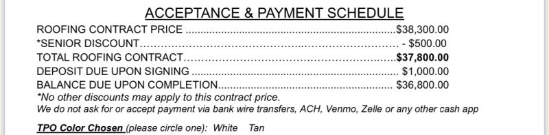

Got a quote back last night from one of the two roofing companies that came over, 36K! I expect the other will be close. The 20K my neighbor paid was 5-10 years ago.

# Posted: 9 Feb 2025 10:21am - Edited by: paulz
Roofing quote 1
# Posted: 9 Feb 2025 10:24am
Quote 2

# Posted: 9 Feb 2025 03:25pm
This is one quick read on the differences. The last asphalt roof I was around the tar babies came running into our shop looking for extinguishers, took every extinguisher we could find to put the tar kettle out. I'm guessing it burped or there was a spill. We used to use the same companies for foundation waterproofing and skin burns down in the trench were pretty common. We had to remove 3 layers of that on an old service station roof, what a heavy mess. Whoops... not that I'm biased.
I saw the first quote mentions tear off and disposal of one layer. It looks like he is covered if there is more than one layer.

Thanks DRP, was hoping you’d comment. A few things I don’t understand.
Quote 1
85 pound roofing sheet, that’s just the black roofing paper?
4 layers glass ply 4 with tar in between?
Tar and gravel, I get that!
6k option for cap sheet instead of gravel? Whats that?
Quote 2.
Just polystyrene over existing gravel, TPO over that?

You have a 70 year old roof. $38K sounds like a bunch of money for a roof. Why not toss the old technology and put R40 insulation in the attic joists and a colored metal roof? Tar sounds like a fire hazard.

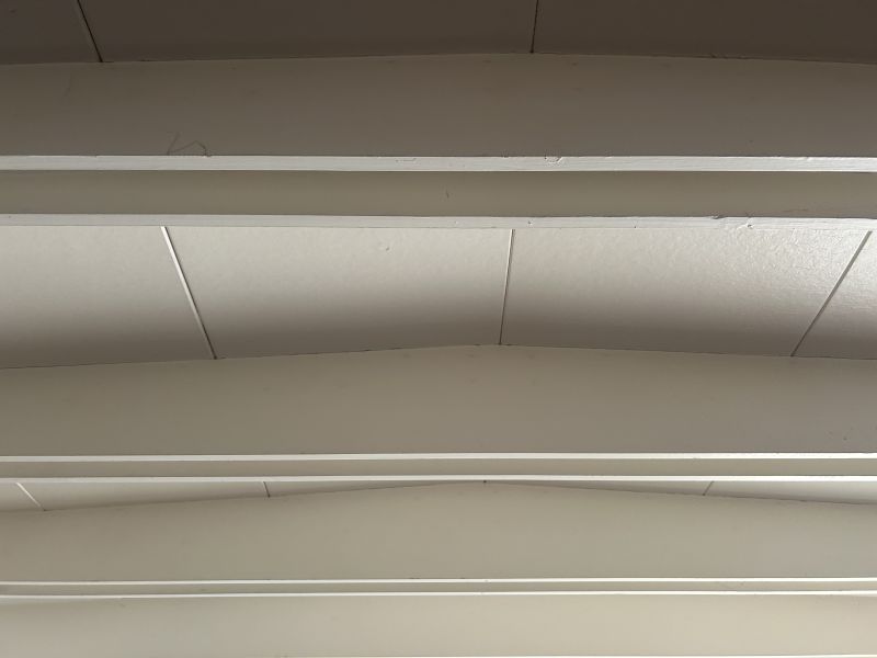

# Posted: 9 Feb 2025 05:51pm - Edited by: paulz
Sounds good, if possible. No attic joists. Here is the ceiling center from inside, shows how minimal the angle is. The panels are just that fiberboard insulation stuff, two inches thick. Right on top of that is the tar and gravel, no sheathing.

# Posted: 9 Feb 2025 09:34pm
The other options would probably require a substantial slope increase. It does get done here some, an overframe of new rafters at a steeper pitch, purlins and metal... factor the whole cost.
The 85 lb is what we called 90 lb rol roofing back when, that is the weight per "square, 100 square feet.
This is the glass ply IV
https://www.gaf.com/en-us/roofing-materials/commercial-roofing-materials/asphaltic-me mbranes/gafglas-ply-4.
I'd inquire but I think a uv stable top sheet unballasted
I believe quote 2 was stripping to a bare deck, and then building up from there. More insulation would be better of course.

# Posted: 10 Feb 2025 10:01am
I cant believe that heavy tar and gravel is sitting on just those fiberboard panels; ie, there has to be more structure up there???
# Posted: 10 Feb 2025 11:59am - Edited by: ICC
It would appear that this might be an older double wide mobile home. Many of the pre-1975 ones had tar and gravel roofs. There are lots of those around the southwest, including CA. I have seen some do a roof-over; as was mentioned, new wood rafters and rafter tie framing on top of everything with metal panels over purlins as the finish roof. Some have added several inches of rigid sheet foam insulation on the old tar and gravel as a part of the process. The additional insulation would be a good thing, IMO.
