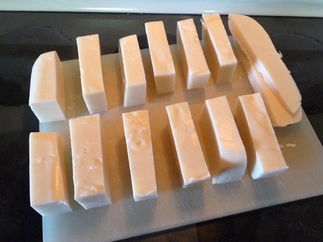

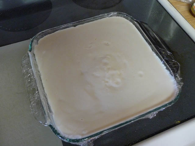

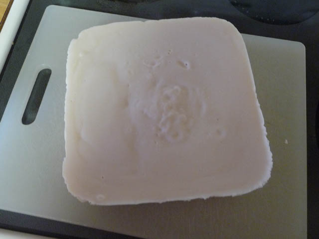

I recently made my first batch of home made soap and wondered if anyone else does?
I made a batch of all vegetable oil soap; canola, olive and coconut, water and lye. I must say that I think it turned out good.
I actually made a half batch, one half the recipe. Cold process, not too difficult at all. soap in the glass dish I used for a mold
|  soap after 24 hours; just removed from mold
|  soap cut into rough bars

Soapmaking is something I've always wanted to do. I did do it once before (many years ago) when daughter and her friend were doing a science fair project. Her soap was pretty authentic and involved rendering down fat (the smell just about drove our dog nuts). When it was done, they did a survey at their school comparing it to ivory soap. The homemake soap won, hands down.
Can you give us a detailed recipe MtnDon - Please?
# Posted: 11 Feb 2012 04:13pm
My rough cost estimate is that the half batch recipe ingredients cost about $US 12.00, or somewhat less. The half recipe made what was pictured, about 4 pounds by weight. That will decrease a bit as the soap dries and hardens.
I did not make it as an effort to save money. I decided to make soap so I could get away from the fragrances and other chemical additives found in commercial soap.
It is possible to add fragrances, which is normally done just before placing the mix into the mold. There are methods and instructions online. Attached is a pdf document relating my experience, the recipe, and notes on what I consider basic important things to know.
The process of the oil and lye combining is called saponification. Once complete the lye is all consumed if the ingredients were accurately weighed. One of the by products of saponification is glycerin. Glycerin is good. A trace amount is left on your skin. Glycerin attracts moisture from the air. That makes your skin feel softer.
Trivial factoid: Glycerin is removed i from the soap in the commercial process. It is extracted as it is more valuable by itself. The soap companies then use the glycerin in making lotions and creams for dry skin, that they sell at designer prices. The dollar drives everything.

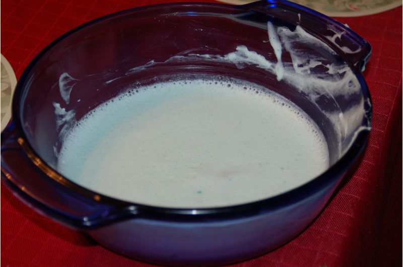

this is not as good as MtnDon's soap but i do sort of make it. i save all my left overs and soak them in water when i get a big bunch.let them get really soft and expanding in the water.then i blend it all up in the blender.then i add some oil or shortening in the sauce pan and add my mixture on medium high and stir...till sort of thick.then i pour the mixture into a greased container and let dry.here is a picture of my latest batch.i wil take a biscuit cutter and cut out round soaps n decorate them for our guest bathroom.all the left overs from cutting...i will add to blender with water and make a hand soap...
exsailor
