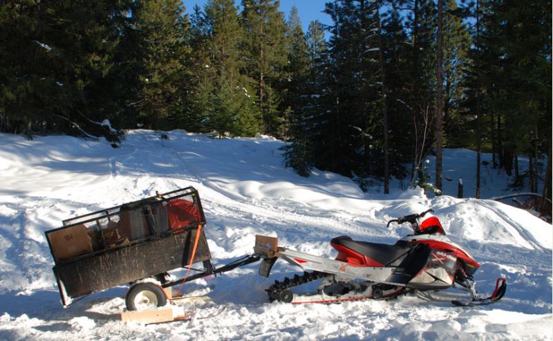

If it's going to be a utilitarian sled....
..... you can put snowboards on a garden trailer. Which is also useful the rest of the year.

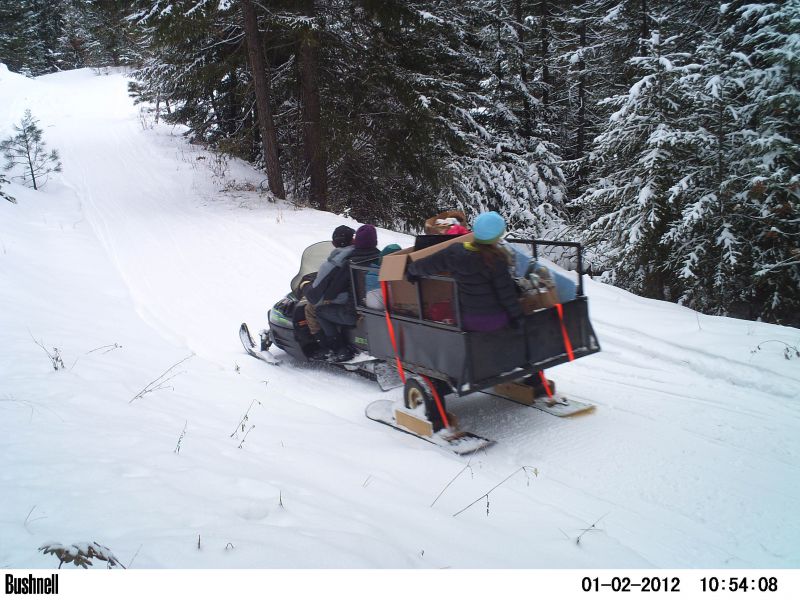

I got the snowboards at a rental shop for $10 each. Snowboards have a very usable array of threaded metal (M6x1.0 metric) holes in them. I made a wood box that the tire presses tightly into. This box is bolted to the snowboard threaded holes.
At first I had a nylon cargo hold down ratchet-strap over the tire but quit using it, found them to be completely unnecessary. You have to go slow anyway if the track is rough and since eliminating them there has been no hint that the wheels could ever jump out of the boxes. Had a little trouble with the mountain sled overheating because you can't just go roaring off into the fresh powder to cool off (with a trailer). You can of course, but if you get stuck you are really stuck. I have not tried the trailer with ice scratchers too.
In my case I often have to use a gravel road for up to a mile and it helps to be able to take the boards off and run the wheels on the gravel. Now that I discovered how easy it is to use when the runners come off/on so easy.
I'm going to add some little angle-iron keels to the boards so it can't slide sideways around the turns. I think way in the back so they can flex up if necessary.

Transporting the family.  Cargo straps over tires - now I go strapless..

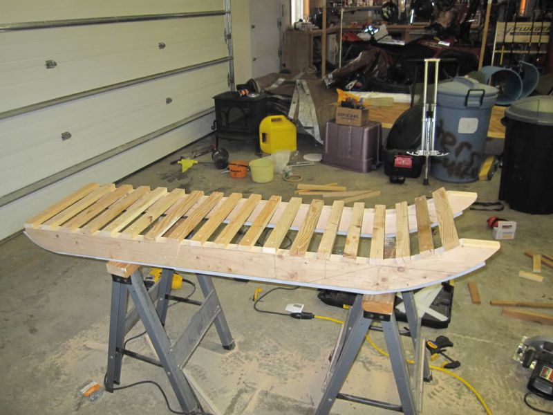

I think a dogsled style isn't the best for behind a snowmachine. If you do want to build a dogsled style, you need to steam bend the runners. White ash, oak, birch are good woods to use. You want to laminate the wood together with Titebond or something similar and add a protective oil.
I use a UHMW sled. It is very light, hauls alot, and won't crack in the cold which is extremely important up here. I haul 500-1500lbs on my 10' UHMW sled. This might be overkill for your ice hut.
These sleds are durable! This comes from Northern Sledworks website. They make great sleds but are very pricey. Buying UHMW from superslide.com is a good source.
Another popular inexpensive option is qamutik. These are excellent freight sleds without the UHMW price. While UHMW runners aren't necessary, putting them on the bottom of qamutik really helps. I don't have a picture but here's what I pull of the internet.

I have attached some more ideas for you. The Qamutiik is probably the best freight sled for the money.
I know people are also happy with the Otter sled. It cracks/breaks after -30 but warm weather folks seem happy with it.
