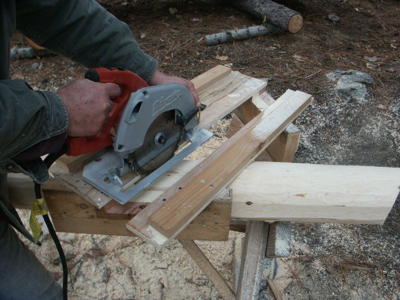

Getting the log up in the air where it is most comfortable for you to work at it is key also. I built a funky sawhorse type thing out of crisscrossed 2x4s which worked. The key is to cross brace it so it is as rigid as possible, and tie the log to it so it doesn't move as you shave.

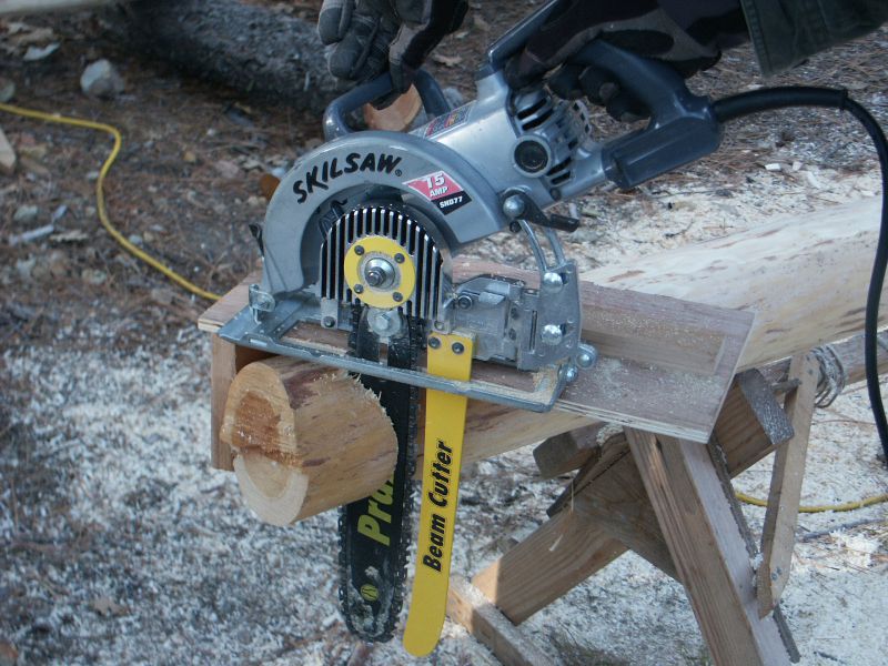

Here's the only shots I have of the horse, being used for joinery:

bldginsp, what's that saw in the second pic..?
# Posted: 27 Sep 2014 14:12 - Edited by: bldginsp
That's a Prazi beam saw. Prazi makes a bunch of jigs and add-ons for tools. This beam saw, as you can see, is just a chain saw that bolts straight onto a Skilsaw. Gives you a 12 or 13 inch depth of cut. A bit funky, inaccurate and unwieldy, and extremely dangerous if not used carefully, but not too expensive and basically effective. Their website:
http://www.praziusa.com/
