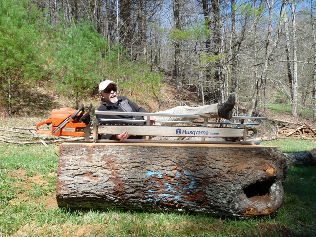

One of my logging friends knows I have a weakness for "different" trees and saves some of the interesting logs. This week he dropped off a large cherry. This one was too big for my circle mill. A friend with an Alaskan Mill came over today and we made some nice slabs. A couple of them look like they'll make nice one piece tabletops if they make it through drying intact.

Gotta say it, "Loggers Porn", flashing that Husky chain bar like that, you ought to be ashamed !
I'm sure you'll get some beautiful lumber out of that big piece. Looks like you have a few upcoming projects to do.
I have a small Alaska MK-3 Mill with the 30" kit for my Husky 576-XPAT which I am anxious to get using, unfortunately I haven't got anything that large to be cutting. Maybe that is fortunate as I'm gonna have to figure out using it first... all a part of the adventure of Cabin Life...

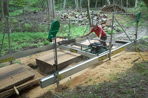

We've been having more fun in the woods. There have been a few upgrades, my buddy went up to a Lucas swing blade with a slabbing bar, worked sweet on this 4' red oak. We've gone in together on an old beater boom truck, these puppy's are heavy. I logged a homesite prior to the excavators a couple of weeks ago and got the hickories. I started with a farm tractor but bent a lift arm, with the log loader it was a 5 minute job... and a few quarts of hydraulic oil. Another winter job

ah. the spare gallon of hydraulic oil. another off grid essential.
I could use one of those slabs for a table I want to make. hmmm.

Yeah, some Exxon stock would probably be a good idea
The tree is going to be used to make a dining suite but I believe there will be extra, it'll be a few years till they dry... if you can figure out how to get one there!

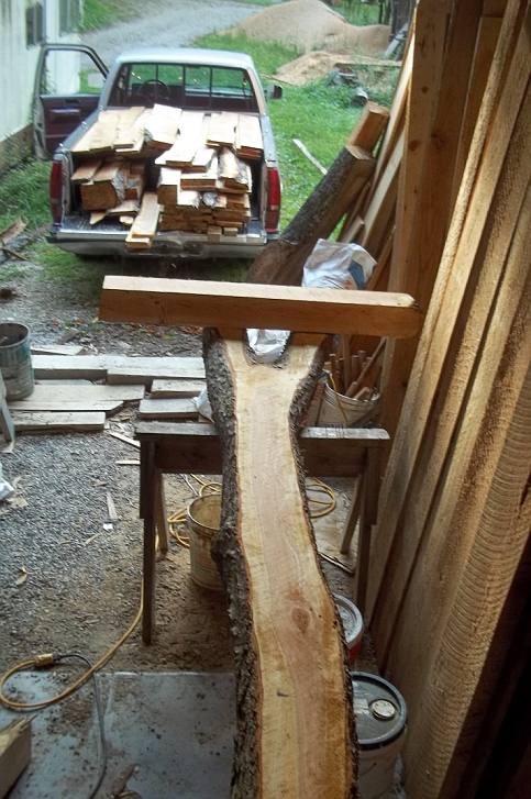

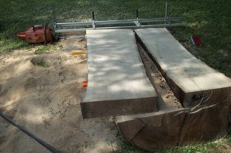

I got into some smaller cherries and a maple today. This is something I'm starting to play with. Sawing a flat natural Y braced timber. Then I'll mortise and tenon a 6x6 bolster on top. The beam can then be cut to length in the field and bolted to premade posts or it can be spliced over the bolster.

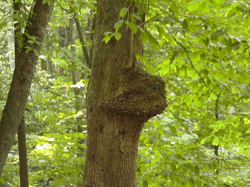

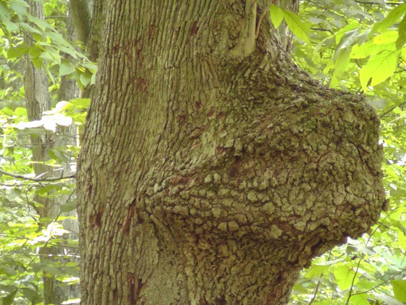

Don_P like your mill. What would you do with this burl? I'm in VA also. Burl is in WV.

They are a mixed bag, sometimes it has awesome grain inside and more often it is a rotten hole. For something like that I'd get one of the local woodturners to take a look. I've turned nicely figured small boards into 1/2" thick rounded edge cutting boards/cheese boards, sandwich servers... whatever. I use a beesway finish. It's fun watching people react to a really neat piece of wood.

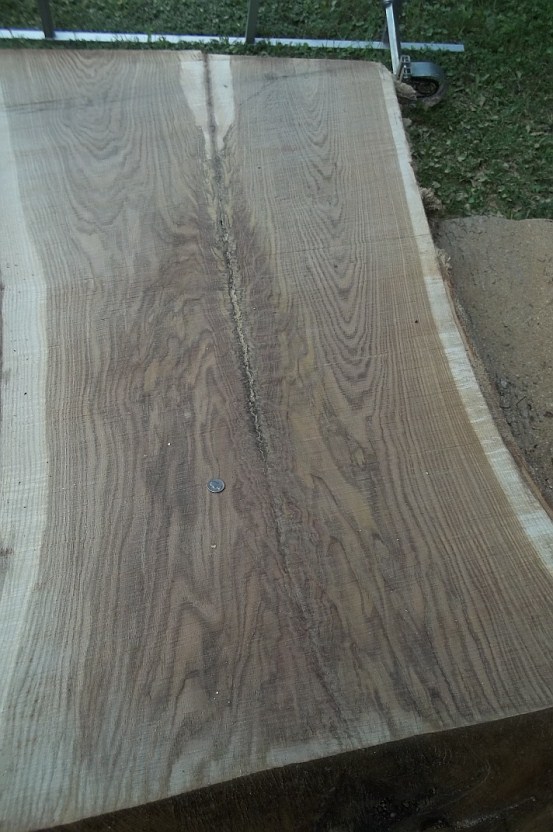

Today was one of those mixed bags. This was a double white oak, the slab here is 36-42" wide x 6' long and I was hoping for nicely knitted together flame grain. The included bark that is mostly down the intersection of the two halves means this is really 2 boards, I might joint the two halves and butterfly them back together. Still very nice grain.
# Posted: 23 Aug 2015 05:49pm
i don't know I've ever seen a board quite that dark. maybe it's the picture. but nice board. how thick did you cut the slab?
I like that center line. really talks about the life of the tree.
suppose. you could router out the line and fit it with a ebony inlay or sum'at. that would look good. i have a nice piece of purple heart I bought for a project I never got to use. swap ya for one of them cherry slabs.

We got 3 nice 4-3/4" thick slabs out of it... we actually talked about setting up at 3" but somehow cut the first one heavy and I liked it so we just kept running at that thickness. The next purchase will be a planing head that goes on the swing blade mill, it works sort of like an 8" dia end mill, clamp the slab down and work it all over the surface.
I've been debating cutting out the pith, jointing the crack back together and using butterfly keys to hold it. Or, epoxy the joint and run threaded rods through the whole thing. This will probably end up with the cabinetmaker/furnituremaker on that job once it's dry. White oak has been described as drying at the same pace that glaciers flow.*
Within minutes the surface had dried and the wood was more like what you normally see in the way of white oak. That does show pretty close to what an oil finish would look like though. Opening each log is kind of like digging for treasure.
Oh my, oh my.
gonna save my money for a mill
wunnerful, simply wunnerful

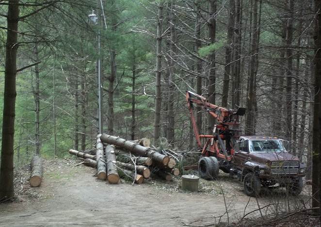

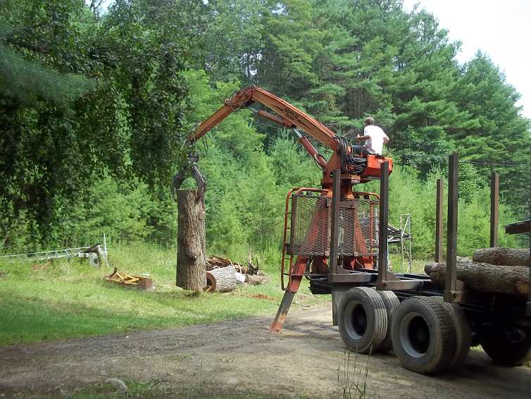

The power company did some line clearing recently. They first came in with a helicopter and limbed the pines then sent in a ground crew to clean up everything under the line. Having been through this before, the chopper trimmed trees die and then fall into the line, I asked them to drop those trees and I'd get them out. I had gotten a dozen or so logs out with the pickup, snatch block and cable but the rest needed to come straight up the hill. I've gotten about a dozen logs to the mill, this pile is about a dozen more and there are about a dozen still over the edge... pretty nice haul. We'll probably make siding for a friend's shop, he owns the leaky half of the knuckleboom
The trees are eastern white pine, a wood I really like but it has structural "challenges" notice how they grow about 3' send out a spray of branches then go up 3' and do it again. There is a knot cluster every 3' structurally. Trees like this are best for non structural. As they get larger and more deep woods grown there are usually smaller branches down low and better beam timber.

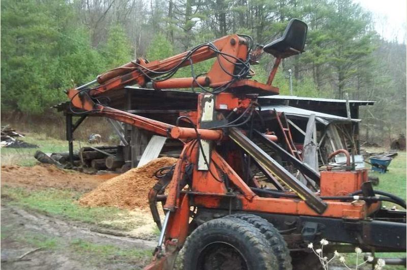

Bizarre looking rig you've got there Don. What is that- a modified backhoe to make a log pulling crane? Got a closeup photo of it?

LOL, it started life as a F600 dump truck but was chopped and shortened, then the Prentice knuckle boom was added, a fairly typical older ~70's-80's FOBC (freaking outside behind cab) style log loader. From the office chair up top you have, a great view, a left/right swing footpedal then 4 levers in front of you, grapple (opens and closes the jaws), main boom up and down, jib boom up and down, and grapple rotate. Under the seat are 2 more levers for the outriggers. Not the lowest cg vehicle I've ever owned. The high range switch is out of the rear but I see no need to replace it, just short hops around the neighborhood on the back roads.
ah, found a closeup, this is basically in travel position, the grapple is hooked into a heavy crossmember and the boom is down. The cylinders sticking out the sides drive a rack that spins the turret. The hydraulic tank is midship and it uses the old dump's ~25 gpm pto pump.

This is a larger self loading truck. The valves are more modern joystick controls. The turret and grapple have continuous rotation, they can spin all the way around, and the truck has about 6 more gears, very nice.
I'm setting up a stumpkin in that pic. A large hollow log, carve a jack-o-lantern in the log, fill with kindling and have a party

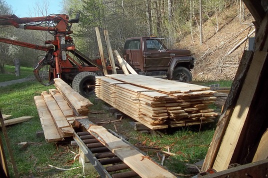

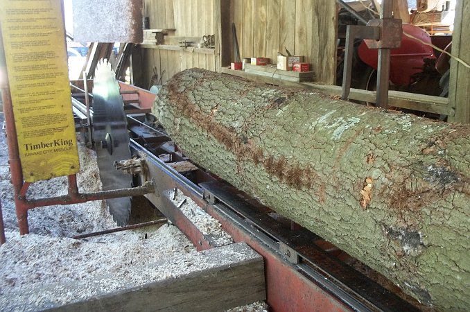

I moved logs and started sawing over the weekend, stayed home and kept at it today. The first pic is of my mill, realized I hadn't put a pic of it in this thread.
The next is the wood that's coming off, mainly trying to get 1z12's for barn siding but the bycatch is going into 1x8 for a temporary porch floor at work.

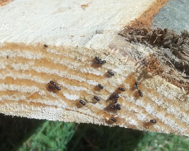

3rd pic is the reason I kept sawing, black turpentine beetle party. They've hatched out, smelled the sap and invited all their beetle buds over.

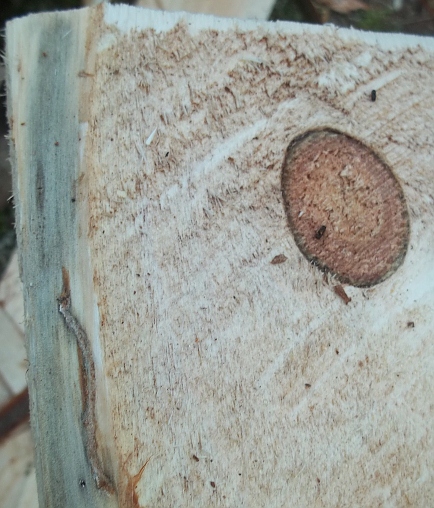

Last shot is what happens. The btb's tunnel under the bark and run along the cambium layer getting the highest energy food. Their larvae go on in. As they tunnel in they pick up spores of bluestain fungi and carry them in to the wet sugar rich sapwood... sapstain is the other name for this fungi. It then runs through the cells consuming sugar. Anyway everyone is in this shot, the food, the beetle, the fungi.
If I can debark the wood the beetle doesn't do damage, when it is sawn and on stickers as soon as the moisture content drops below about 25% the bluestain can't grow. Right now with all the company and temps hitting the high 70's, it is set up to explode in the log pile.

Don , nice set up you have there. What are you cutting, looks like pine from here. I agree that you have to get your white woods , sawed before the bug and the stain starts. I like to cut my hard maple frozen or early .Then right in the kiln, this pretty much eliminates sticker stain. Have you tried misting your logs, with diesel fuel , in a garden sprayer, also the bottom seems to be where bugs hang out. Pine and spruce seem to be the worst. Our hemlock seems to be a bit more resistant. have fun with your project.
