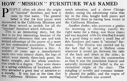

I was browsing old issues of Gustav Stickley's magazine "The Craftsman" from 1909 and came across this short article in the attached pic.

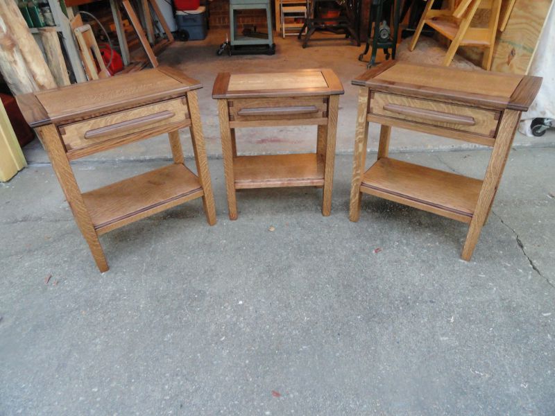

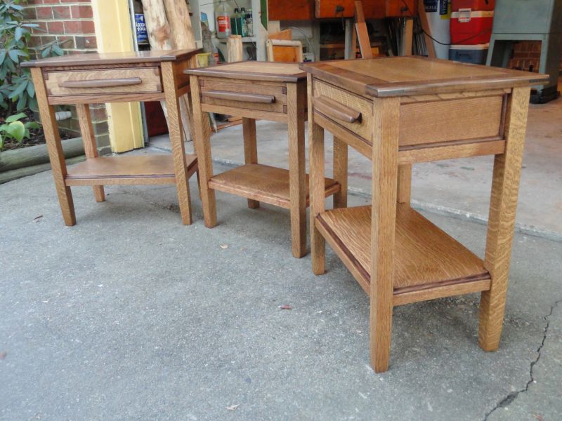

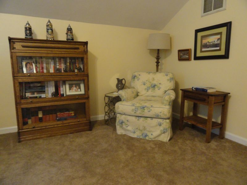

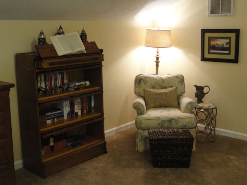

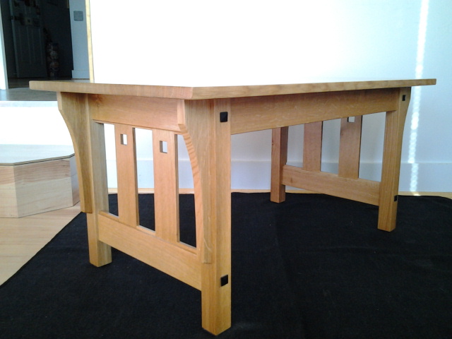

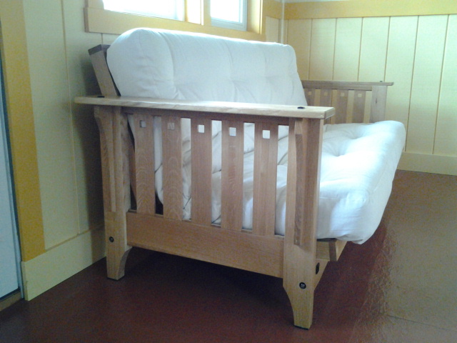

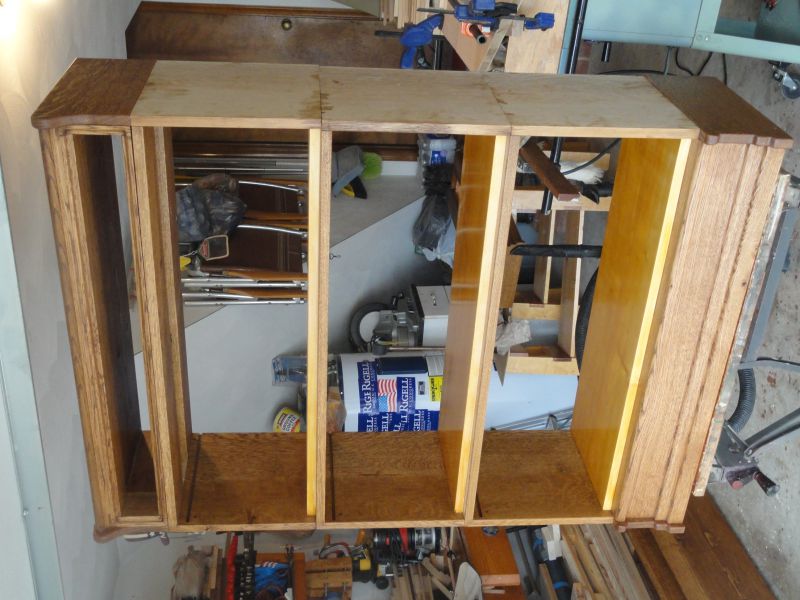

It's nice to see others on this forum who appreciate great furniture, and make it, too! Here are a few photos of side/night tables I made in the style of Charles and Henry Greene's Blacker House Side Table (they were contemporaries of Gustav Stickley) and my design of a barrister bookcase, all pieces made from quartersawn white oak with black walnut accents. The bookcase shelves are maple with amber shellac finish. All the oak and walnut are finished in dark walnut Danish oil and waxed.

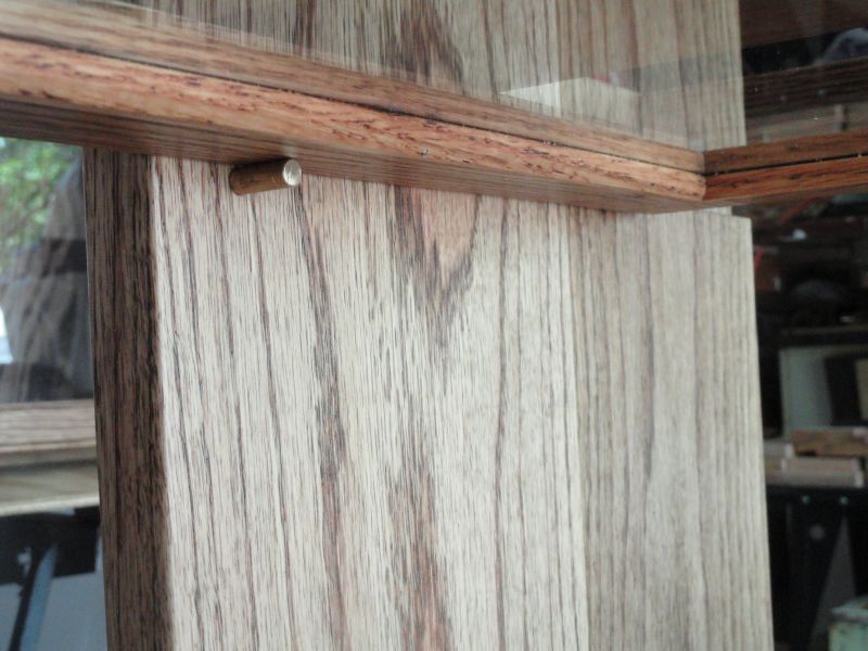

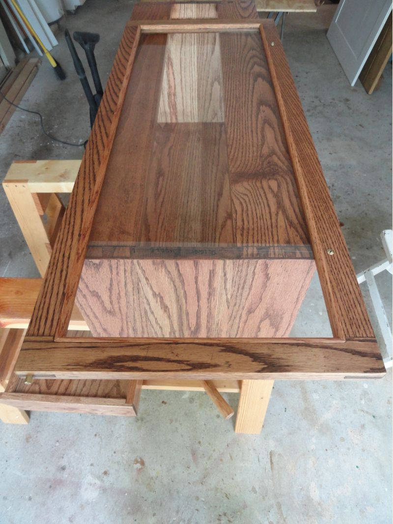

I've mocked up a pine section for a barristers bookcase but couldn't come up with a good way to do the doors... what did you do?

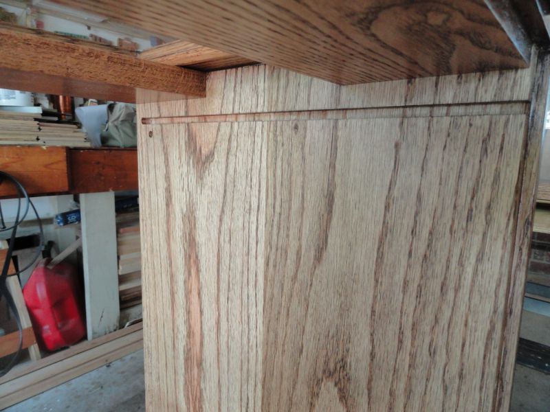

Don, I use one short (about 1") length of 1/4" diameter brass rod stock (obtained from Graingers) inserted in the each stile about 1" down from the top of each door, that slides in a groove slightly wider than 1/4" as one pulls the bottom of the door out, then up and in. The door then rests on brass rod pivots, that are located about 3/16" behind the door (when it is closed) to the center point of the 1/4" rod and about 1/16" plus half the width of the door frame under the groove. The photographs should help. The first photo shows quartersawn white oak, except for the maple shelves. The remaining three is plain sawed red oak (my first attempt at this project using much cheaper lumber). Each shelf section, the top section, and the base section are easily separated and are held in position with a lock board attached to the bottom of each shelf box and bottom of the top section that fits into a slot in the top surface of the base section and top surface of the three shelf sections. For the three shelf sections the four sides are joined using half-blind hand-cut dovetails (I build these to last a very long time). The dovetails cannot be seen when the bookcase is assembled, but they are there nevertheless providing strength and rigidity to the entire assembly. Hope this helps. Adak

Thanks Adak, That's what I did in my mockup, it's quick and dirty so used dowels. One thing I learned on that was that sloppily I put the dowel on the door a little off center and the door, centering itself, didn't hang straight. I think in the final I'll probably off center the other way and let it rest closed with a little pressure. They'll be beech, I was in the beeches and glued up the panels awhile ago, another winter project.

Don, will you be making it in sections or one complete assembly? I'd be interested to see what it looks like with beech once you are done. Yes, the grooves and holes for the dowels / pins need to be precisely located.

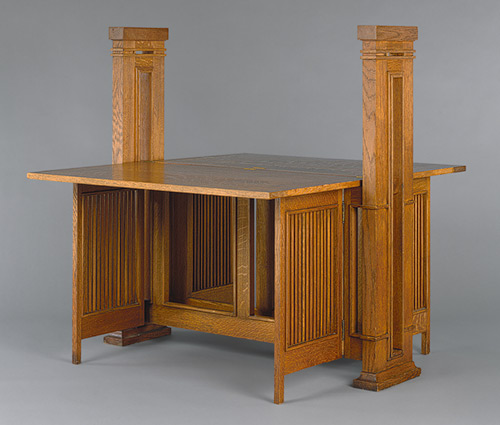

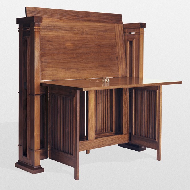

One table I've always wanted to have was a Frank Lloyd Wright "Print Table". It was designed for one of his clients around the 1900's. It was featured on an episode of "This Old House" and it's interesting because the lattice leg panels swing out from the main body of the table to support the top, but when they are folded up against the vertical uprights the top folds up like a butterflies wings and slides down inside the central cavity. It could also be used half open to show off artwork. I've never seen a table where the top folded up and was stored that way.
By his own admission, Frank Lloyd Wright said that most of his furniture left him covered in bruises whenever he used it, but I thought this table was quite unusual and very beautiful.

Table open
Table open
Half open
Half open
Side view
Side view

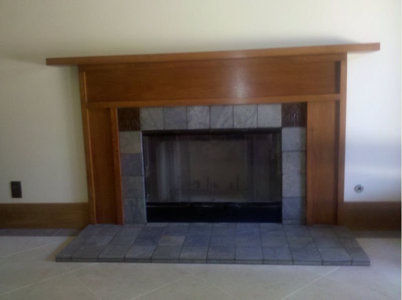

Here's a fireplace surround/mantel I did, not with 1/4 sawn, but a similar style, all locked together like a puzzle...

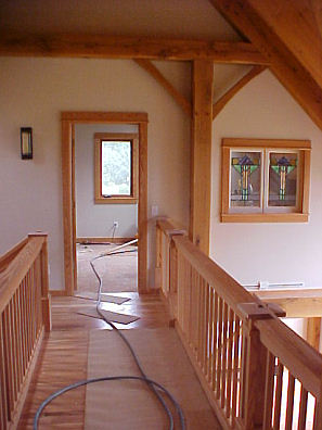

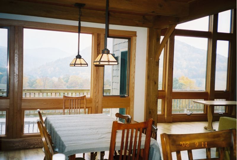

Attached are some pics inside a craftsman-ish timberframe that was fun.

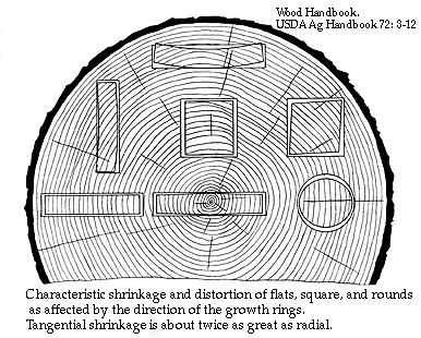

We've talked about quartersawn lumber... the first pic below shows the difference between a quartersawn board, and where it comes from, from a flatsawn board. If you think about how the blade is slicing across the concentric growth rings it'll become clear why the boards look, and act, differently. White oak has very striking rays that are visible when quartersawn.
One problem when trying to show just quartersawn grain is what to do with something like a table leg, if truly quartersawn then 2 opposite faces will show rays, and the other opposite faces will be flatsawn. In the second pic look at the square in the center. Then look at about 2 o'clock. This is rift sawn, the grain on all faces is uniforlmly around 45 degrees to the face. Those parts have moderate ray flecking and the basic grain of quartersawn and no face looks flatsawn

Rockies, the Frank Lloyd Wright folding table is very interesting. I might modify that design to make a drafting table for my shop. Like Don indicated, shop space is at a premium and that folding table looks a good solution to save space.
