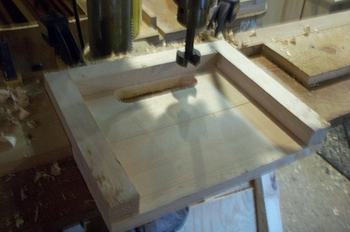

I was trying to clean up some shorts and scraps of white pine in the shop and this seems to be a good use. They hold a dozen quart jars. From the brands we had it looked like anything could fit in an interior area of 11-1/4" wide x 15" long.
In the first pic is an end panel being drilled for the handle. The panel is 11-1/4" wide x 9-1/4" tall. The "frame" is 1"x1-1/4" material, the panel is 3/4" material, I used 1-1/2" staples and glue throughout.

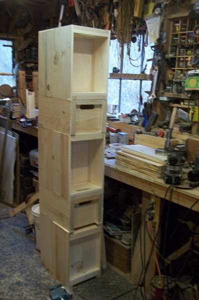

Second pic is what they look like. The sides are 1/2" material 18-1/2" long, I cut that a little long and belt sand flush. The sides are 9-1/4" tall. The bottoms are two pieces of the 1x1-1/4" stock cut to 11-1/4" with 15"long x 1/2" thick boards on top. Everything was rounded over with a 1/4" radius bit and sanded after assembly, oh except the inside of the handle slot is routed and sanded prior to assembly. Anyway, a better way to move them around and store jars than the original cardboard boxes. boxhandle.jpg

Beautiful work!!! We burned all the cardboard boxes our canning jars came in because they went moldy in our cold cellar. We just use plastic bins now but your boxes are really beautiful!! I love that they have handle slots!

That box stack looks like a nice little pantry! Open shelves for canned goods, bins for root veggies, pastas, etc. Can I place an order?
# Posted: 10 Dec 2015 05:50am
Julie, that is what I was thinking when I first saw them... As I am going to have to build my kitchen this winter, I was looking at those and thinking to myself .... Hmmmm Pot & Pan Drawers, smaller ones for cutlery etc, then I pondered Potato Box, Onion Box...
