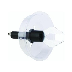

pizzadude
# Posted: 1 Feb 2016 06:43pm
Yep needle nose are the way to go https://youtu.be/06MCHN6Q6zU
Can also get one of those light bulb base extracting tools

Julie2Oregon
# Posted: 3 Feb 2016 06:01pm
bobrok Good tip! Thanks!
I'm still working on this. I may have to get that removal tool. Admittedly, I'm really a big scaredy cat when it comes to electrical things and metal, even if the breakers are turned off.
