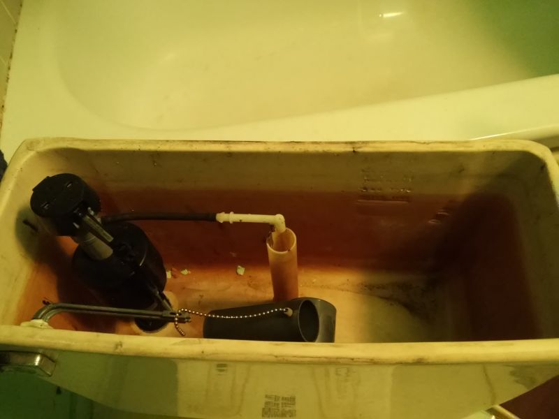

Yes I'm sure that didn't help...but, this photo shows the brown staining inside the tank, the other is not. Also, I have scrubbed the entire bowl area with Comet yet the area from the ring at the water line down to the stained area around the output hole stays white.
The staining in the tank indicates rusty pipes no? But the sink and tub right next to it are fine.
I suppose I should change it out but toilets are like spouses, you find one you're comfortable with and it's hard to let go. Plus if it's the pipes that won't help.
# Posted: 5 Mar 2017 11:22am
Yeah, that's a rusty bit of pipe or fitting somewhere if the sink & tub in same room aren't affected then you have to trace the line that feeds this one toilet. Hopefully you have access to the lines. Once that's found & replaced, maybe dump some CLR type stuff in the tank when it's full and let that remove the iron staining which should effectively stop it from re-staining the bowl.
Well, maybe not CLR but something that will remove that stain in there... Vinegar may be a good 1st try and let it sit overnight in the tank.

Not so sure about the plumbing theory. Our older toilet does this and the newer one does not. Same plumbing throughout the house. I think the porcelain is old, scratched, worn etc. Although that doesn't explain the tank...unless you're cleaning the inside ;)

if you want to verify if it is Rust and coming from Steel/Iron it's too simple. Pop a reasonable sized magnet in the bottom of the tank and leave it there for a week or two and take it out. IF it is indeed rust, there will be a coating all over the magnet. Just affix the magnet so it does not get sucked down into the toilet plumbing. It may not be iron/rust but likely is.

I was looking inside the tank today hoping to find a piece of iron I accidentally dropped in there or some such. The only thing I noticed is the two screws that hold the tank on are brass and they are corroding. There is some green on them and some black flakes coming off. Don't see how that would cause rust though. They are probably brass on all toilets.
