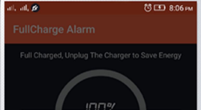

I have a couple of tablets and phones that stay plugged into their charges, which are plugged into my 12vdc battery. We stream videos on them too. Is it OK to leave them plugged in constantly or better to unplug when at 100%? My phone always says "unplug to save energy" when it hits 100.

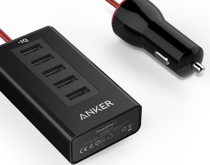

Steve, I'm not using the AC wall chargers, just straight 12vdc USB charger. I only mentioned them as the possible source of the unplug to save energy message. I suppose my Anker charger uses some juice too.
# Posted: 1 Oct 2017 07:45am
Ahh, well that is likely more efficient than a collection of Wall Wart Power Vampires... Likely if you unplug devices that are charged, the draw would be quite minimal.
