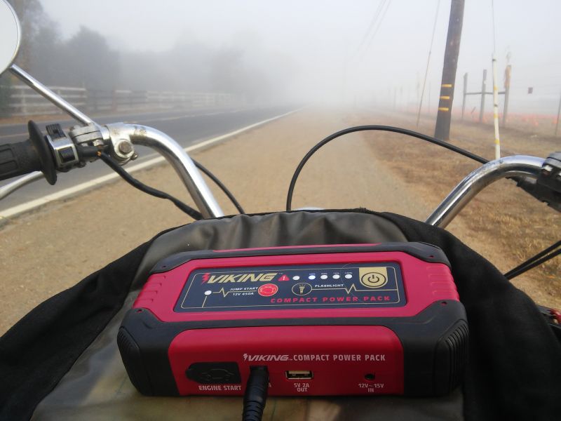

Well my new battery pack is all charged up, and of course a heat wave is rolling in. Hopefully a test next weekend.
# Posted: 28 Oct 2017 10:30pm
Cold and foggy at the coast this morning, good test for the new power pack. Did a good job of heating my vest. When I got to my destination the 25% remaining light was lit but it was still heating.
