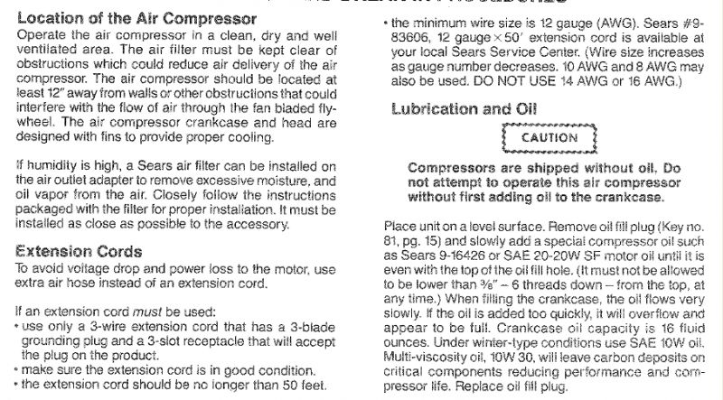

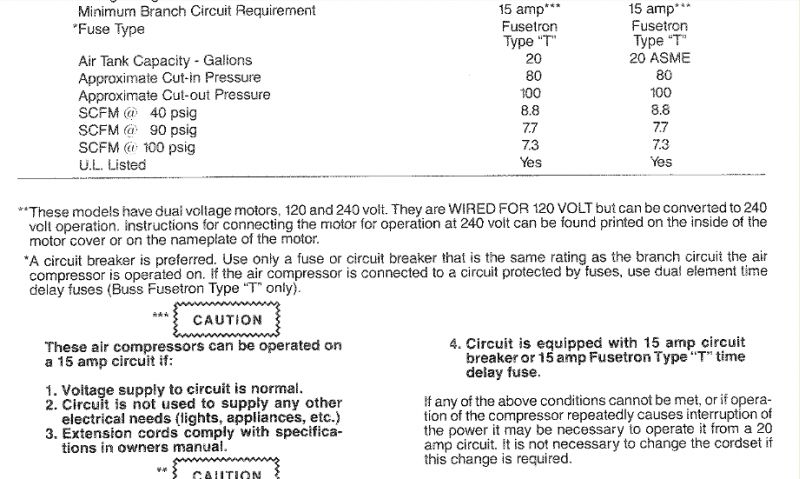

According to a manual for 3hp 20 gallon craftsman air compressor it says can be operated on a 15 amp circuit if...see attached
And also says...Minimum extension cord wire gauge 12ga

If it can be run on 15A it's not 3HP... but manufacturers notoriously exaggerate HP claims, there was even a class action lawsuit over this.
Given that the manual says 15A and a 12GA cord you should be fine, unless there's something wrong with the motor that's making it draw more current.
