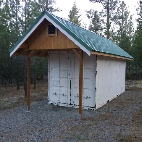

Well, I'm here to tell you, a container makes for super secure storage and can be made to look real nice if you add a roof on ie, keeps it cool and makes it look nice.
The guy who hauled mine used 3 large pipes as rollers, a high lift jack and a flatbed trailer with a winch on it. He set it right where i wanted it. He was limited to 20 footers.
I would not advise anyone to make a shipping container home as the cost ends up really high (no savings over std construction) but what I would be cool is 2 20 footers side by side, then build a cabin on top with a covered perimeter porch, Access to the inside of the storage containers via a stair case. You have a garage for snowmobiles and no bears inside cabin. A staircase access form outside can be hinged up. One could even circle them to form a courtyard. Great set up for life in Alaska.
Here is my container storage unit.

toyota_mdt_tech, good lookin' roof, man. Thanks for sharing the photo.

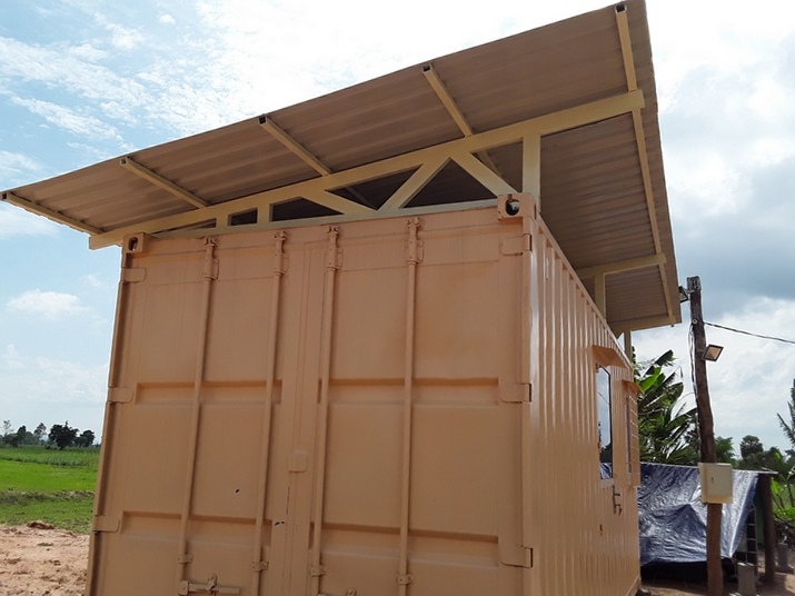

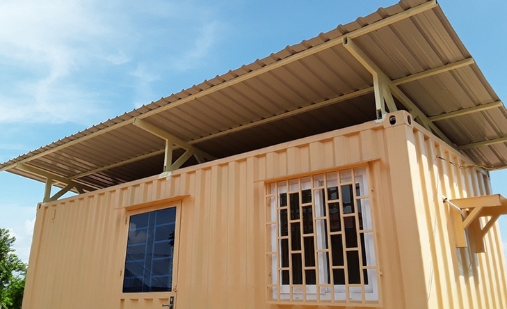

I had a 20 foot sea container insulated and shipped to our property, 7 hours from the capital of Cambodia. Total shipping cost was only $175 US.
After it arrived here, we added a metal roof to serve a dual purpose. One was to keep the noise of the rain down. The other was to use it as a rain catchment surface. So far, so good.
Here is the break down, in Cambodian rates, to have the roof completed (May 2017):
7 each - sheets roofing steel (corrugated), snow white color. 3.5 meters long x 1.10 meters wide. $12.95 each, $90.65 total
6 each - 40 mm x 40 mm x 1.50 cm x 6 m long, $7.695 each, $46.17 total
5 each - 40 mm x 80 mm x 1.50 cm x 6 m long, $12.433 each, $62.17 total
1 bag - mounting screws with rubber washers, $3.50 total
Transportation from ISI, Road 5 to the farm, $15.00 total (~ 30 kilometers)
Sub-Total: $217.49
Additional Costs:
Welding total cost was $70.00 USD, for supports and to mount roof framing. (Welding & installation of trusses was completed on May 19th, 2017.)
A 4 liters pail of paint was $10.00 USD, plus $12.00 labor to put three coats on the steel.
Grand Total: $309.49
Container 1
Container 1
Container 2
Container 2

ILFE, cost are much lower in Cambodia. I have total in my, includes, cost, moving to site, prep and adding roof, about $5500 USD
I'm headed over there tomorrow to paint it all to match my cabin in "Forest Service Brown"
I will have pictures of finished unit. Getting it while temps are still good. That window will close up pretty quickly.

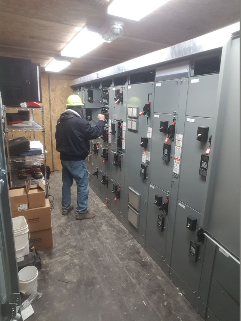

We built a huge addition to my plant, and we put some of the MCC (Motor Control Centers) in shipping containers. For reasons unknown to me, they are called Con-ex containers around here.
Other than welding in a couple man doors, they have not had much done to them. Pretty cheap solution to having buildings constructed. I think they are insulated. They got particle board interior walls, so I imagined there is something behind the particle board, but I don't know what... I do know that a 220v window air conditioner keeps them cool enough in summer.
This is what one looks like in the inside.
