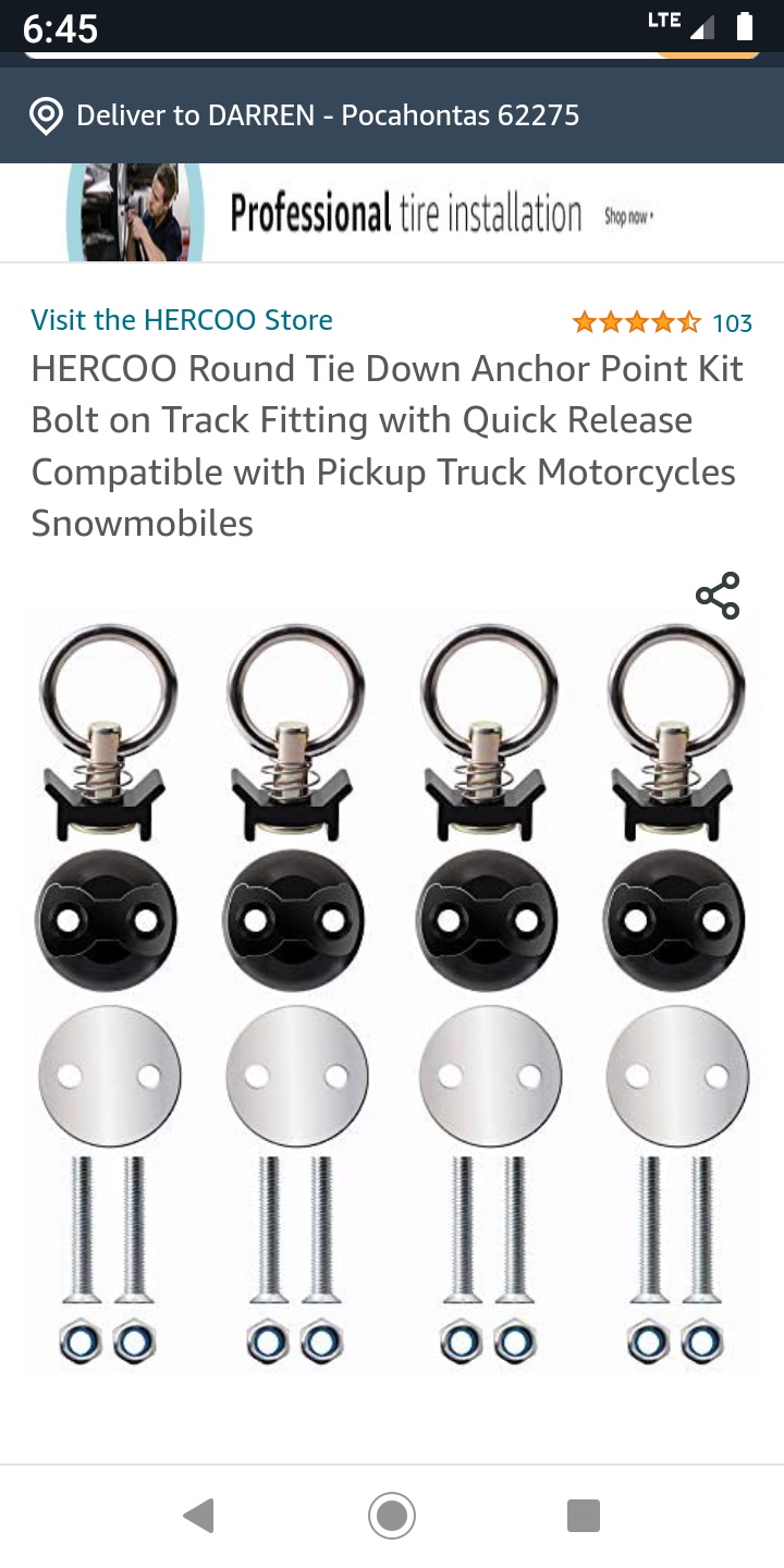

# Posted: 28 Mar 2022 07:51pm
I have these on the walls and a couple places on the floor of my enclosed trailer. Also have used them on one of my utility trailers. You just pop out the tie down rings when not needed.
They work pretty good.
Ring tie down
Ring tie down
