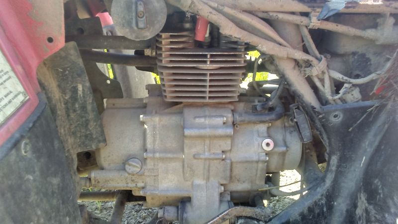

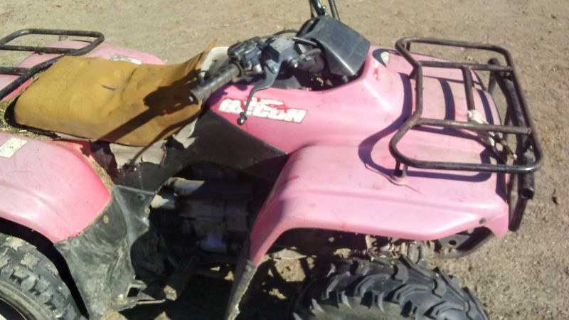

# Posted: 6 Feb 2020 04:44pm - Edited by: paulz
Went by today but too beat from two long days at my cabin to work on it. Did take pictures and spoke to the lady that runs the horse ranch. I was figuring Recon was a Harbor Freight brand until I noticed a Honda sticker in back. No idea what year or size. And she reiterated that the red and green dash lights always worked, they don't now. But it turns over with the starter and has spark..weird. Gotta be connected somehow.
# Posted: 6 Feb 2020 04:58pm
That is a very old Honda Recon 250. Clean the carburetor jets and float bowl. Look for warn out carb parts. Find the VIN on the front somewhere so we can know the year. A new carb may be cheap.

I'm with Dave, grank runnign for to aft, 250.
