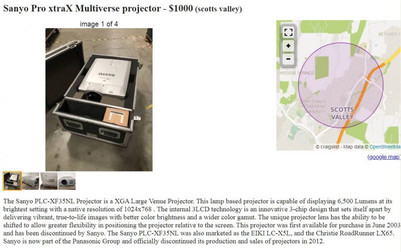

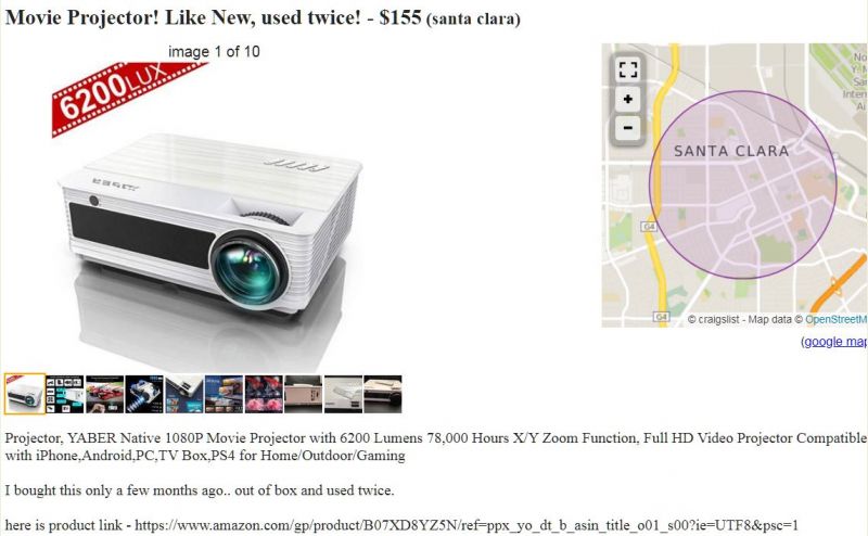

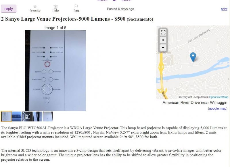

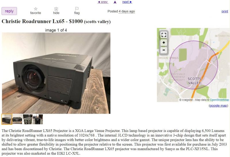

# Posted: 4 Apr 2020 10:11am
Had another look at local ads, here are 3 high lumen projectors for sale. Why is one only $155?
Please have a look
jhp
# Posted: 4 Apr 2020 01:53pm - Edited by: jhp
The one that is $155 brand new on Amazon is like $250. 6800 lumens is probably a stretch, maybe it will actually output half of that if you're lucky? Like a lot of cheap electronics its sort of you get what you pay for. It might work for you, it might not. The Panasonic you emailed that guy about almost certainly will perform as advertised.
The other two, those were built to do what you're trying to do - project across a very large space like a church. They're probably 10+ years old and are probably due for bulb replacement. They might be worth that much to the right buyer but I think you can do better for less money. An equivalent projector now would probably be in the $5k+ range. They are meant to be high performance at a long service life.

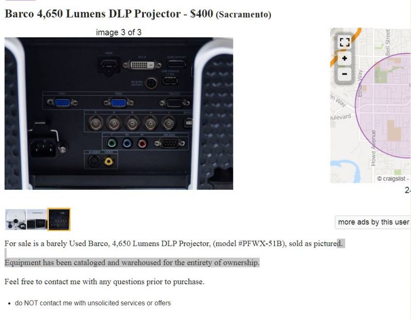

# Posted: 4 Apr 2020 06:10pm
Thanks jhp, I really do appreciate it. No reply yet on the Panasonic. Here's a couple more I could drive to get. Not really any rush, a month or two from nice evening weather, but if a good deal comes along I might as well jump now.
Saw one with 15K lumens, but $5K. You could do a full fledged drive in movie theater with that I guess!

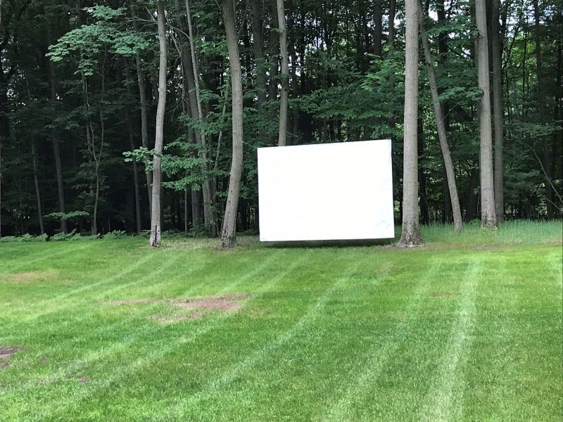

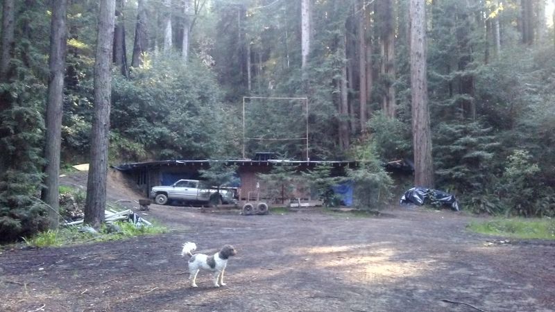

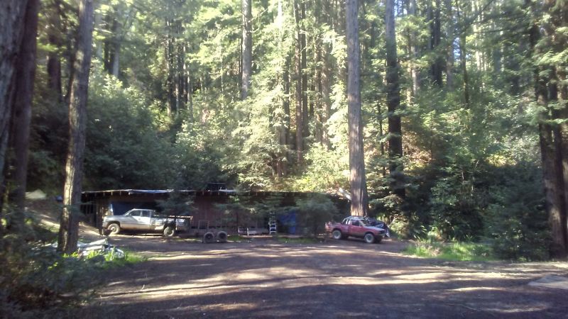

# Posted: 7 Apr 2020 09:12pm - Edited by: paulz
Here's the 12x20 screen mockup. Too high i think, the first would need ramps. I can lower it to roof hight and top those little trees. Buddy the dog is about 100' back, 3rd row parking. .

I'm complicating this I'm sure by wanting a drive in but for one I don't have your nice lawn and two my friends are old car hobbiests and will enjoy bringing their cars.
After looking at my mockup I think 12x20 is about the minimum screen size and also being that the viewing area will be 50-100' away I should make sure and get a powerful projector. No sense in skimping if the results aren't satisfactory. Another thought might be to try and rent one for the first go.

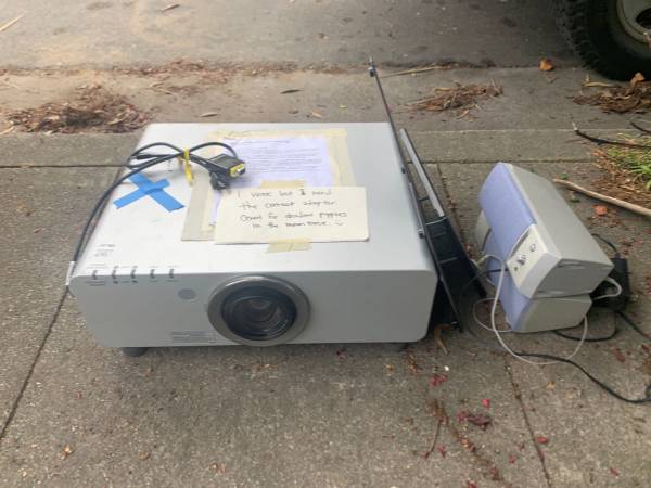

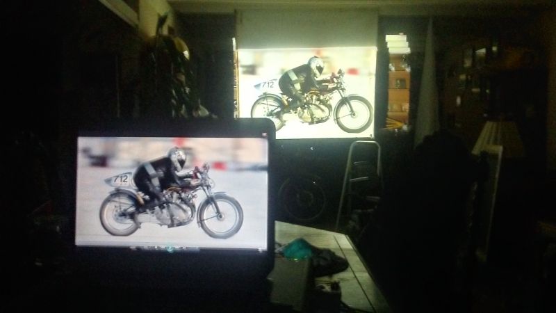

# Posted: 10 Apr 2020 11:58pm
Got home from the cabin yesterday, was poking around the 'net for projectors when fate stepped in, FREE projector on the curb in Oakland on Craigslist. Didn't say what it was but the wife was jonesing for a road trip so off we went. Luckily it was still there. The usual bay area commute gridlock was gone, it's like it was 30 years ago driving around.
It's a bit of a dinosaur, no wifi or 4K but it's a Panasonic with 6k rip roaring lumens, $10K when new a decade ago. A good learner anyway, and it works! I have it hooked to my laptop, with some help from @Iburners, and it's playing DVDs. Just a quick test in my living room.
Also realized that I have one of those portable canopies out at the property with a white tarp, about 16x20, that might work for a screen.
Looking forward to getting back out there next week and see how it flies. 00O0O_85FSrGlP3EC_60.jpg
