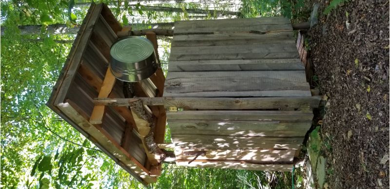

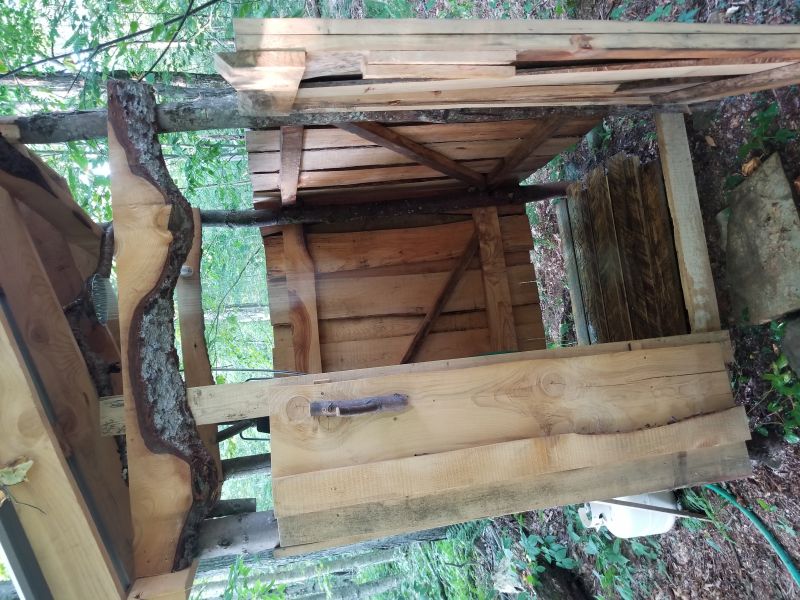

This is our shower. I have next to nothing into it. Maple poles I cut from the property sitting on rocks, a varnished oak pallet to stand on and lumber I milled for the sides and framing. The metal roofing I alreaty had. I have added a rain shower head in the ceiling.
A rain shower head helps make up for low flow/pressure.

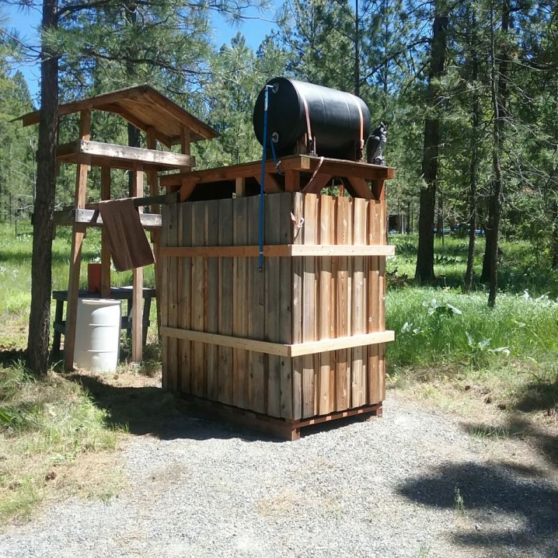

4X6, fully secure, can change and shower inside. 50 gallons on roof collects solar heat, I also have a propane water heater. I can fill propane heater water bucket by just turning on a valve. I get good head pressure from the tank on the roof. I also have a valve on it for when I leave for the last time, I can drain it off.

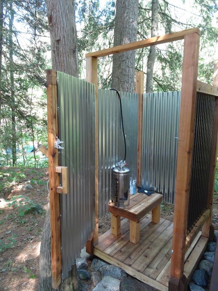

I built an outdoor shower stall a few years ago. It just had a Zodi Extreme shower, which I love.
But this year I decided that the old outhouse needed to go so I'm building a new "bathhouse". It'll have an Eccotemp shower fed from a rain barrel, and a composting toilet. I just slogged through 10 days building the structure and now have to start working on the interior.
Unfortunately, I'll be disassembling my outdoor shower stall and repurposing the materials.
I've posted pictures of the 2 structures for reference.
Outdoor Shower Stall
Bathhouse
Bathhouse
