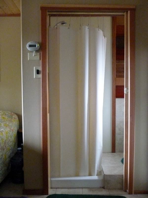

# Posted: 17 Feb 2011 06:46pm

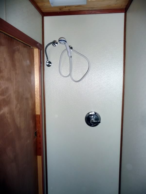

our cabin bathroom/shower. The unseen end is for the toilet, composting or whatever you have.

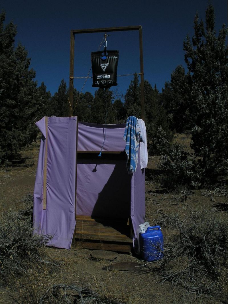

Solar shower. Doesn't work so well in the winter with temperatures below zero.

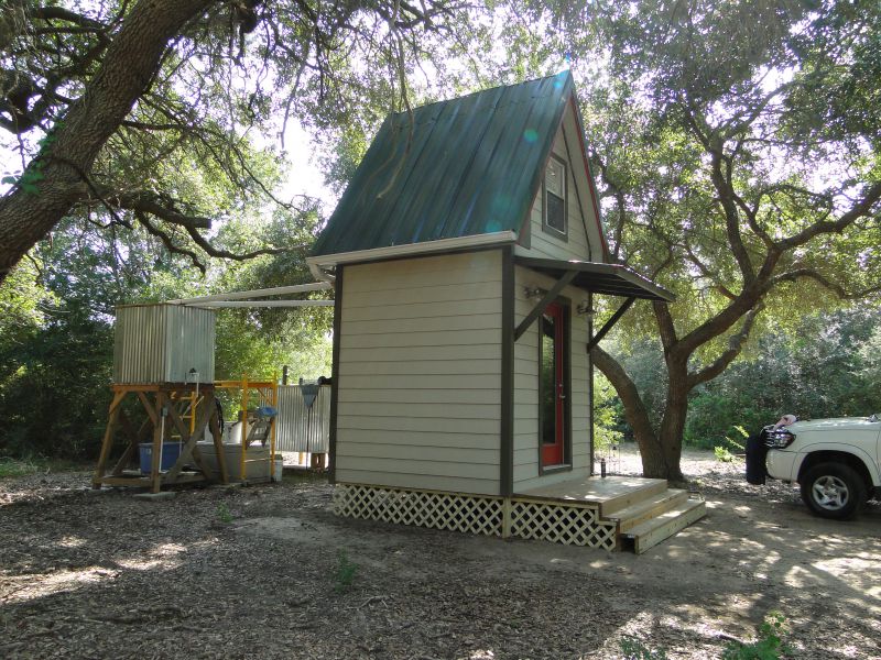

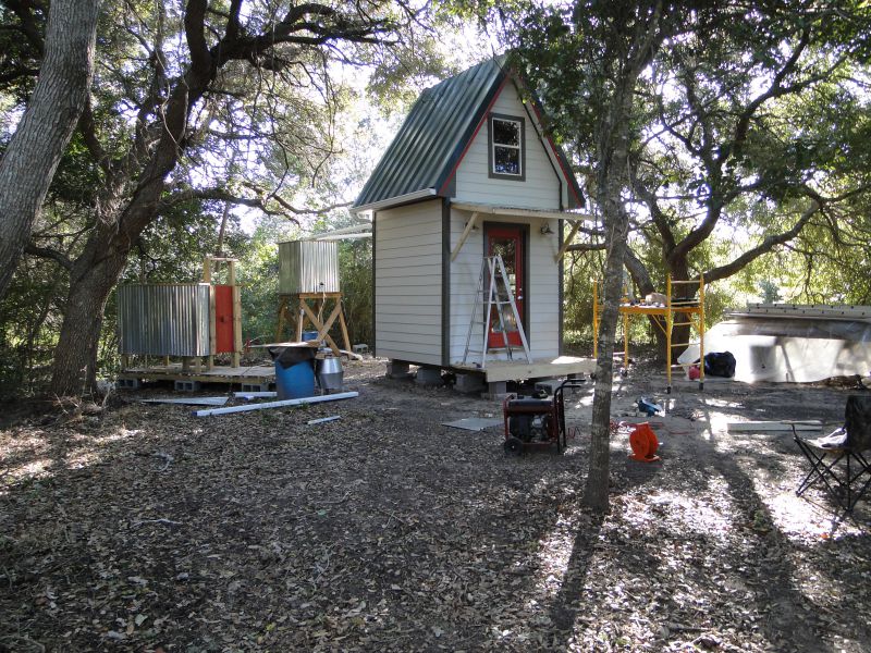

Not too current but this is it.
Construction of shower
Shower is in the left with the red door

mgc... I like your shower. This is very similar to what we are thinking about doing-though it will have to wait til next summer. I am assuming that the other tower in your picture is your water containment system. Do I see your gutters going to the tank? Do you have more pics? How does this work for you? Any info would be greatly appreciated! Thanks.

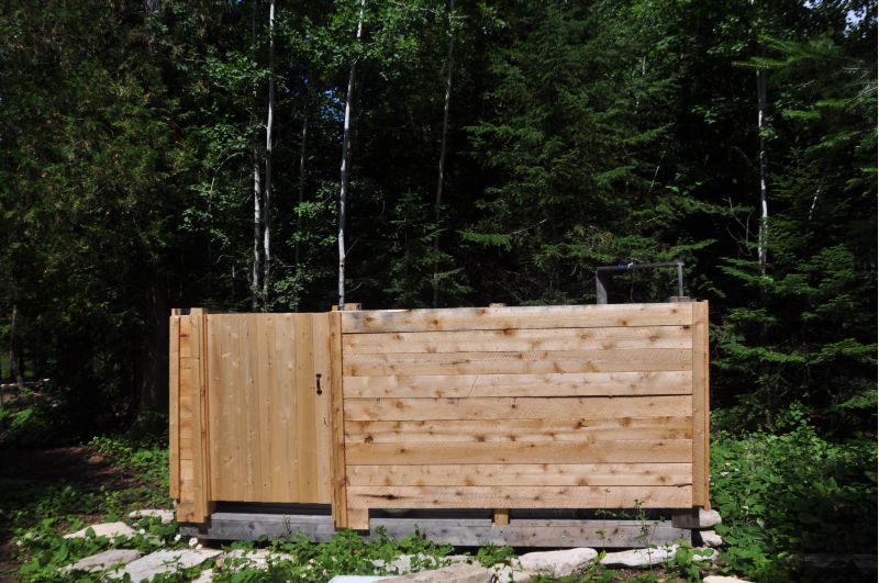

# Posted: 20 Aug 2011 09:10pm
mgc I too love the shower. Can you please share details?
# Posted: 20 Aug 2011 09:59pm

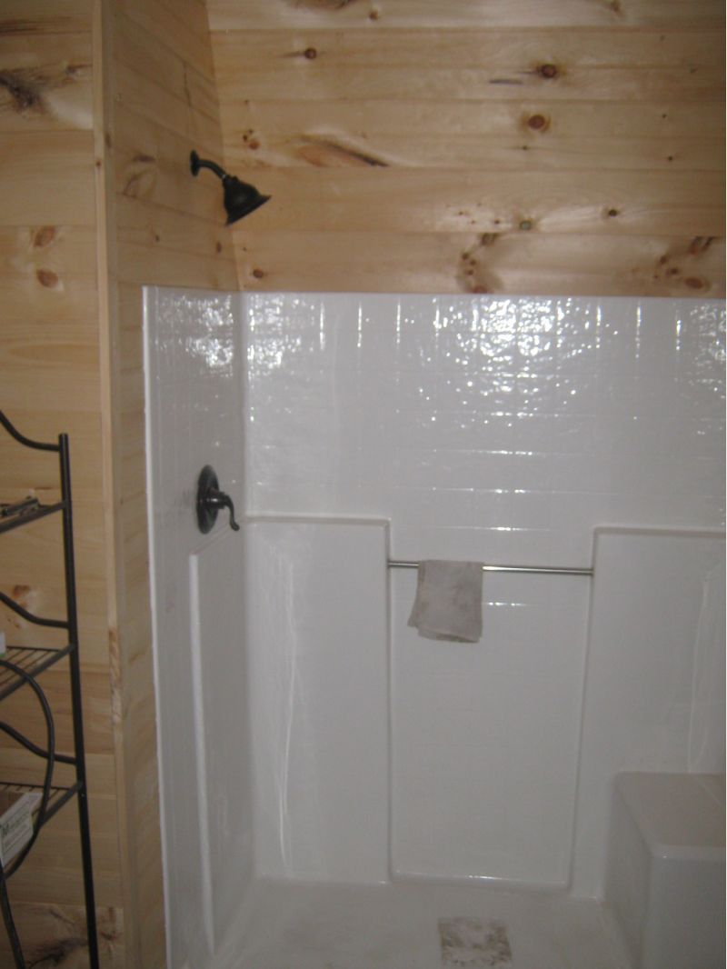

Here is our shower. Built with letovers from the cabin.
Shower with dressing room

Sorry for the delayed reply. The shower is fed water from the tank, to an RV pump and accumulator (12 volt), then to shower head. Simply turn on shower and bathe. Also in the shower stall is a second hose type outlet, this is for the fall and winter, to hook up the Eco-Temp water heater, even when the weather is in the 80's, the water is cold to bathe in, we hook up the water heater and life is grand! Pump is battery powered by deep cycle marine battery, fed by 45 watt solar panels, those are located back to the right of house, not in the picture. The water tank is elevated about 5 feet, it is simply a 300 gal. tote (plastic tank, surrounded by an alum. cage) that we covered with tin, the top is treated plywood with a hole for the gutter to enter. We covered the tank because algae will form if light hits the water, that's why white or clear water tanks are not so good. We used a white tank for 15 years at another off grid house we had and constantly had to add bleach. No light reaches our tank now so no bleach needed. The only reason the tank is elevated is because we don't always need pressurized water, sometimes just to fill buckets etc.. I'm sorry for this very long winded answer for such a simple water system. Oh, shower is made to be portable, I have moved it since these photos were taken, there is a small seat inside to make dressing easier. The door is closed by the exterior weight and rope, my neighbor and I had a couple of beers and that idea was born.

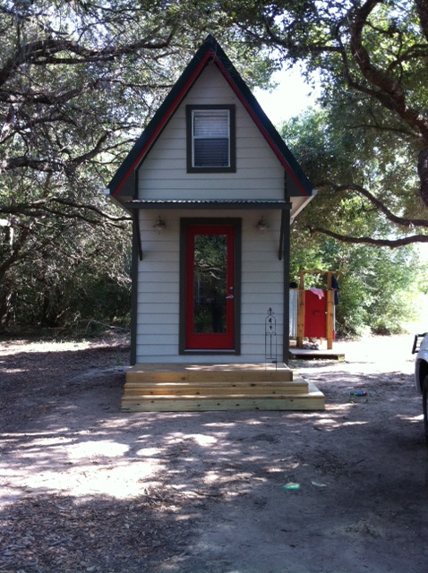

Shower is now on the right.

This is the absolute coolest house ever, who helped you built it?
# Posted: 25 Aug 2011 10:05pm
Thanks mgc- we were planning the exact kind of set up. We even have the same 300 gallon tank-clear with a metal cage around it. It is good to see pictures cause when I look at this tank just sittin there it looks HUGE but to see it in your pics it looks great. On your gutters do you have a diverter or any filters? Thanks for the info.
Your cabin is really cool. I love how tall it is!

mgc I like your shower.Your shower look very beautiful.
Thanks for share the detail.
