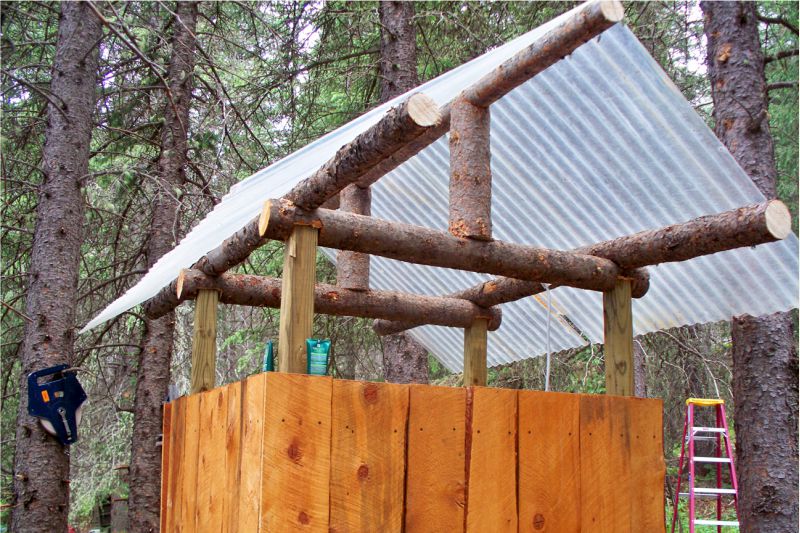

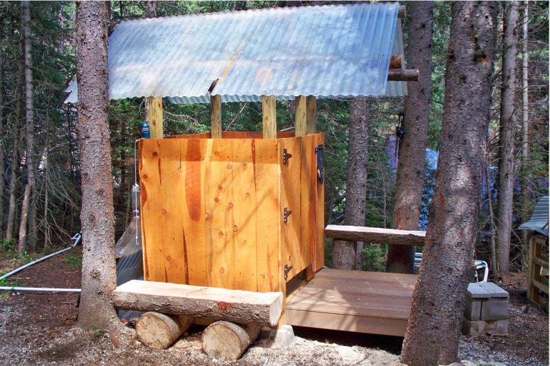

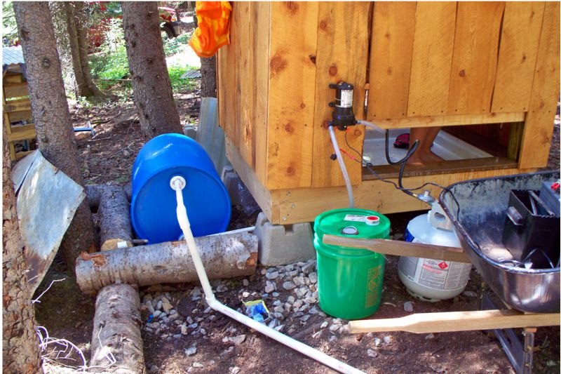

Hi all, we are not quite done with our outdoor shower but wanted to show it at about 3/4 of the way done. We have a natural spring on our property and made a catchment system that gravity feed's fresh spring water into a Spring Box (beer cooler). 3.3 Gallons per minute! From here it is gravity fed into a 33 gallon barrel and pumped via Flojet pump through the Eccotemp L5. Unlimited hot water in the middle of our Colorado forest at 10,000 feet! My wife named it ~Ahh~. Spring_Box.jpg

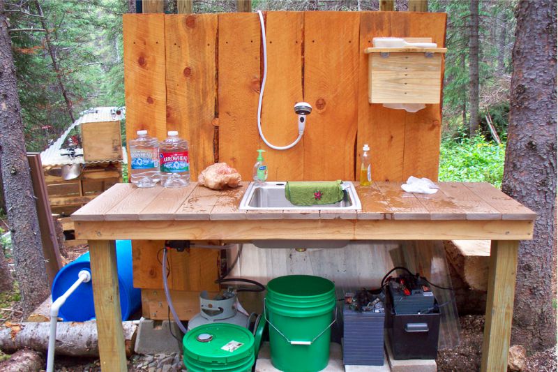

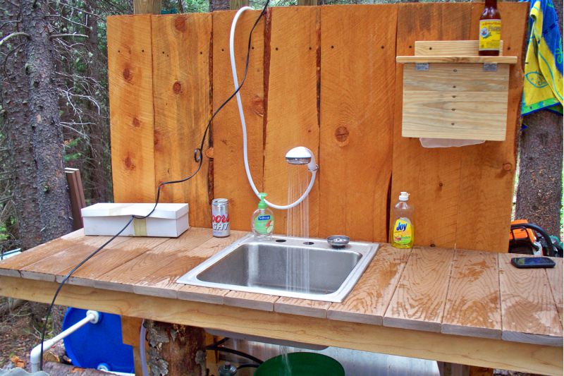

Just added the backside Trex kitchen counter to the Shower. The Eccotemp shower head doubles as the sink faucet for now. A 12v light clips on to battery also. Mighty convenient.... Shower_backside_1.jp.jpg

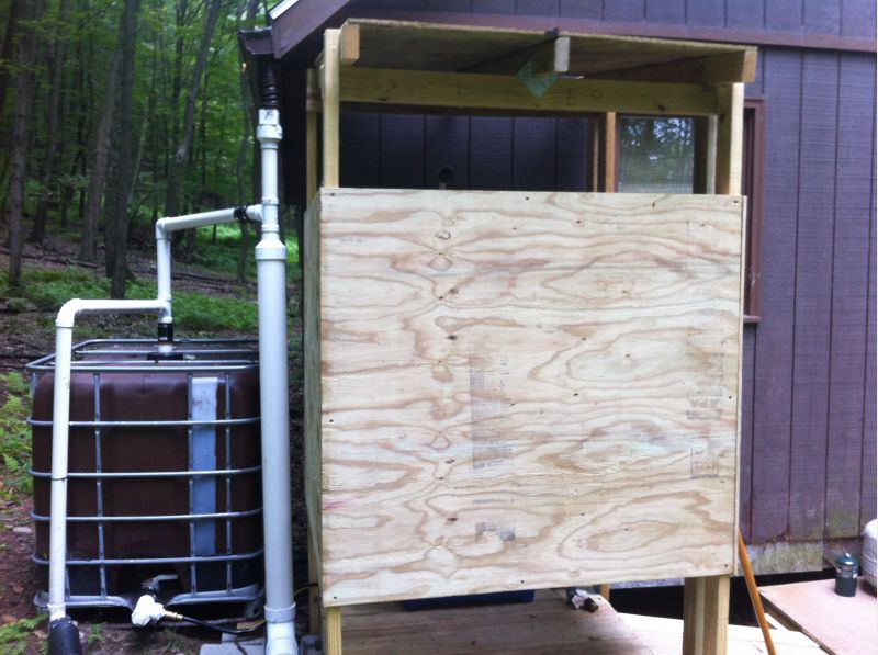

here is my setup. still a work in progress. 275 gal Rain water tote. flojet pump, L5 propane heater. shower and Tank
|  Shower
|  Pump

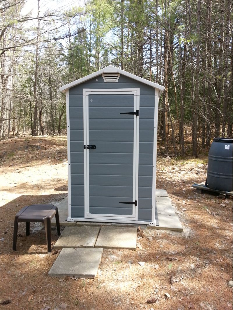

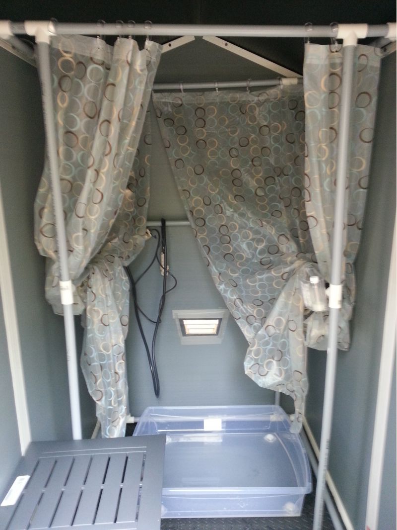

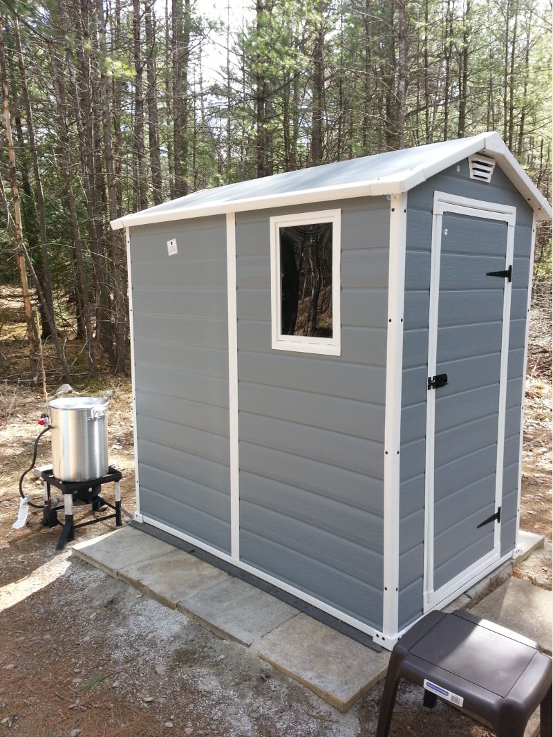

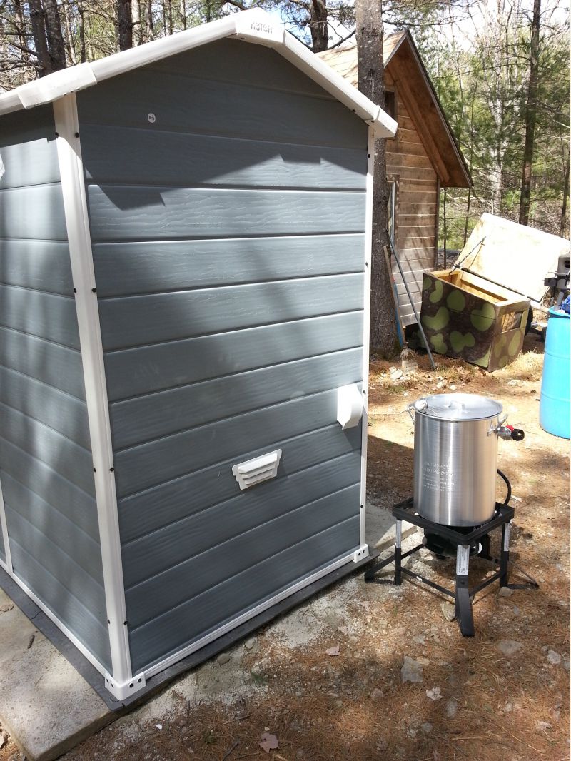

Finally got a weekend to complete the new shower and "library"
Picked up up a Keter 4 x 6 shed and split the space for use as a shower and bathroom.
On the floor we laid down those anti-fatigue rubber tiles which makes the floor much warmer and easy to wipe up. In fact we liked these tiles so much, we laid them down in the bunkie and put the carpet on top. Makes a huge difference on an uninsulated floor.
I used a hole saw to cut out a pass through for our 12v shower and covered it with an all-weather outlet box. We will also use this to run a pump to drain the water from the bin.
And thanks to the suggestions here, a 36 quart turkey fryer provides plenty of hot water
The shower uses a pvc frame and a couple cheap shower curtains.
We screened the vents from the inside, caulked and foamed so we hope it will stay relatively critter free. 20150426_114107.jpg

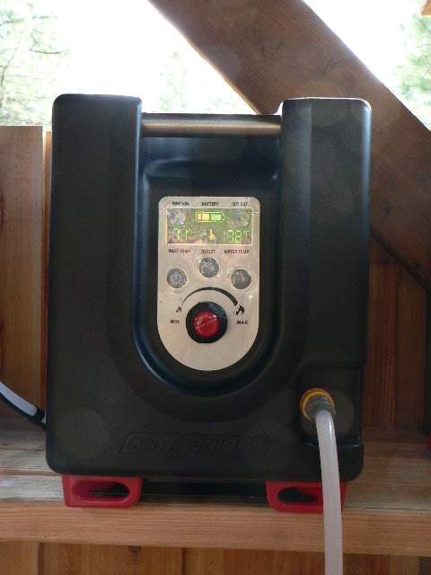

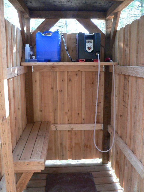

Oh, I can now add my photos to this thread.   Shower insides
|  AquaCube shower unit
|  Closeup
