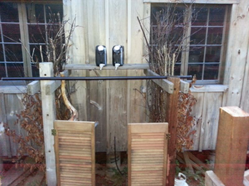

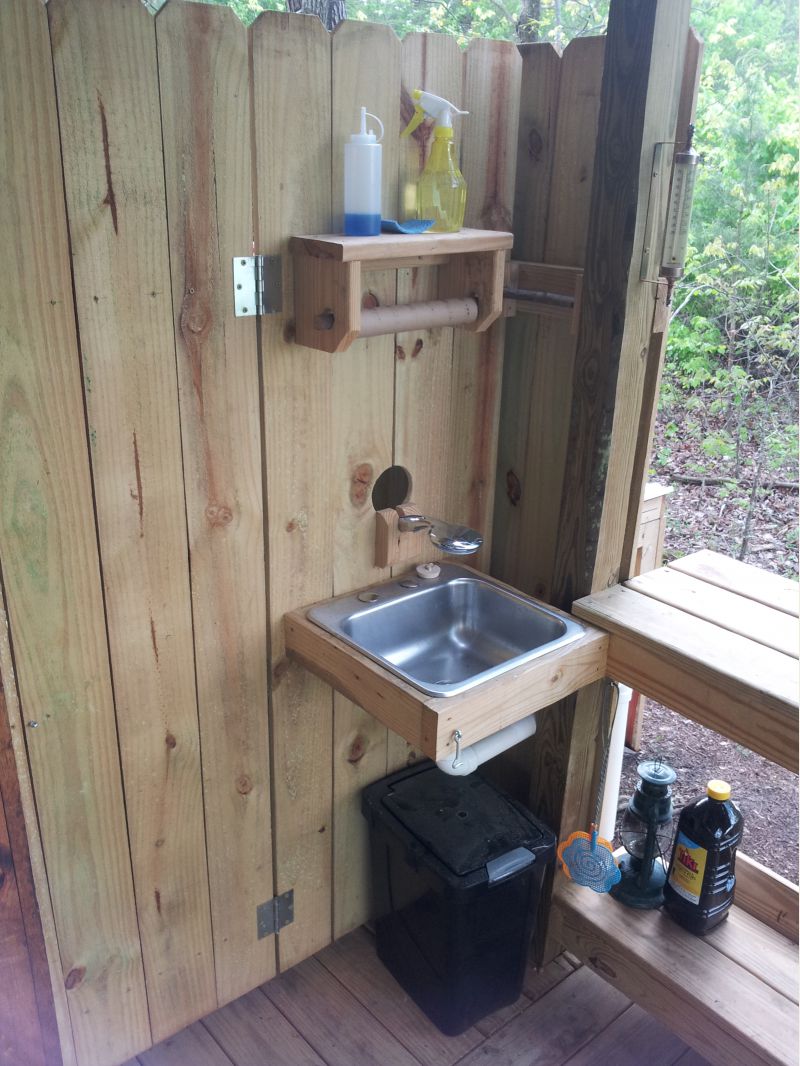

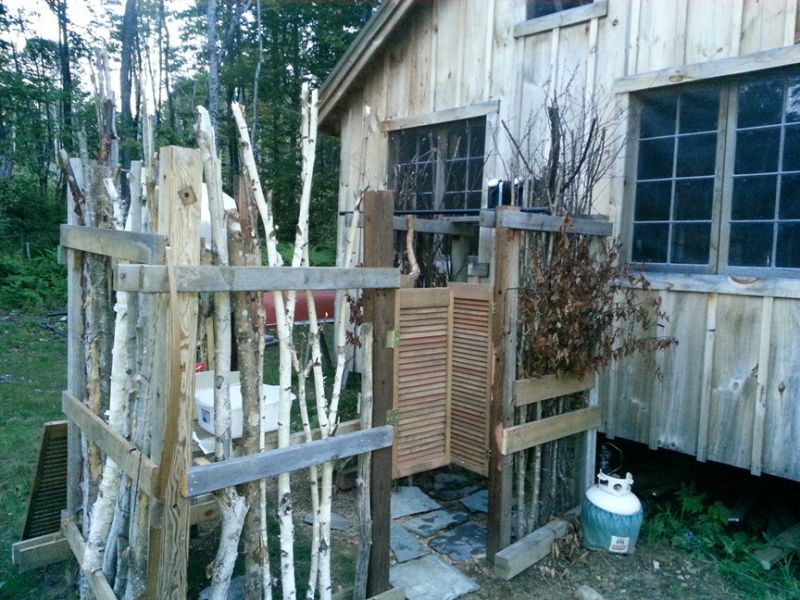

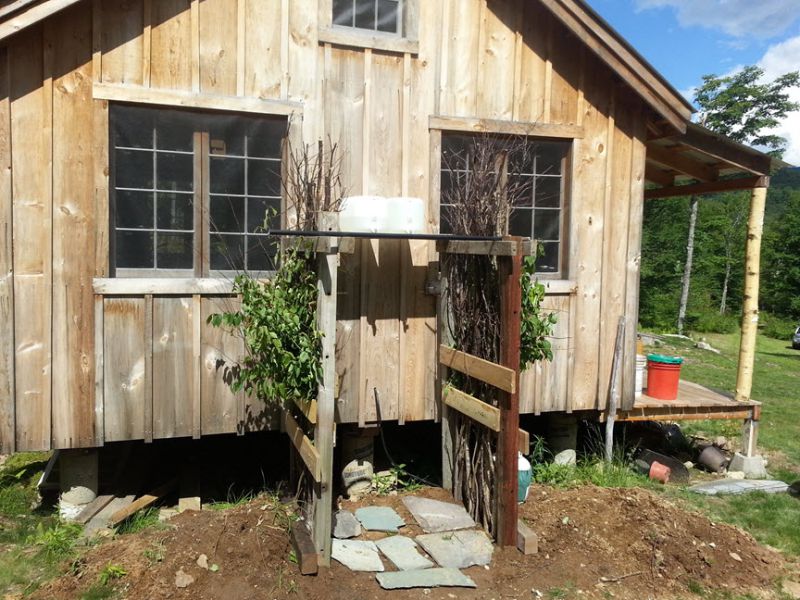

Hi folks, here are some photo's of a shower I put up this past month. cost was about $25 for the Carboy tanks, everything else was left over lumber from previous projects or found in the woods. The 'Wattle' work on the walls is only partial at this point, but should progress the next few Cabin weekends. The washing station in front evolved during the build. I may turn it 180 degrees to be more like the set up of MtnManDan above. I prefer the Carboys (from Uline) to the solar shower bags and have been impressed with the flow. The black paint warms the water up to a nice shower temp during the day. For the cabin, this has been an absolute game changer, wish I did it years ago. Shower with saloon doors in front.
|  Note the washing station on the left.
|  Basic

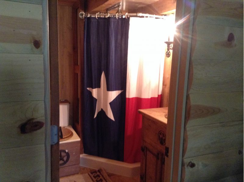

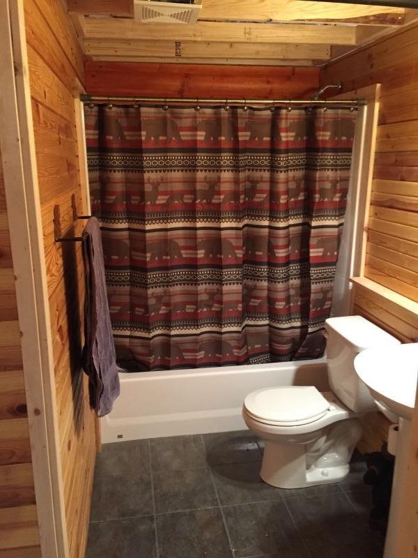

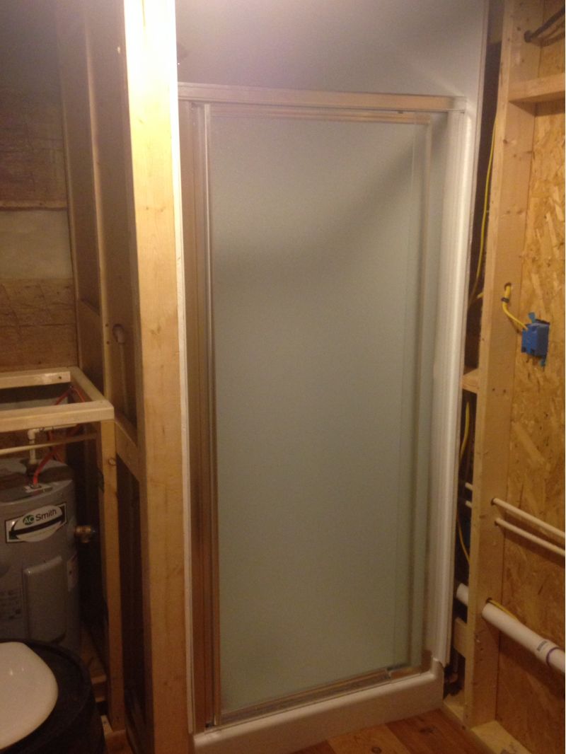

new bathroom in lower level of cabin

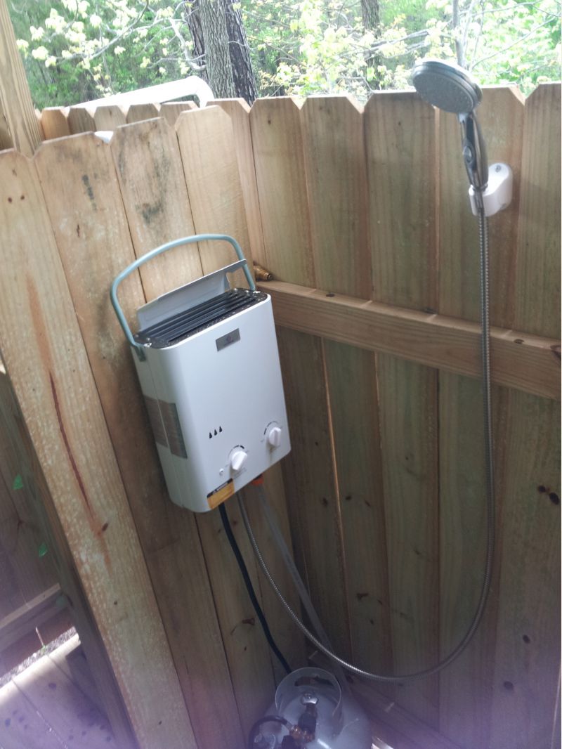

Shower on one side and outdoor kitchen sink on the other side...
275 gallon tote to collect rain water, Eccotemp L5 to heat it, Shureflow pump powered by a 12 volt deep cycle battery and charged by a solar panel to pump the water... It has been working well for over a year... Unless it's super cold outside and then the Eccotemp has a hard time making the water hot enough. 20150419_162743.jpg
# Posted: 21 Sep 2015 05:58pm
Irishguy, can you please photograph the battery,pump and solar panel set up? How long will the battery keep the pump running? TY.

From one Irishguy to another - I like it a lot !!
MtnManDan
# Posted: 24 Sep 2015 10:49pm
Well Shower Guy.... thanks to your "Hole In The Wall" idea....I am (for now) just cutting a hole in my shower wall!!!
MtnManDan
# Posted: 24 Sep 2015 10:56pm
Sorry, I meant to say "Well Irish Guy"  Fantastic setup you have there!...

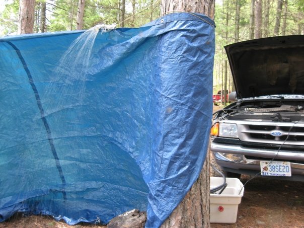

Before we bought our cabin, we frequently camped on crown land lakes accessible by 4x4 road. For the lady, (and also for fun & a challenge) me and a buddy rigged up a camp shower that provides unlimited hot water. The water is heated using a coaxial coil heat exchanger, with one side drawing lake water out to the shower using a 12v shur-flo pump, the other side passing coolant from the truck's engine by means of quick-connect couplings on a heater hose. It worked amazing even with icy lake water, the only unfortunate thing being the truck needed to be running for it to work. I've been meaning to get the system back up and running at the cabin, and build a little shower enclosure with room to park nearby. So far bathing has been lake-based though, but as the kids get older and the urgent repairs/renos are completed, longer stays are likely and little luxuries like this will be welcome.

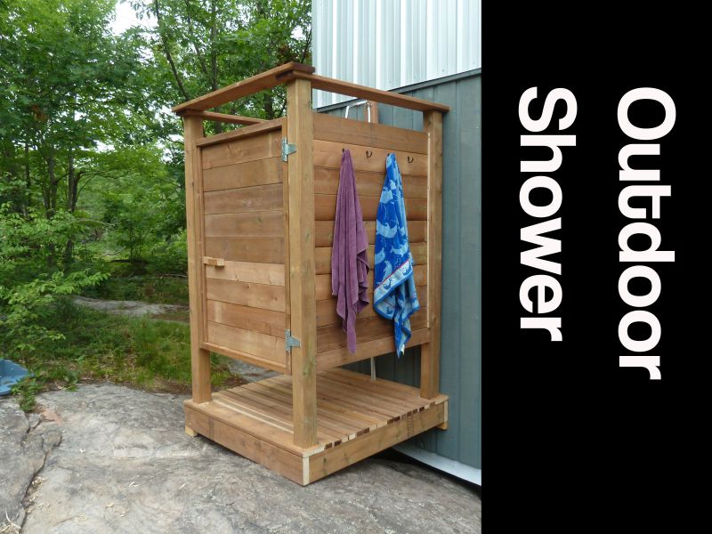

We just upgraded our outdoor shower. Check out the video if you want to see how we made it.
https://www.youtube.com/watch?v=kJbcXnlBr74

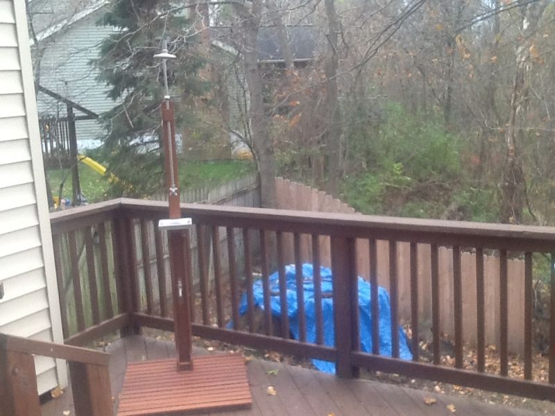

Found new-in-box outdoor shower at thrift shop at end-of-season price! Won't attempt using it til June, I suspect... Made to fit a garden hose. Will build enclosure and try gravity feed from a raised water tank. Also might consider running with 12 volt pump.
Assembled at home since cabin time is precious...

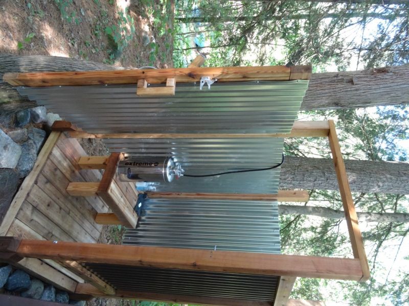

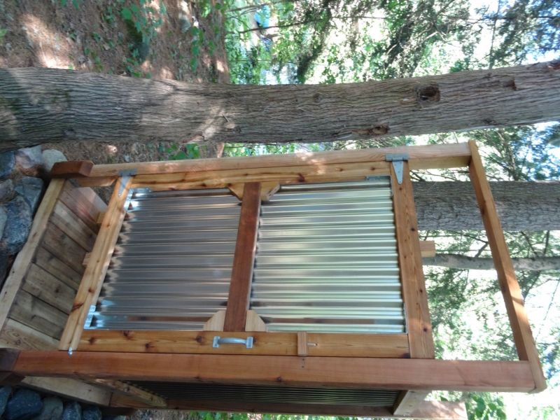

My wife got caught by the neighbours showering on our deck so I had to bump up building a shower on my priority list. It took me a couple of weekends build, transport to the cabin and assemble. I'm very happy with how it turned out.
Sorry about the rotation of the pics. I tried 5 different ways to fix it and none of them worked.

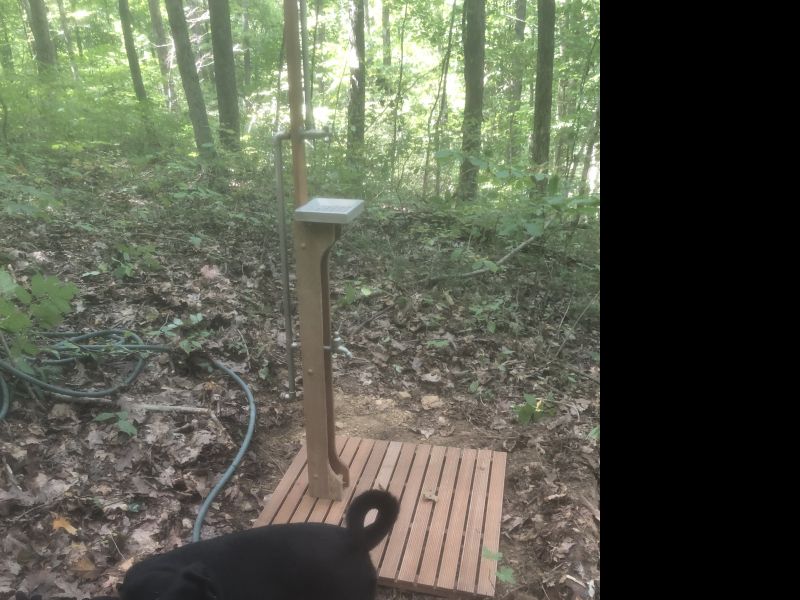

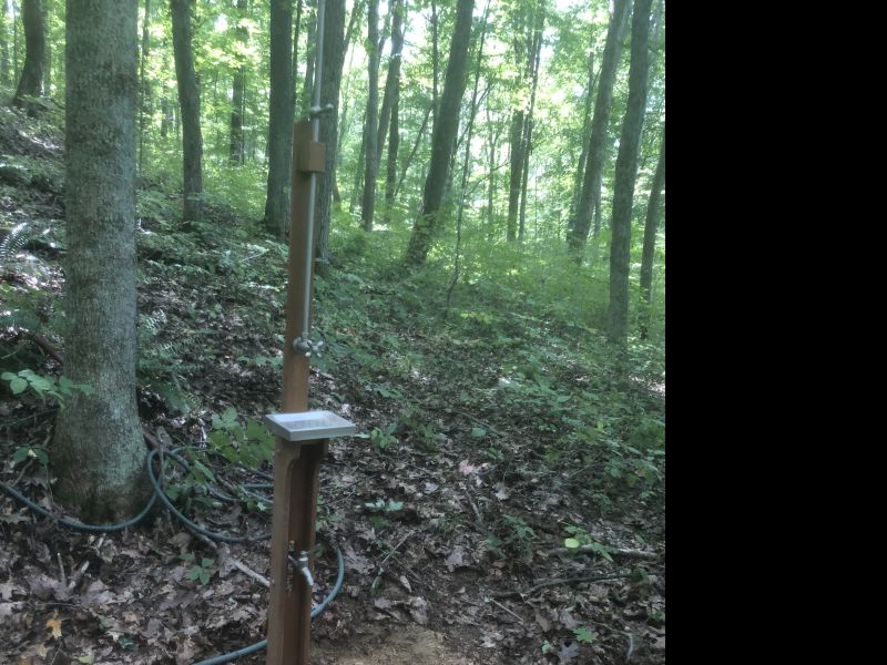

Got an empty 55 gallon at PepsiCo for $10 US. Used 15/16†spade bit to make spigot hole a few inches up from barrel-bottom. Connected tubing from downspout diverter ($15 from Ali Express) to fill barrel.
Found 3 lengths of garden hose being tossed out. Connected these to spigot and ran the hose down steep hillside behind cabin to outdoor shower (a few posts up, and a few years back, got distracted)
Might have 40-60 feet head height? Good water pressure! Very refreshing after mowing. Too bad it’s about the end of cold water outdoor shower season for me! Setup in the woods
|  Future shower customer

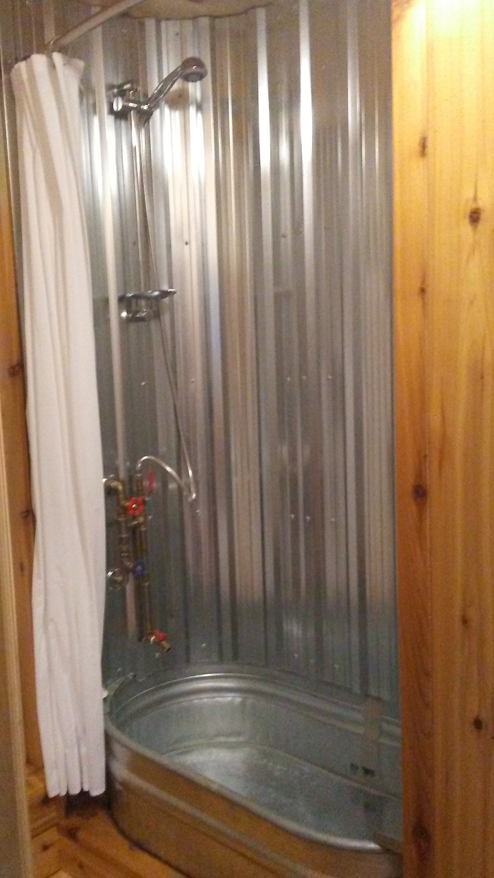

Attached is my Shower/Tub setup in the cabin.
Built on a platform to accommodate the drain using a HepVo Waterless P-Trap. https://hepvo.com/
Tub is a Galvanised "Sheep Trough" that is 4'Lx2'Wx1' high.
Side panels are shallow rib galvalume tin. Using Stainless screws & the galvanized capped washers with the neoprene washer (the same as used for regular tin installation).
