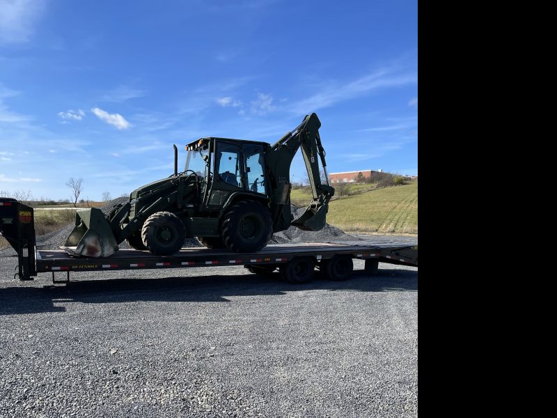

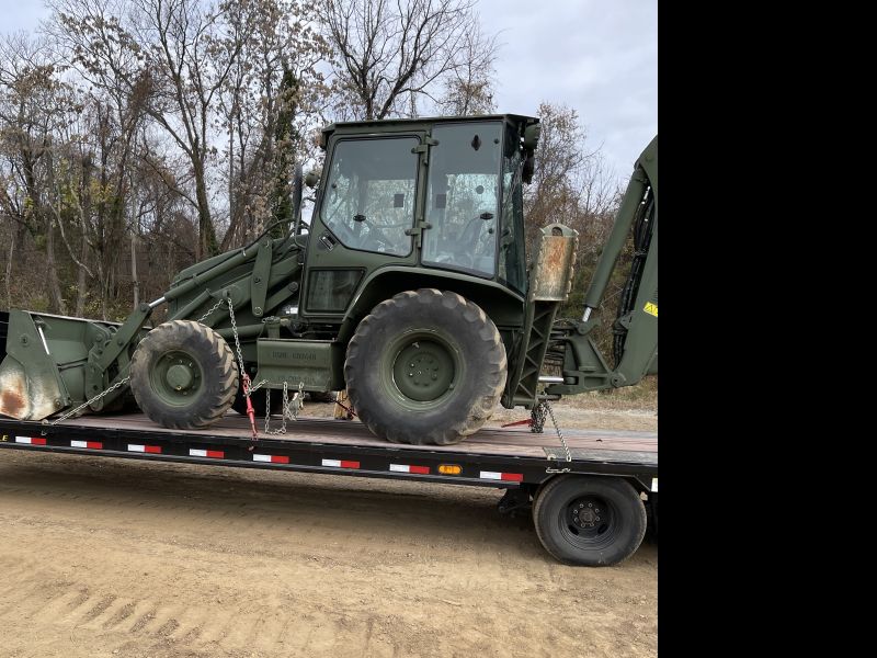

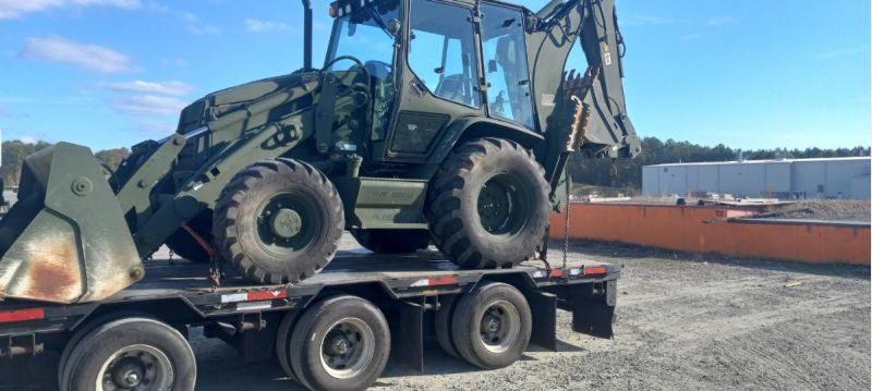

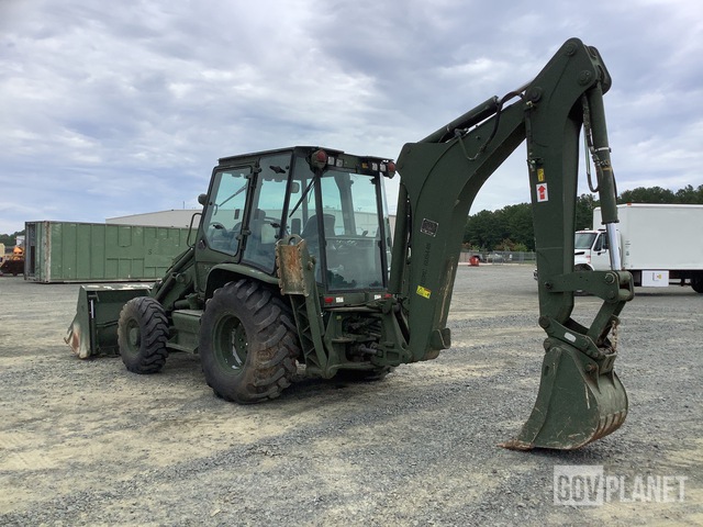

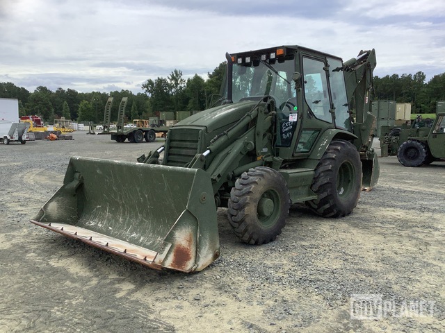

Cat 420D Backhoe, 900 hours on the meter, $65K. The clam shell bucket will get new teeth. The backhoe bucket will get rock teeth. Its going to the Cat shop for lube , fluids, and filters. I'm selling the Yanmar tractor. It's been a great tractor but I need a bigger machine.

That's a beautiful machine in a glorious color. What base did you buy it from?
I bought a few generators from fort drum years ago.
# Posted: 20 Oct 2022 01:24pm
Butner NC. Not sure its a base, might be a surplus yard.
# Posted: 20 Oct 2022 02:40pm
That's a beast. Twice the weight of my FEL/Backhoe. Cab looks roomy.

I like the color (stealth backhoe) and it's labeled USMC! I think I will name it Sgt Rock.
Cab looks roomy.

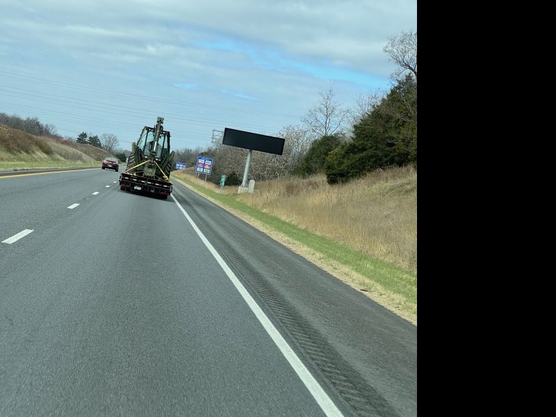

GovPlanet Yard loaded. Sgt Rock is at the Cat Repair place now getting some love.

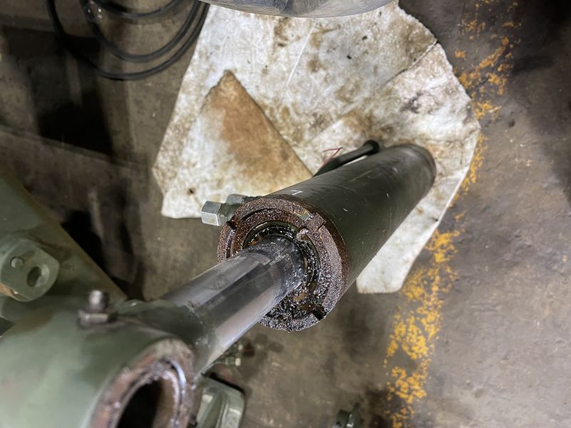

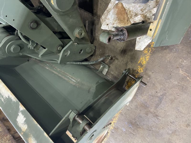

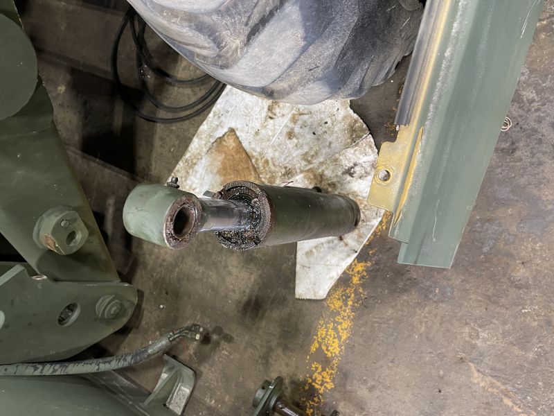

I found a web site that says you can put full synthetic grease on hydraulic cylinders to help the seals last longer.

Those pics rotated 90 degrees. They are 3-4 Mb from an Iphone.

Sure does, been doing it on motorcycle fork leg seals beneath the dust boots for years.
# Posted: 5 Nov 2022 07:35am
Quoting: DaveBell
Not in that application. The grease is is going to collect any dirt and act like sand paper. Those cylinders are the down side to a 4 in 1 bucket.
I also dont believe synthetic grease or normal dino grease would make a difference on that machine, your not greasing high speed bearings.
# Posted: 5 Nov 2022 08:27am
Was that ram leaking? I replaced the original seals on my backhoe and FEL this year. No hour meter but it's a 1974.
# Posted: 5 Nov 2022 08:40am

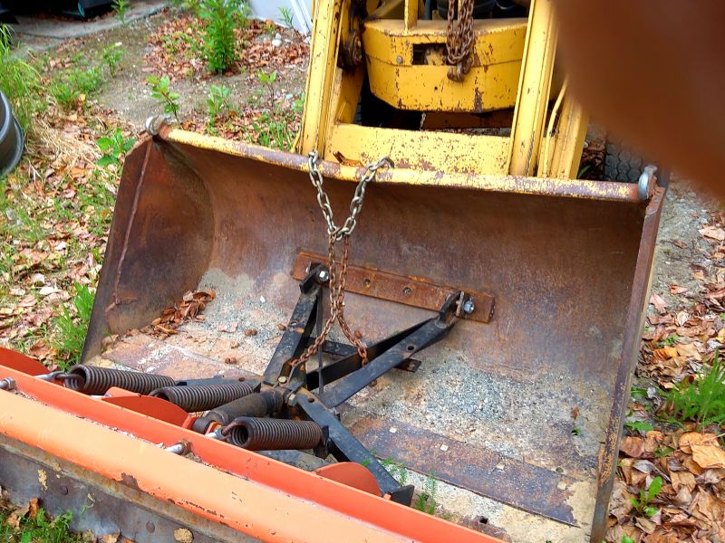

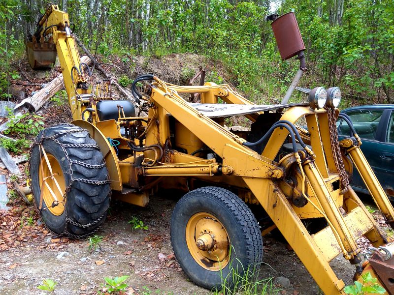

I guess I have the oldest around 1959 Case 420. Paid 4 grand 10 years old. It gets used a bunch. I mounded a bracket in the bucket to attach a snowplow to to help with snow removal.
Case 420b
Case 420b
Plow package
Plow package

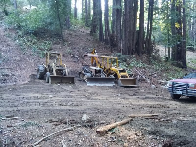

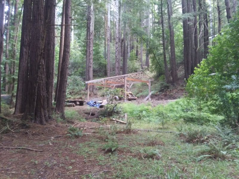

We're tied, my other Massey is a '59. Gets the most use out of all three. The FEL is easier to use without a backhoe attached and the box scraper keeps my driveway manageable. The skid steer is also a 70 something. 3K for the backhoe, 1K for the '59 and the skid steer was free.
My new tractor port sits in the spot that photo was taken in 2015

Re. grease on the seals, etc.
Clean rams is a must to keep from eating seals. In downtime or storage spray the seals with a cleaner, wipe off, smear lightly with the grease and wrap a clean rag around.
Prep to run; turn the rag inside out wipe the grease off the seals with the rag, run same up/down the rams to clean and ready to run.
# Posted: 5 Nov 2022 09:08pm
The Cat Tech said it was. From the auction pics both front cylinders were wet.
Quoting: Brettny
I think there is a plastic scraper ring before the two rubber o-rings. So the process might be to exercise the cylinders with grease to let the o-rings get lubed and then clean the grease off to prevent the sandpaper effect you suggested.
Agree. Your process sounds good! Thanks!

That's a cool machine. The muffler is custom deluxe.
# Posted: 6 Nov 2022 06:15pm
Quoting: DaveBell
Yes a plastic scraper seal is first. If it's doing its job then no grease will be getting to the actual seal and one cycle and all the grease would be pushed to the end of the rod or stuck on the scraper.

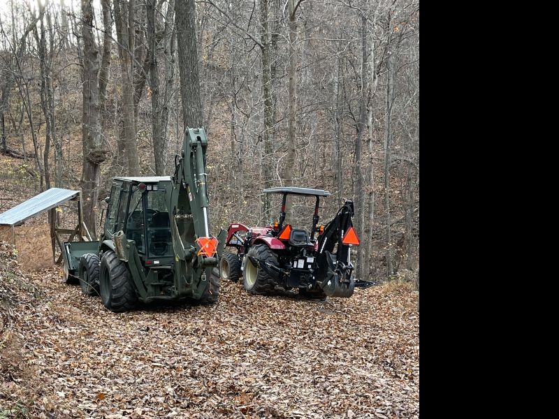

Ready to work on the mountain.

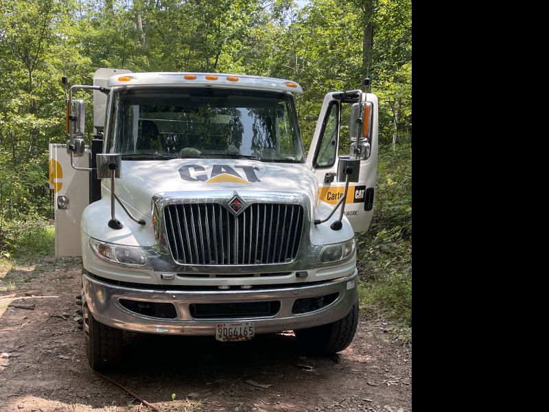

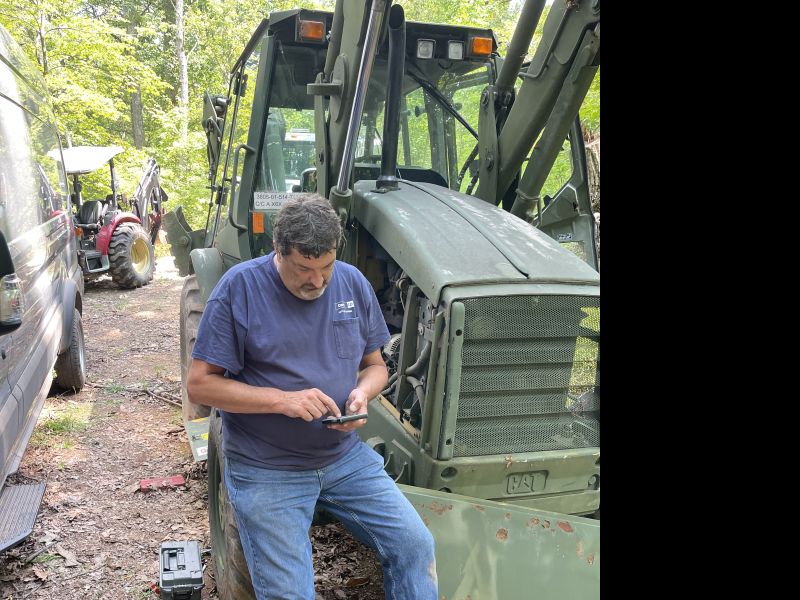

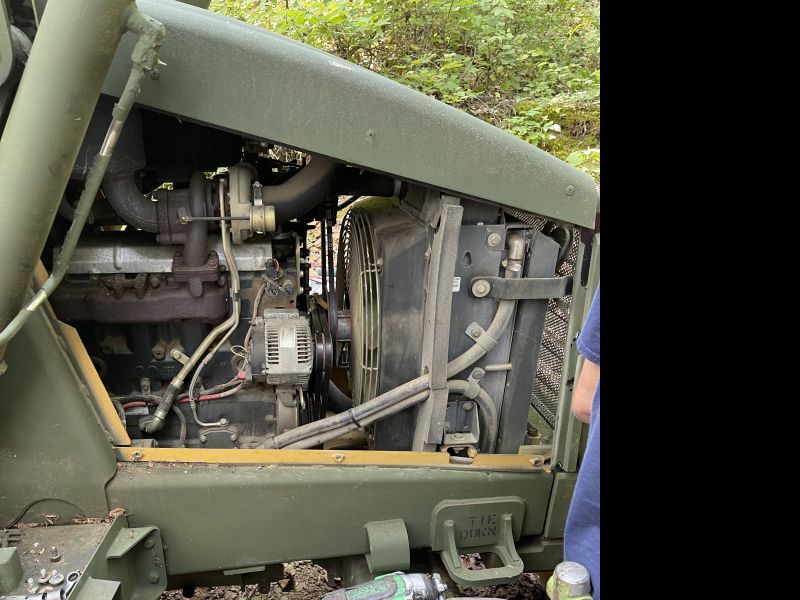

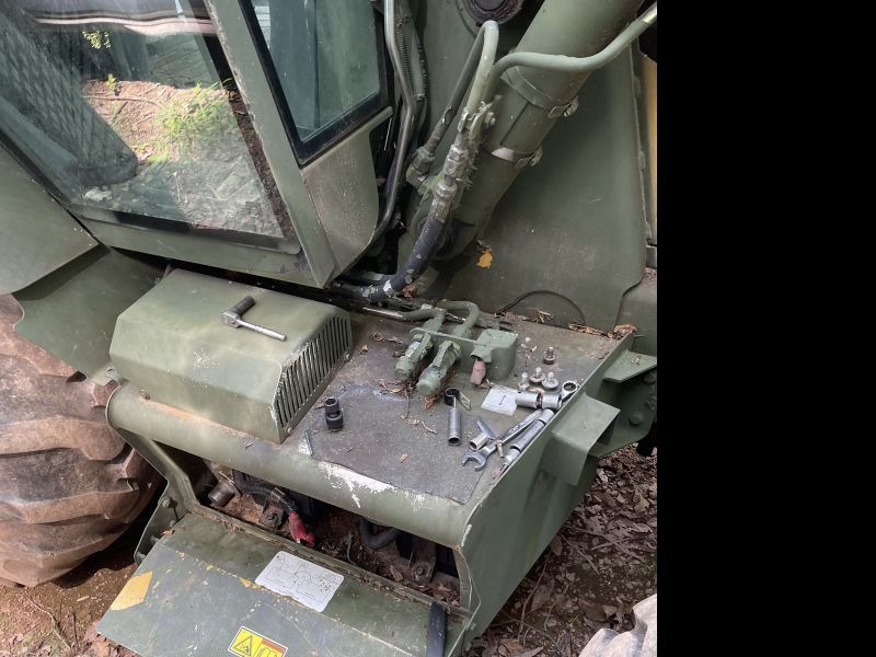

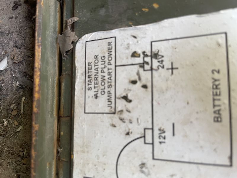

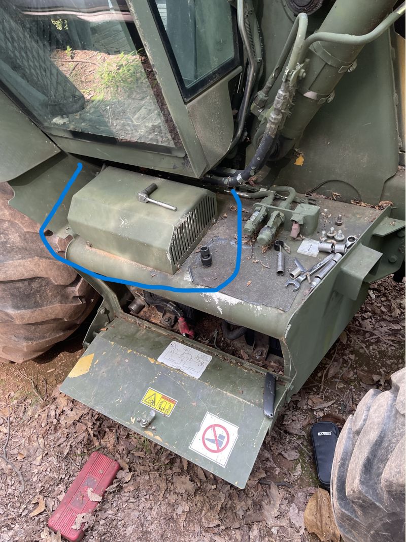

Well something sucked the batteries dry. Like a parasitic draw. Checked across all the spade fuses with a jump pack connected. 0.18 current draw on all fuses.
This is a commercial Cat 420D with military adaptation. The rear battery supplies the cab and associated devices with 12Vdc and the front battery (in series with the rear) connects 24Vdc to the alternator, starter, and glow plugs.
Two Cat mechanics came out with two new batteries connected them up and installed a negative side battery disconnect switch, as a work-around in case they could not figure out what was draining the batteries.
# Posted: 17 Aug 2024 03:02am - Edited by: DaveBell
They started the engine, purred like a Cat. After lots of looking and thinking, they asked what this thing was. They took the cover off, it is a Battery Equalizer, with 12Vdc, 24Vdc, and ground connected. They looked up the model number and found a recall on it for fire hazard. It turns out to be a Rube Goldberg engineered mess. Replace it and add a second negative battery disconnect switch and maybe it will work. I don't need to maintain it's military configuration.
I said lets just change this to 12Vdc. Replace the alternator, starter, and glow plugs to all 12Vdc, wire the batteries in parallel, and delete the potential fire bomb.
# Posted: 17 Aug 2024 03:22am
One of the techs said this is the cleanest 420D model he ever seen. I said its only got 900 hours on it. While it was running he saw that one of the hydraulic cylinders on the boom was leaking. So they are ordering parts to fix my Rube Goldberg battery situation. The battery equalizer will be deleted. After that is fixed they will take the hydraulic cylinder off and take it back to the shop to rebuild it.
