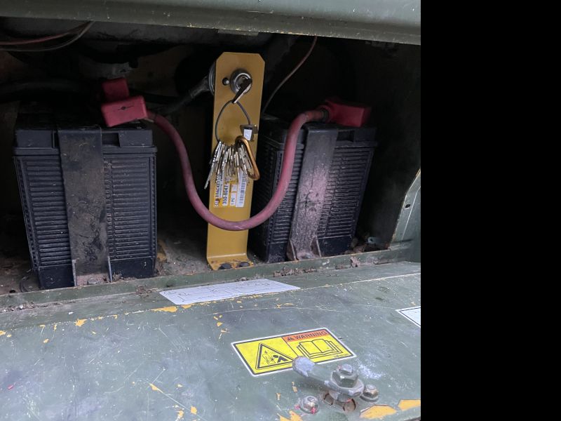

Removed the battery equalizer/fire hazard that was on top of the battery compartment, installed 12V glow plugs, starter, alternator, two batteries connected in parallel, and battery disconnect switch for security and preventing any parasitic draw. We think the equalizer was the problem killing the batteries.

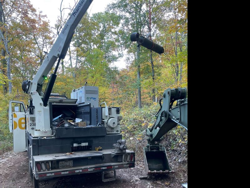

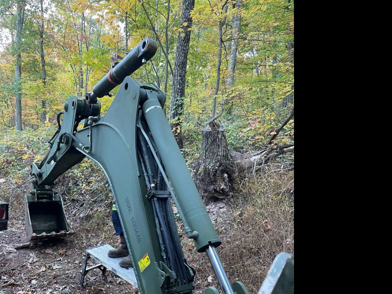

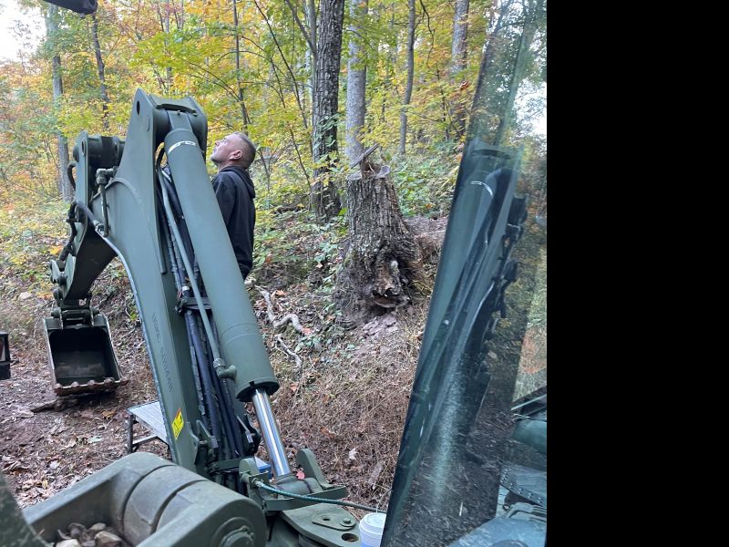

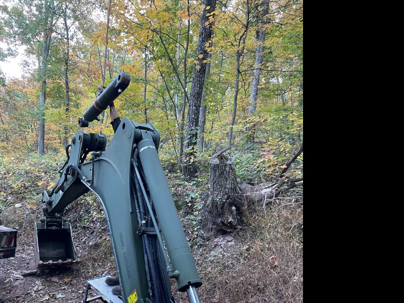

Rebuilt leaky boom cylinder.
