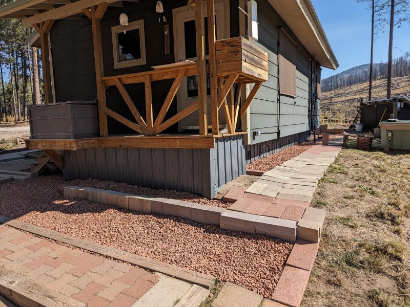

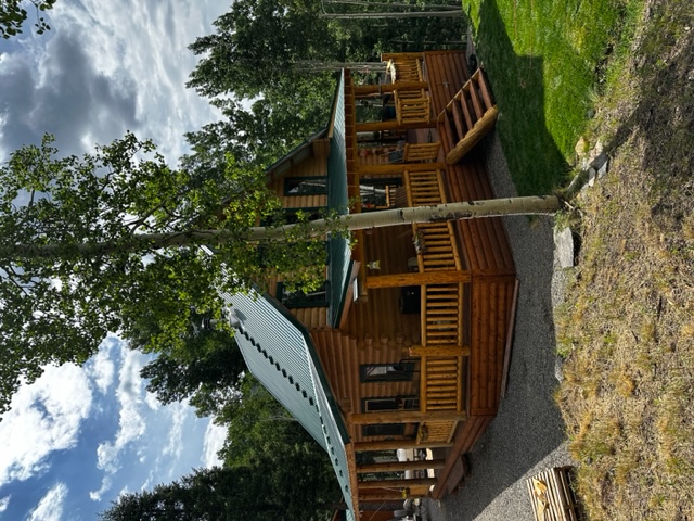

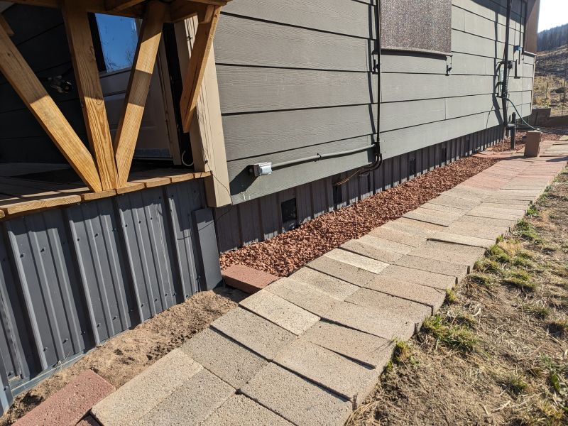

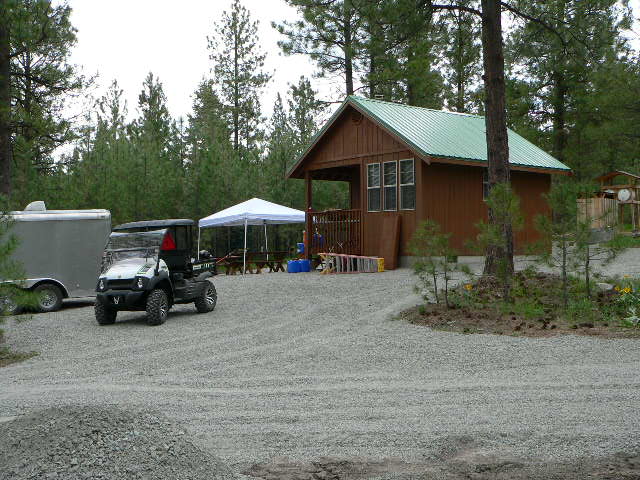

My cabin survived the wildfire that hit a few years ago. I started a project to improve the likelihood of surviving another. I never had bushes or shrubs growing close to the perimeter, but there were grasses. So I have eliminated the close to the cabin grasses. Grass was removed with a hoe and a fork in some places. A landscape fabric was put down and some reddish color crushed rock (7/8” max) spread. 1 ton this morning; started early.
It's not a perfect job but it is serviceable. The ground is hard as a rock. I've had a line of 8x16 pavers along the side for years. They were salvaged from a jobsite. They stop rainwater erosion as I have no gutters on there anymore. I added a second row now as they were free salvage I picked up last year in case I found a use for them. The brick walkway was also salvaged pavers (years ago). Concrete blocks sre salvage too. Timbers were all new.
I should actually replace the wood porch with steel to be even better preventatively prepared.
South
South
West end
West end

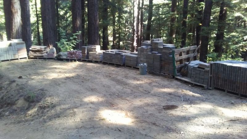

Good work Izzy. Pass the ibuprofen. Speaking of free pavers..
Back in 2019, a landscaper I met near my city house decided to pack it in and move back to South America. He told me I could have all the pavers in his stock yard, which took me about a dozen trips off and on to get them out to my cabin.
Here is about half, still sitting in the same spot today. The other half I have installed in front of the cabin.

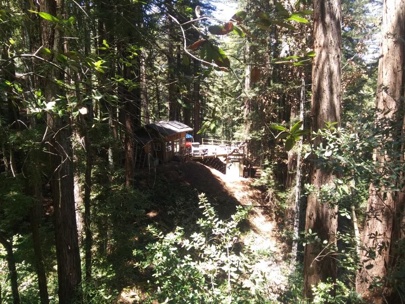

Gosh, looking at these pics, I think my place would likely terrify most of you...
1) Live Edge cedar siding...
2) 2x 200' Silver Spruces shading the south face of the house (within 20')
3) Tall cedars on the east side, & red pines on the west side.

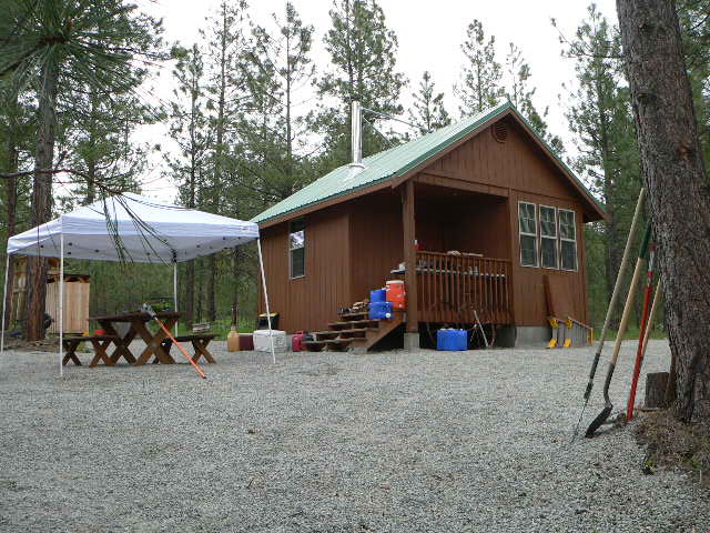

# Posted: 22 Oct 2023 12:39pm - Edited by: toyota_mdt_tech

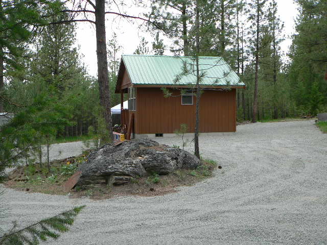

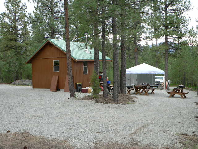

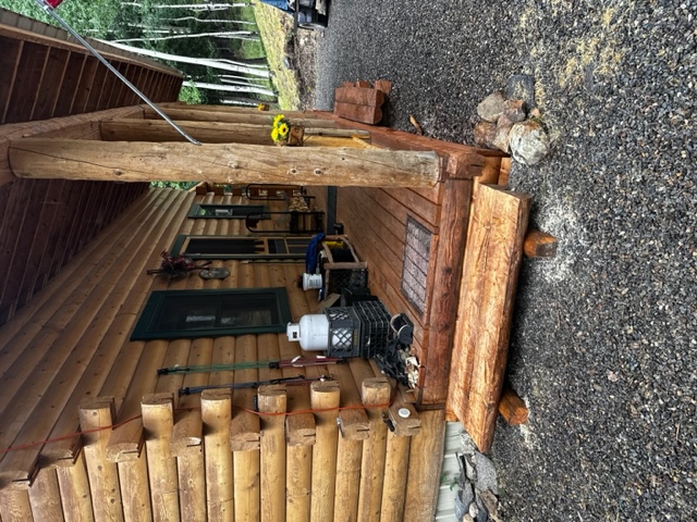

I was surrounded by fire in 2015, I came up just ahead of the fire, thick smoke, did loads of logging around cabin, cut treeline way back on the west side. I survived. Had a different mindset like ICC now. Next spring, brought in about $10,000 in gravel, gravel doesnt burn. thinned trees around cabin, cut all lower branches off at the 15 foot mark. Nothing flammable near cabin. I have a full foundation.
ICC, gable vents, install a baffle over them, removable types, install during fire season, but allows system to breath, but now allow blowing embers.
Any belt molding on outside or trim above windows, install a small strip of beveled molding to give it a 45 to shed sparks
Hardi board over fascia and if you can, hardi soffit.
ICC, add a cement trim board against cabin wall on deck area, so embers cant roll or pile up and set siding on fire. Spray deck with the fire resistance coating.
Bird block vents, I added a HD metal screen to the inside, the cheap plastic ones can melt with embers of flame. Once embers get into dry attic, away it goes.
In 2019, did the full 40 acre thinning by a professional outfit. ICC, now that you have a perimeter fence, bring in more fencing around cabin, turn horses or goats lose, they will eat the grass down, keep in short, in turn, it remains green, fire will burn up to fence line till it hits short green grass stubble and stop. Grazing animals is perfect. You can loan it out for a few cattle too, free grazing land etc, downfall is the cow poop.
gravel doesnt burn
gravel doesnt burn
standing where container is now

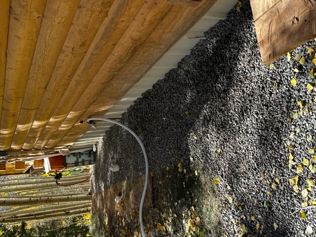

The fascia, soffits and all trim boards are Hardie cement fiber board. The cabin floor overhang along the long sides have galvanized steel flashing material nailed up under the overhang the metal skirting has lots of vent area and all are screened galv steel wire mesh with small openings. (I forget the exact size but they were approved by the fire marshall.) Same thing in the gable end vents. Steel roofing. Looks like your roof is much the same light green color as mine. "Patina green" was the name.
-Izzy

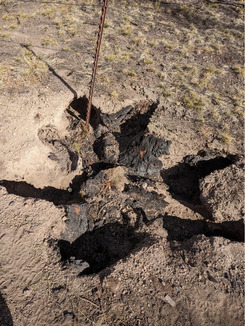

Not part of the firewise project... but the results of the last nearby wildfire. It is always interesting to me to see how the roots can burn way back underground.
-izzy
U2
U2
U1
U1
# Posted: 29 Oct 2023 05:40pm
Ive read reports that those can burn long and slow, like a super long underground pig roasting only measured in months, iirc.
# Posted: 29 Oct 2023 06:37pm
Yes, absolutely. I've seen it myself from winter slash burns we did. The FS here in NM is responsible for a 45,000 acre wildfire spring of '22. It started from a slash burn in Feb with lots of snow on the ground. Smoldered until April when high spring winds whipped it up.

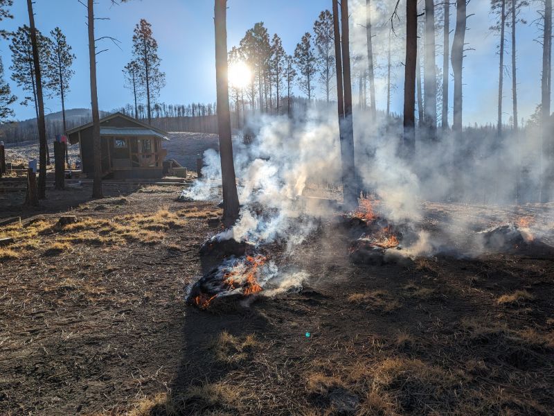

Burning some pine needles I raked up from around the cabin. Frosty morning, 24 F, but it will be sunny with a forecast high of 45F. Virtually no wind and the burn is approved by the county fire marshall.
-izzy
Needles
Needles
