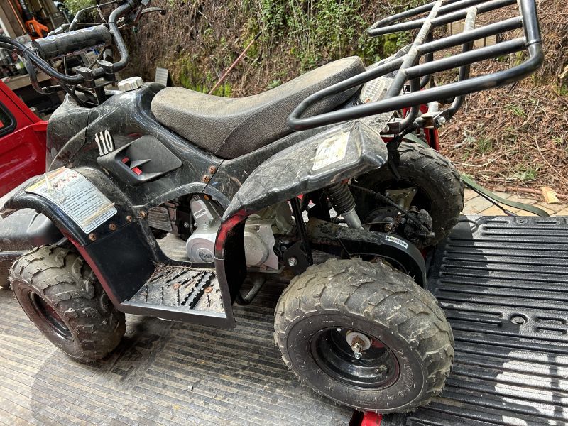

Been working a bit on this Tao 110.. Got a new key switch installed but so far not doing anything. I have power to the switch, that’s about as far as I’ve gotten. Wiring diagrams online that I can almost read. Jumpered direct to starter, it does turn over. Just one kill switch on the handlebar that I know of but there is also a remote clipped to the bars with lock/unlock buttons, probably dead from sitting/rust. If I could get spark at least I could start it. Must be a wire on the CDI box that kills it..
# Posted: 4 Apr 2024 10:12am
Sounds like a 'safety interlock' somewhere is not allowing the ignition to work. Same as the side stand and/or neutral interlock on motorcycles; they ground out the elec CDI ignition just like the key switch and bar-button.
Make sure the key switch is actually supposed to put pos. to ignition! Most modern stuff the switch just ground out the CDI rather than power up the coil and points like a traditional 'bike'.

Finally nice weather to get back to my widow neighbor’s ATV. Turns out it’s a Tao 110, says right on it! I hooked up a battery before, no spark. Jumpered to the starter, turns over. This was over a week ago.

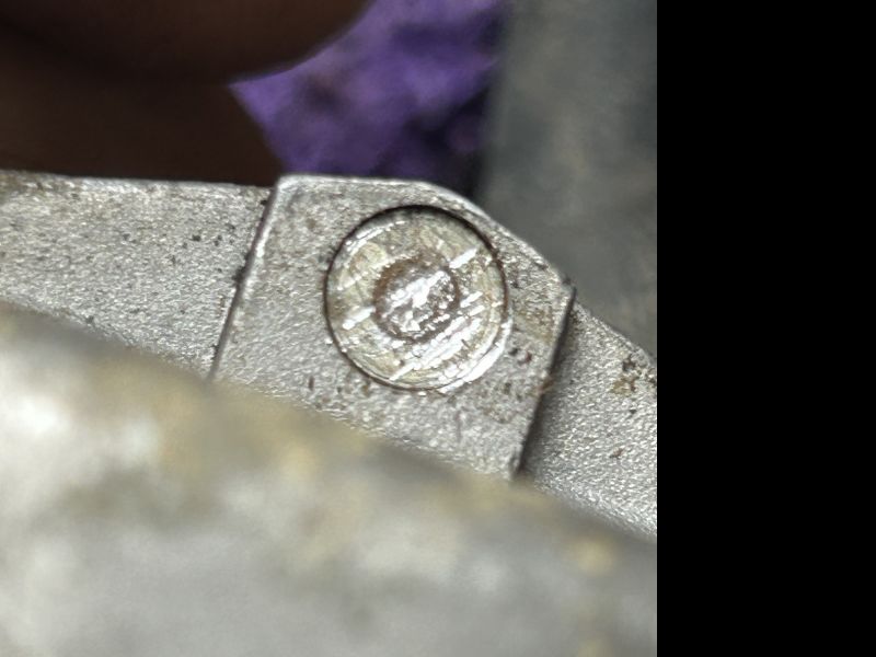

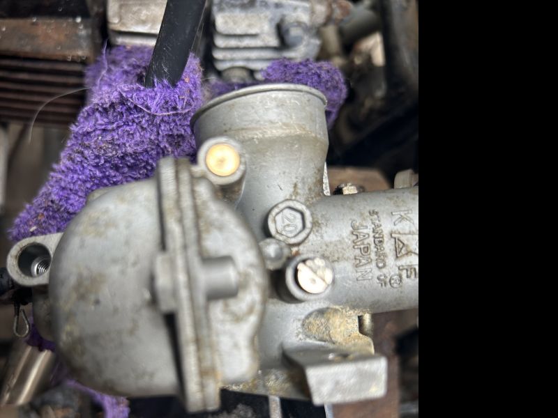

Well today I got it sparking and turning over with the button. Most of it was my fault, I’ll get to that later. So next is gas… put some in the tank, took float bowl drain screw out, turn on petcock. Nothing. 5 years of ethanol sitting… So off with the carb, easy enough, but these two float bowl screws have me puzzled. Hex head with a peg in the middle? Thought maybe but they seem to be solid screw head. Can’t even stick a knife blade in three.

# Posted: 17 Apr 2024 06:44pm
You sure Darz? I mean I can’t even get a pin head in there. Maybe someone broke a bit head off in there. Both sides.
# Posted: 17 Apr 2024 06:48pm - Edited by: paulz
Looks like the pilot mixture screw is plugged off too.
A “don’t F with me” thing?
It’s a 2018 I think
# Posted: 17 Apr 2024 06:53pm
Nope not sure. I was looking at the wrong thing. Lol. It does look kinda like a plug. I guess no way to pry it up?
My bad.

Ive pulled surface caps off stuff by drilling a small hole through and screwing in a sheet metal screw. That gives something to grab with a pliers.
They typically are over the mix screw and shaped like a micro bottle cap.

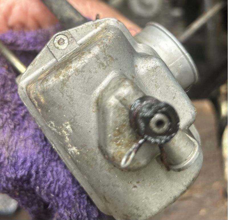

# Posted: 18 Apr 2024 02:01pm
Ok, ordering a new carb. But I also can’t screw the top off this one to pull the cable. Don’t see any locking pin or set screw. Even tried channel locks. Another “don’t F with me”?
