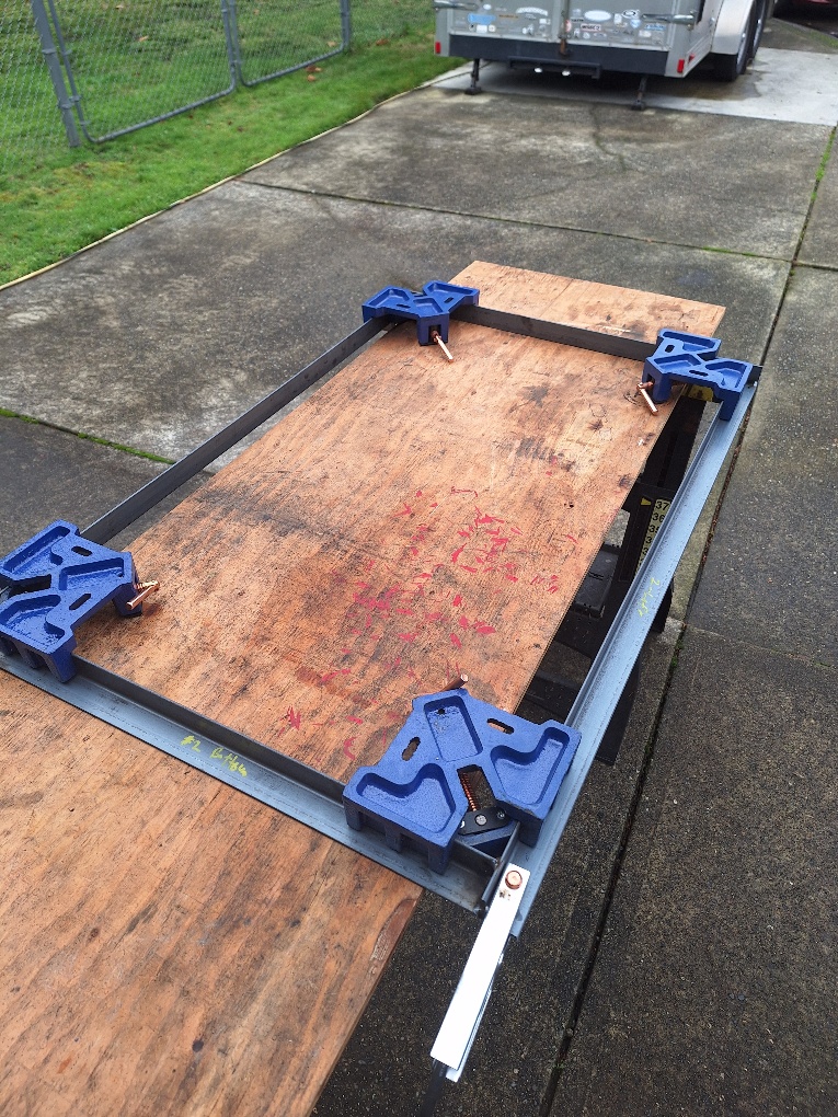

I am building out of steel, nice window covers, double as storm covers, very secure, also protect cabin windows from blowing broken branches etc. I have purchased all the metal and small parts, got started on one frame already. The screen will be expanded metal. 30 seconds to remove each.
I butted the corners vs miter them for less waste and stronger, then I will gut the square it leaves behind out.
I will post pictures of the finished product and progress along the way. They will be painted brown, buytl take between it and the cabin (water proof membrane) and screwed into structure with the low profile pan head spider drive screws.

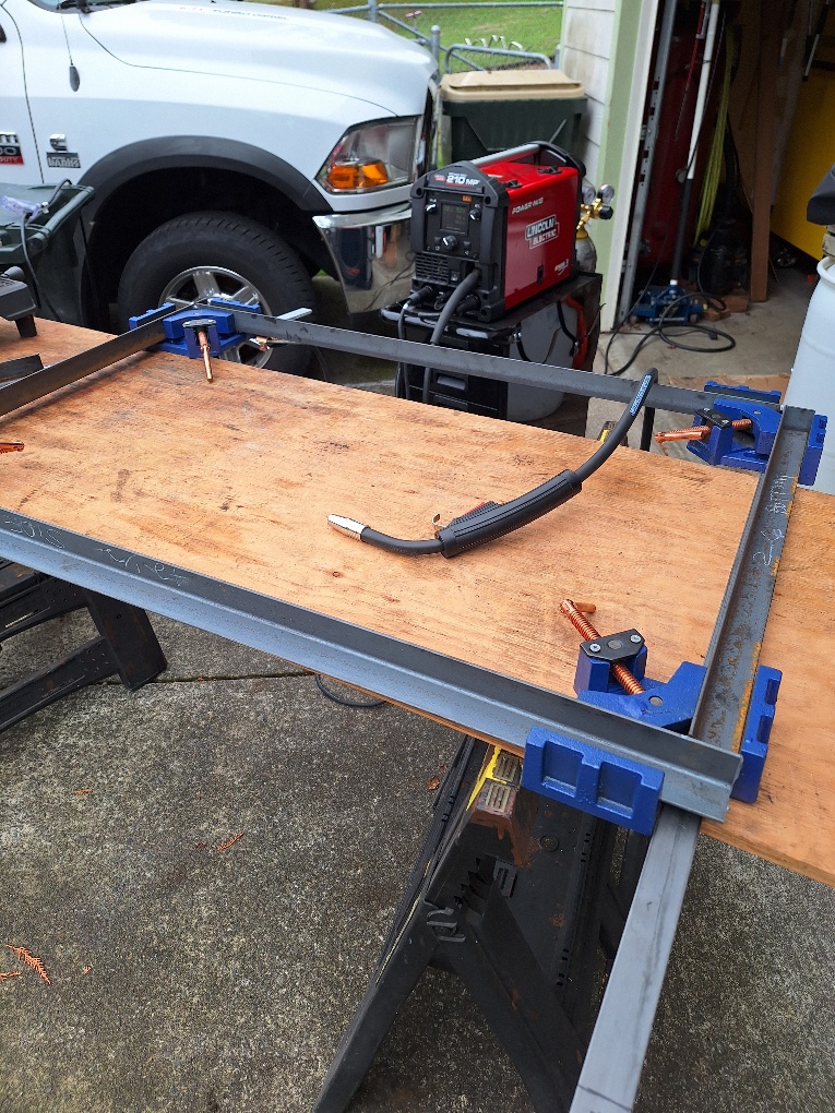

The flange you see goes around the window, with 1/4" clearance all the way around. The flat flange will use 4" ledger lock style, very low profile pan head with a special bit to screw them in, chamfer the edge so cant grip with vise grips, second part with expanded metal and slightly smaller angle iron will go over the base, concealing the screws. Will slide down over barrel hinges and lock in the down position. So unlock, slide up and off barrel hinges.
I will post updates along the way. Making first oen as a prototype, been designing in my head for a year. I wanted secure, protection over winter storms also and quick to remove
# Posted: 2 Nov 2024 10:16pm - Edited by: toyota_mdt_tech

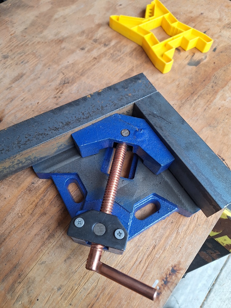

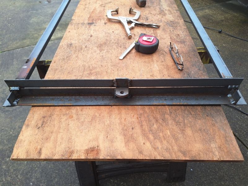

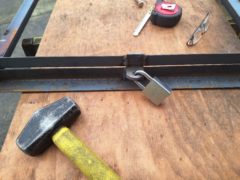

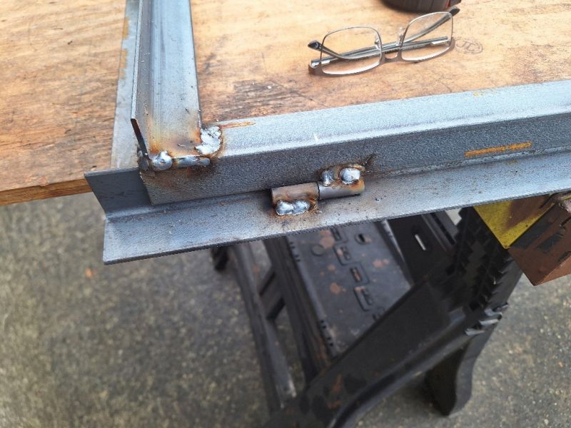

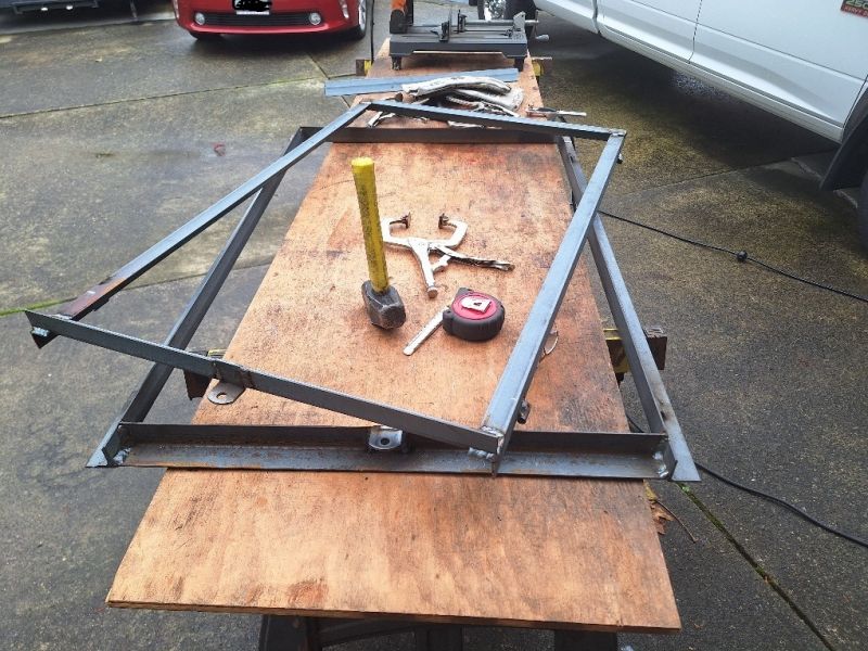

OK, finalized or nailed down my design, first one was a prototype, made a few changes on my design in my head. Went for simplicity, speed, butt joints vs mitered.
I wanted to keep it simple with little grinding/fitting.

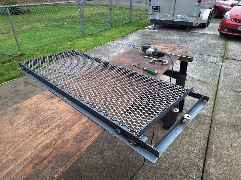

Got it. I used barrel hinges for the locking pins, not using them for a hinge, but a pin and a receiver for the pin. Set cover on, slide down into barrel hinges, install padlock.
After all built, I will have the expanded metal cut and weld it in place. Then paint to match cabin or a flat black.

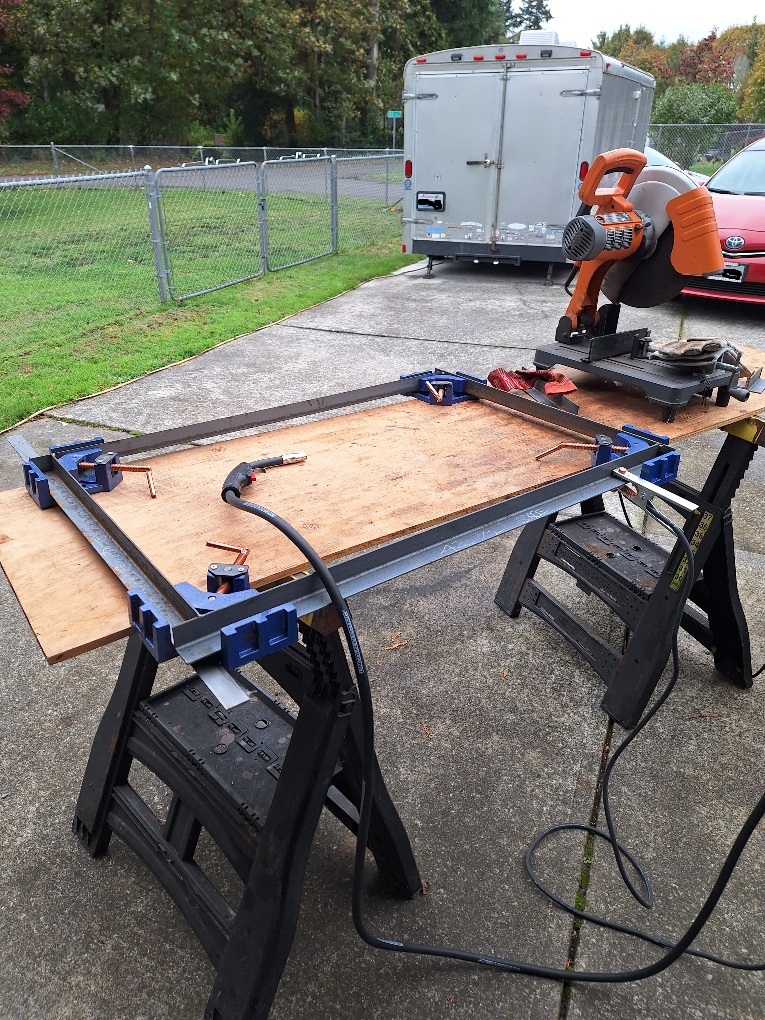

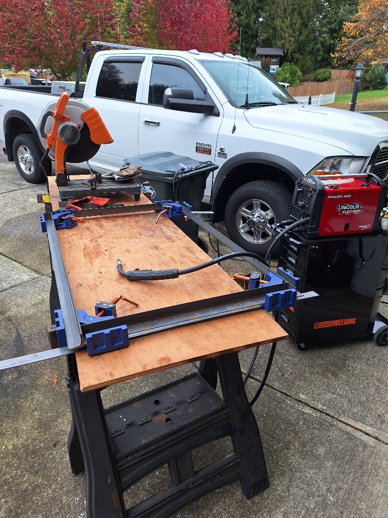

Went into mass production, came up a smidge short on steel. Pre cut all the frames I could, welded those all up, now more steel. The covers will be made after the frames are made.
I had trouble seeing on my prototype, glasses fogging and also weld helmet. I have ordered some anti fog spray, so should help. Weather was less humid yesterday and warmer, so no fogging.

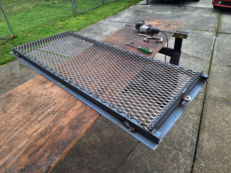

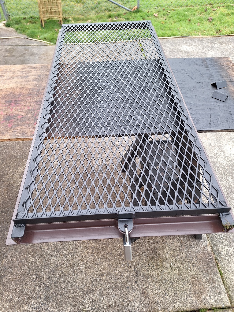

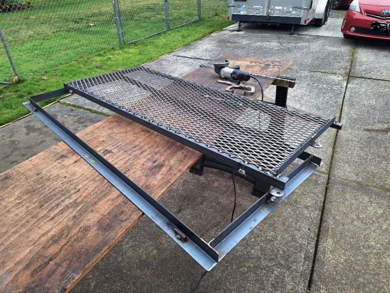

OK, got all window covers built, just need to pick up one more sheet of the expanded metal to cover the last 2 windows, other four are completed and even painted. Turned out very nice, easy to remove and install, provides great security, can leave them on when there and still look out, but one or 2 should be removed for an emergency exit.
Painted the frames brown or mocha to match cabin, covers in black. I used all Behr spray paint. Stuff goes on so nice, has primer built in and even dried fast on cooler weather.
The way this works is the lower frame bolts to cabin with secure ledger type screws. Cover slides over 4 barrel hinges, pin and on frame, cup end on cover. Set it over, slide down an inch and install padlock. Done.
I will put a membrane tape under the covers to keep moisture off the wood and in between metal and cabin siding.
I may hand a 1/4 cement board (underlayment type used in tile flooring) over the screen. Fire and blowing branches would be the reason.
