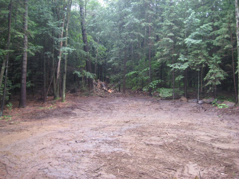

Barn Site on Our Land--We would remove more trees

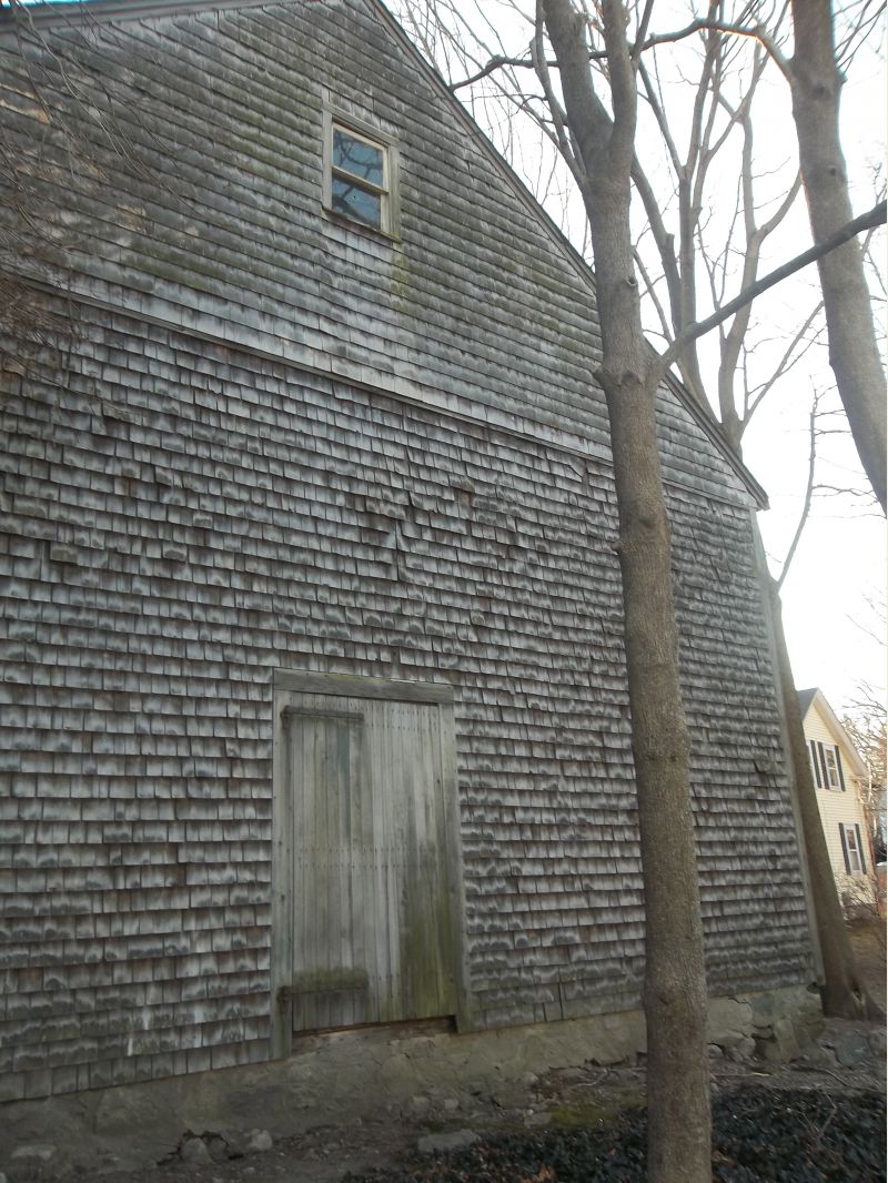

# Posted: 12 Feb 2012 09:11am

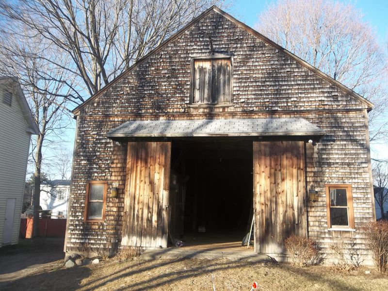

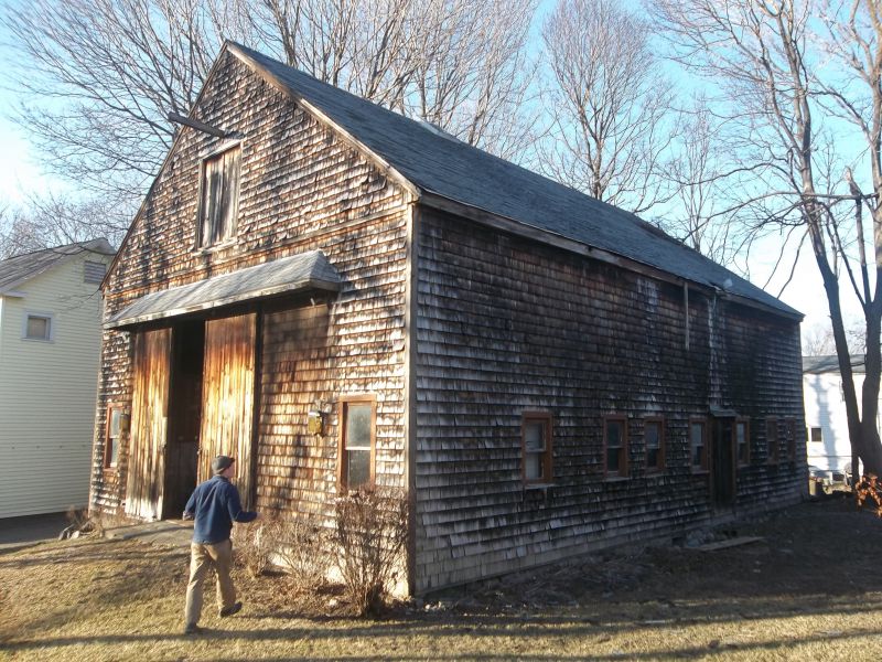

So, here's a photo of the barn. I may be back later today to measure and go in. If that's the case, I'll get better pictures later. This photo is not perfect, but you get the idea of size and general condition.
You can't tell from the photos but the driveway we would use to remove it is not in either picture, but is very very accessible and wide.

# Posted: 12 Feb 2012 09:42am
30X40 isn't an exceptionally large structure to move intact. Peak height is a major consideration. Assuming a peak of 16', by the time its on the dollies, it'll be 20'. If I had to take a rough guess as to cost of moving such a structure, I'd put it around $20,000-$30,000.
You save a bunch of work by moving it as a unit. Besides, if it wasn't built to be disassembled, which it obviously wasn't, you are in for some real challenges.
We had a 110yo house, 22X42, moved 6 miles twelve years ago. It cost us $5500. The house was on a rock foundation which made it easier. I had just rebuilt the framing, sheathed the roof and sides in plywood using 1000's of construction grade screws, and put on redwood siding ; so it was very structurally sound. For a foundation to receive the house, we built 28 rock piers which set on 3X3X3 concrete footings. 4X6 beams were placed on top of the piers before the house was set down. Total cost of moving the house, not counting labor since we did all of that ourselves, was around $10,000.

Tom, great insight. Thank you.
Unfortunately, I think it's much taller than 16'. Just from eyeballing it from afar, I'd estimate closer to 30' tall. If it only cost $10,000 to get it done though, I'd be a happy man, that's for sure. Like I said in the first post, my uncle has great experience with barns being taken apart and reassembled so I put a lot of faith in his skills.
I'm going to go see it in about an hour and get more specific measurements and pictures. I'll be sure to share.

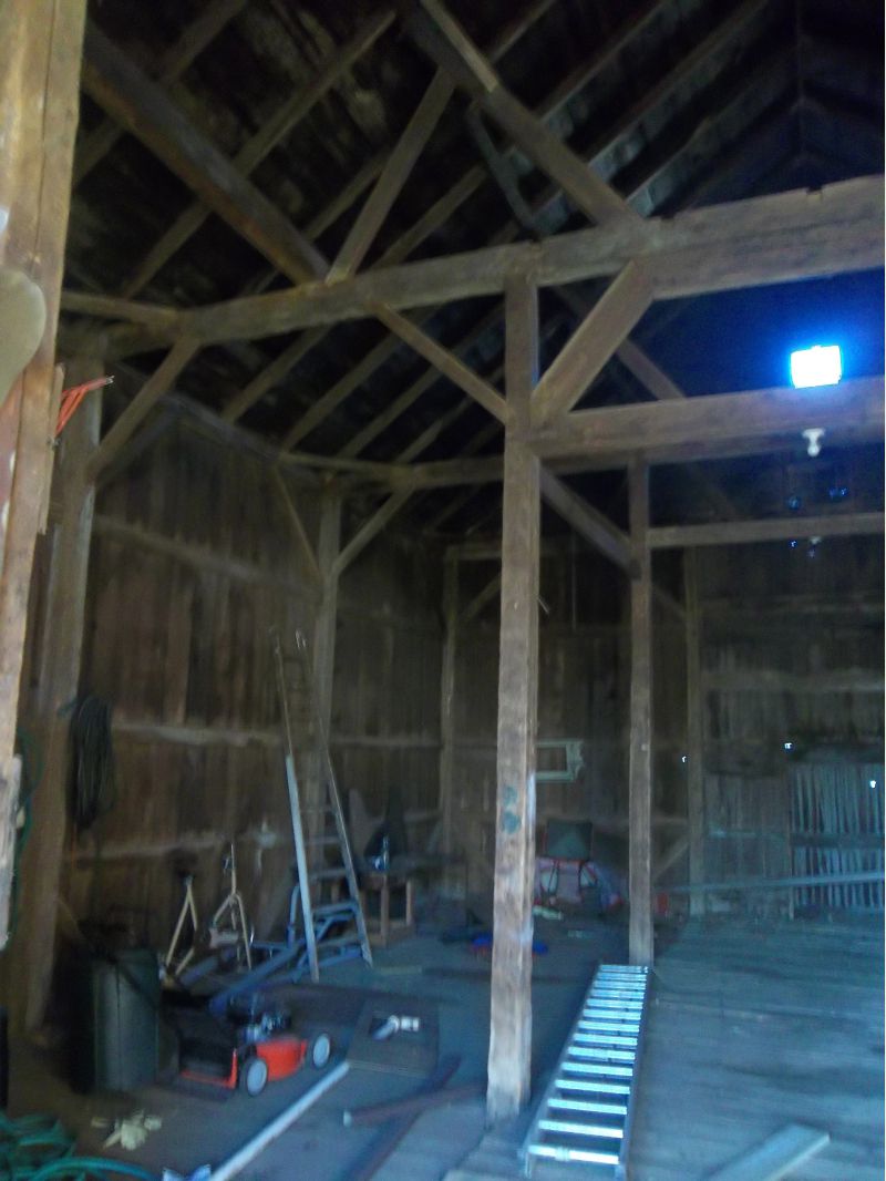

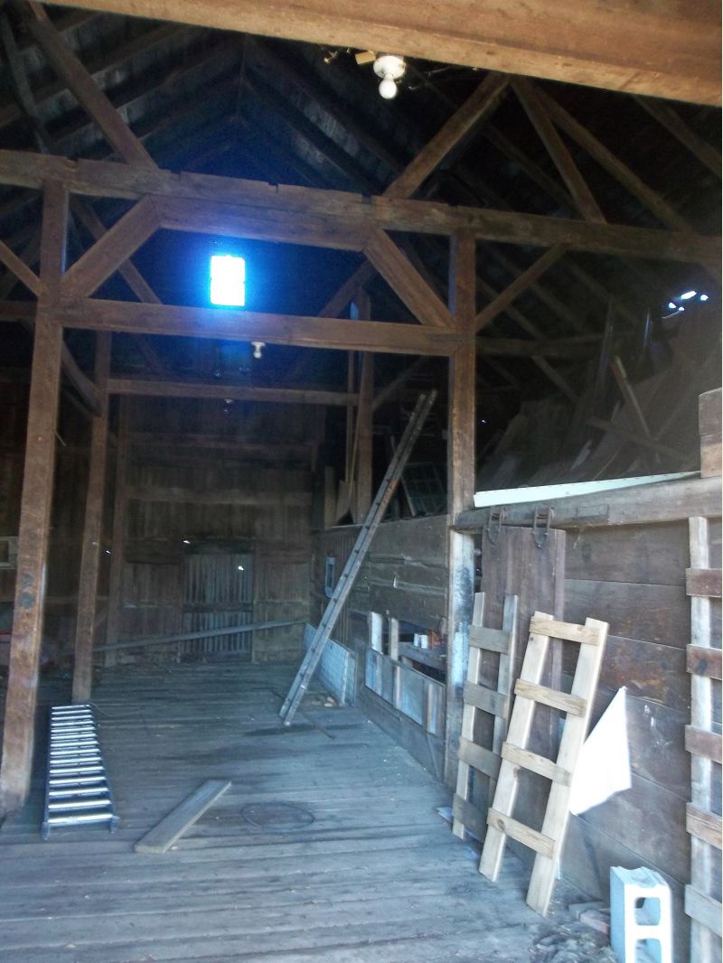

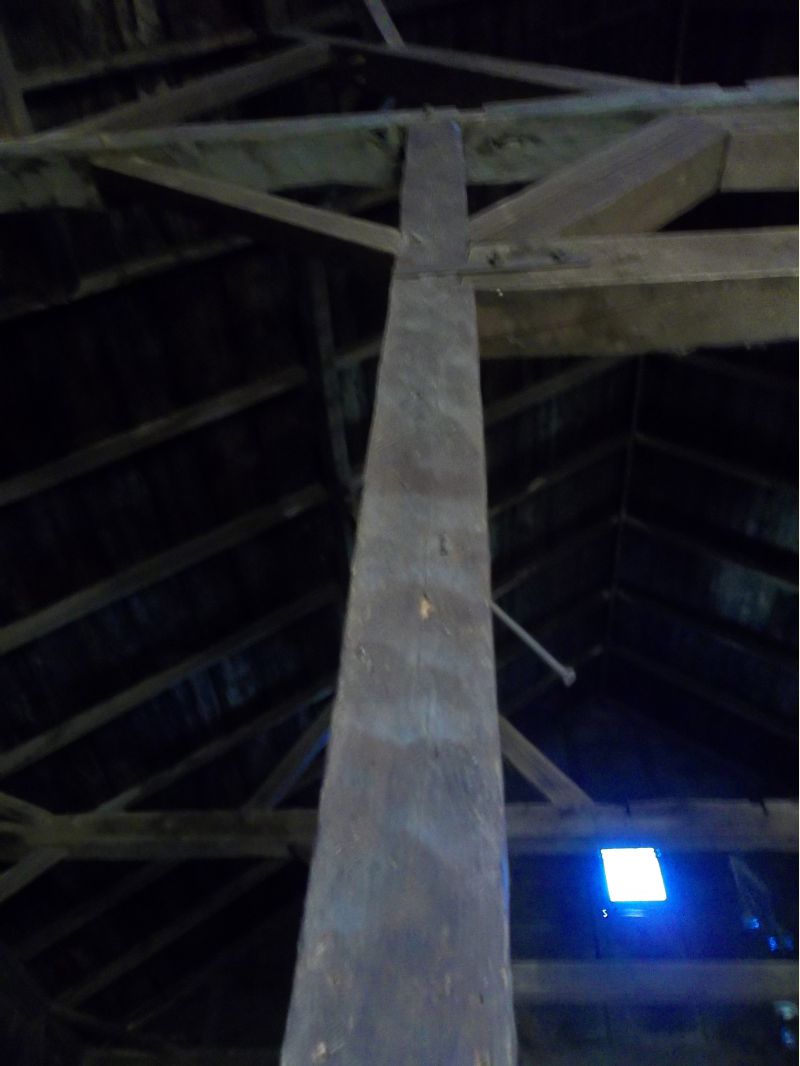

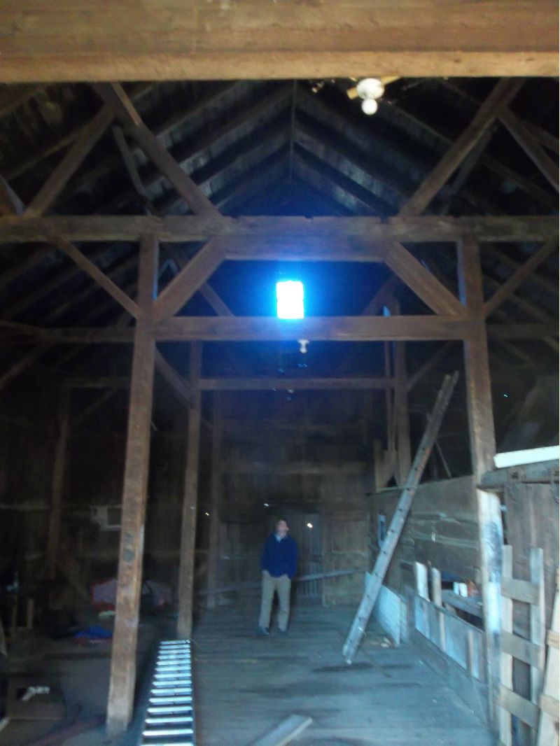

OK, so I was able to check out the barn more closely. It turns out it is from the 1600's!!! But, it has always had a solid roof over it so it has done pretty well.
Dimensions are big, almost too big for my liking. About 33x49. But, we figure we could (if we wanted) shorten the length by about 12' as we could just remove the last section.
It is in very good condition for a 400 year old barn. Here's a few more pictures. This would be a big job. Maybe too big, and maybe cost too much. Not sure if it's worth it, but it's very very enticing.
Front
Front
Inside
Inside
More Inside Woodwork
More Woodwork
More Woodwork

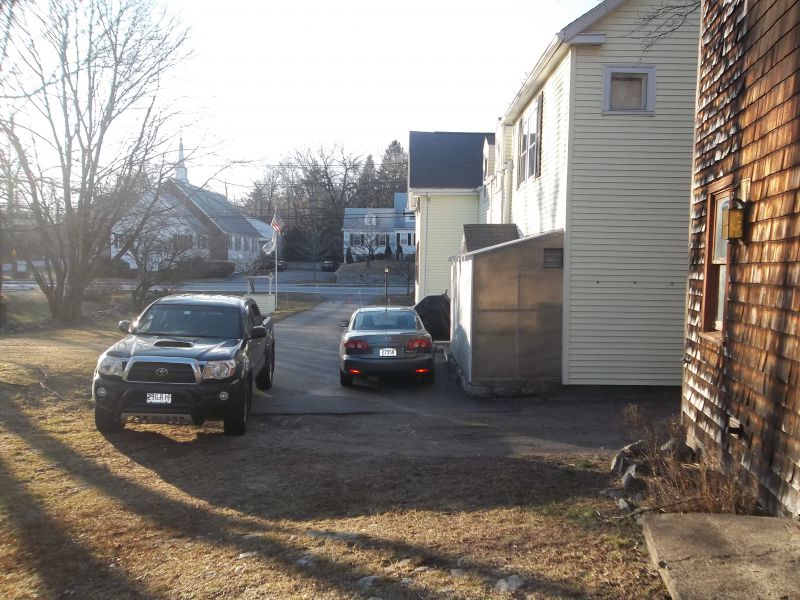

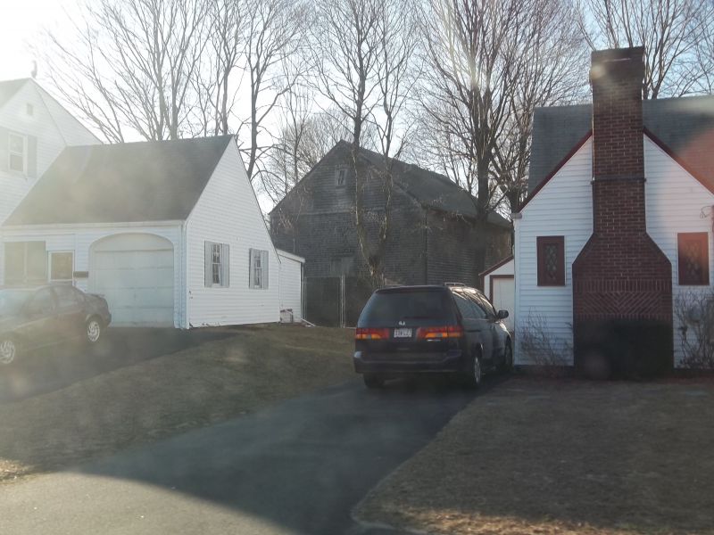

sabiggs
# Posted: 12 Feb 2012 08:03pm - Edited by: sabiggs

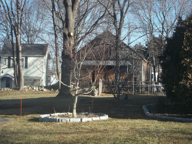

And a few more
Post
Post
Back
Back
Front
Front
Driveway and Street Access

The old beams in that barn would probably pay for much of the cost of building your cabin. They are highly sought!

These timber framed barns are unique opportunities. To move, they have to be disassembled, cleaned up, repaired, and reassembled. However, if you ever seen one these restored. Man, that is something.
This means you take everything apart, pull evey trunnel, mark all the pieces like puzzle so that you can put her back together again.
