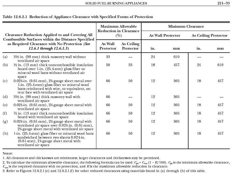

Recently purchased a 20x20 in ME that was around 75% finished. I have since finished the loft, installed new steel roof, changed out stove pipe and nfinished walls withi V groove pine. I am very excited and looking forward to some great family retreats. It is on a "floating" slab and I would love to finish the floor with something, but need ideas. It is NOT smooth and has a rather rough finish. Boards would be great, but I worry about air flow. Very informative site and looking forward to learning more. What do you think of surrounding the wood stove with Dura rock with a 1" spacer for ventilation? I think it should be safe?

sounds like that should work for the wood stove to meet the code, see the attached file.
