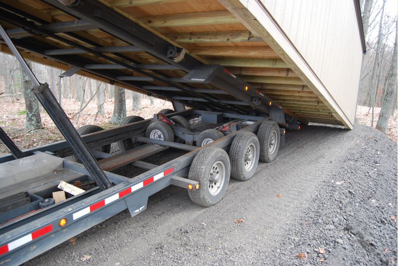

 Here are a couple examples to consider.  As you know, my cabin is a 14x40, amish built shed.  It was built in a warehouse, and moved about 20 miles to my location.  The width and height wasn't so much of a problem, but the length was.
 1.  Moving a cabin 40' long required a special trailer- to get it through the town where it was built and to turn it on some of the smaller, country roads (there is a reason why fire dept. ladder trucks require a tiller in the city).  The open road in between was fine, but both ends were tricky.  This trailer was special in that it  had a second set of wheels, mounted at 90degrees to the standard road tires, that were electrically driven (see picture below).  The driver could stop the rig, remotely lower these second wheels on the trailer, and move the trailer left-or-right without having to jockey the entire rig.  I would never have gotten the cabin through some of the country roads without this feature.
 2.  Along the way we also nicked a bridge (thanks to a sharp turn in the road just passed the bridge), but fortunately the bridge was steel so it only just scratched the paint- paint that was even already scratched.  The cabin did require some repair to about 3' of T111. We also required a telephone contractor for one turn to lift some telephone lines because when the trailer went around another tight turn, the back-end would have swung too far off the road and tore down some low telephone wires.
 Moving a big cabin is not insurmountable, but get a few people to move it WHO KNOW WHAT THEY'RE DOING.  This job is not for amateurs.  The crew I hired mapped out and drove the route before hand, identified all the possible issues, and provided advise and services on how to overcome them.  We even knew the bridge was going to be close, but there was no way around it and again knew any damage would be minimal.
 |  Transverse trailer wheels- a God-send for moving large items
