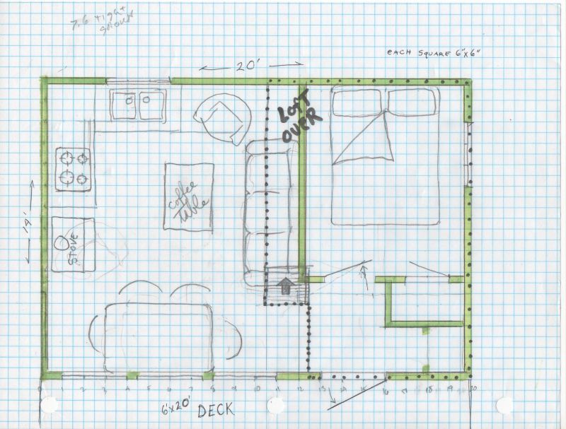

 I have a small cabin to build , but for once the customer wants me to do the floorplan. I don't do many and they want a bedroom for a queen sized bed, 2 closets, some counter space, a wall heater, a couch and love seat, a table and a loft. I can't seem to do it in a 14 x 20 cabin. I hate to admit it, but I don't have any ideas. Here's the one that came close.

 Looks great! I can't image anyone would want so much in such a small space. I would get rid of the chair, add the wall heater in its place and put a love seat sized fold out bed in the loft. There is a lot going on in there.

 Can the loft also function as the bedroom? Our space is 10 X 20 and originally we were going to have two small lofts on each end for overflow bunking with a bedroom on the main floor. After much discussion we opted to expand the loft and use it for the bedroom.
 In our layout the kitchen area is tucked behind the stairwell. We will have a full hight closet under one side of the stairs. With a 14 X 20 structure I would expect that you could include a closet in the loft area.
 That would leave plenty of room under the loft for a couch, love seat and table.

 They need the loft for the kids. I'm checking out all options at this point. Thanks for the tips.

 Here's something I've been messing around with.  I don't have any land as yet and these are very preliminary but I figure it doesn't hurt to start planning now.  It's 16 x 20, baloon framed for more room in the loft.  The 8 x 8 wing could be built at teh same time as the main cabin or added on at a future date.  This design satisfies all my wife's requirements (with the 8 x 8 addition) which are, a first floor bedroom, a small kitchen, an indoor bathroom, some storage space in the addition to name a few.

 I would guess your going to build on posts? I try not to have additions that aren't supported by the same beams.

 I hadn't thought that through.  I was leaning toward skids but now you're making me think.  Like I said the plan is very preliminary and I have lots to think about.  That's where you all come in

 At that size and with all of those requirements the extra 4' of the Nash cabin makes a huge difference.  Is there any possibility of bumping up the size?

 Spans up to 14' on 2x8 floor joists seem to work fine. If you pull skids under the building by a foot on each side , makes a 16' wide just fine on two skids. The length shouldn't be too long on soil that can move. Soft wet soils are bad. Wet soils that freeze are the worst. You can build skids from laminated 2x8 or 2x10 three or four layers wide with staggered joints. I like to stay under thirty feet here in frost country. I never use a center skid as frost lifts all skids, but a center skid stays up until last and can damage your cabin. Two skids never do that.
