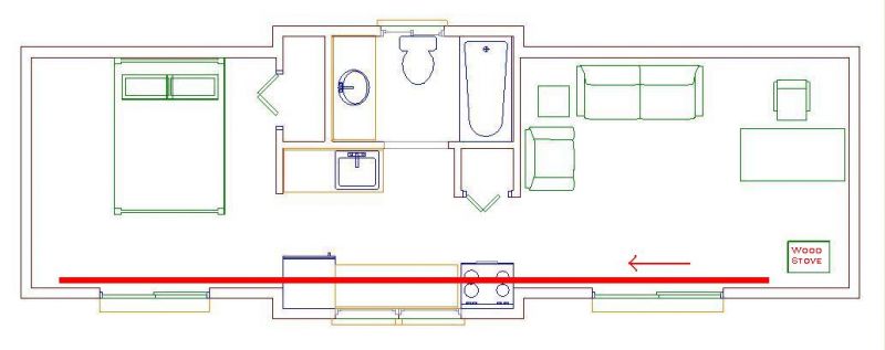

Our current cabin plan is for a long 12'x40' cabin to maximize the view we have. The wood stove will be at one end of the cabin. I need to move some warm air to the other end so I plan to install a 35' long, 4'-6" heat duct near the ceiling with a duct booster fan to move the air. That's the plan, hope it works.

# Posted: 13 Jan 2011 01:53pm
Reply Quote
Sweet MikeOnBike!
