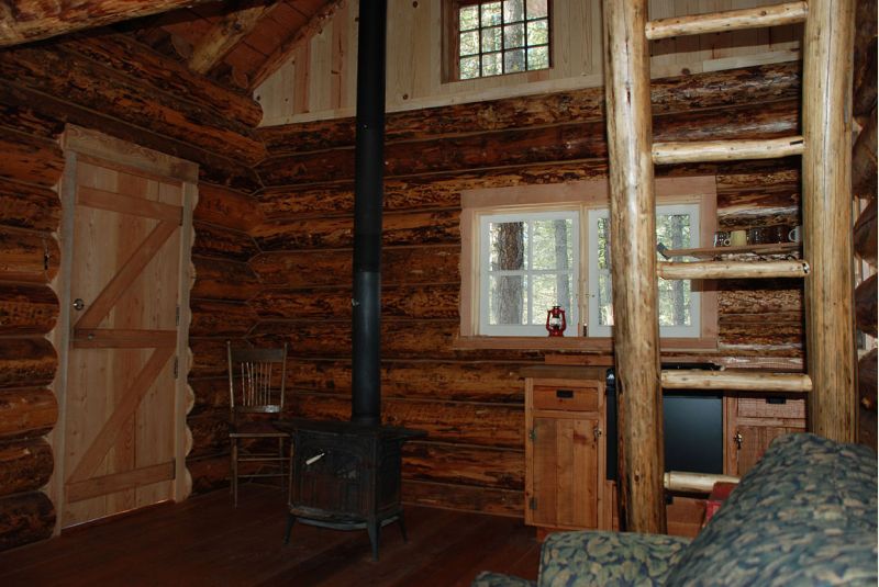

There are a lot of variables here, not sure what to ask, but will appreciate tips. I'll continue to stop the cold air coming in.... One thing I know for sure is that cabin-folks like to see pictures of woodstoves....
The new stove, Vermont Castings INTREPID (~1980s?)

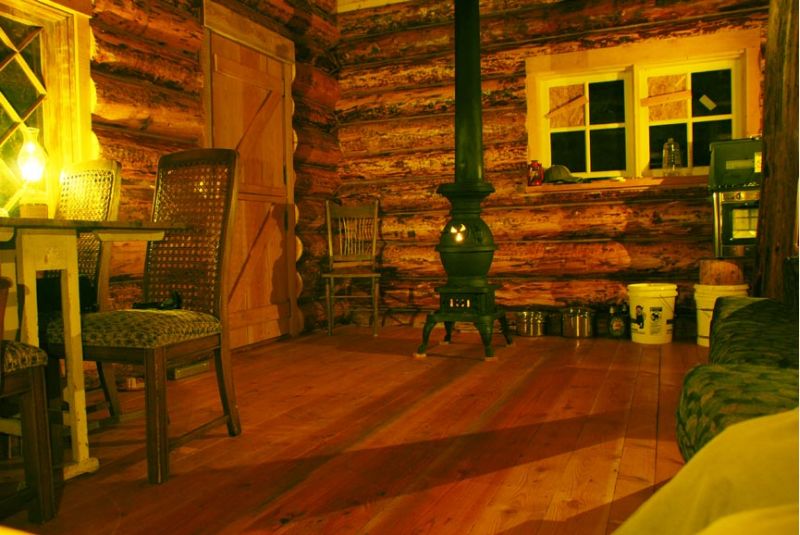

Everett Stove Works, No44 (~1940s) - removed, too small.

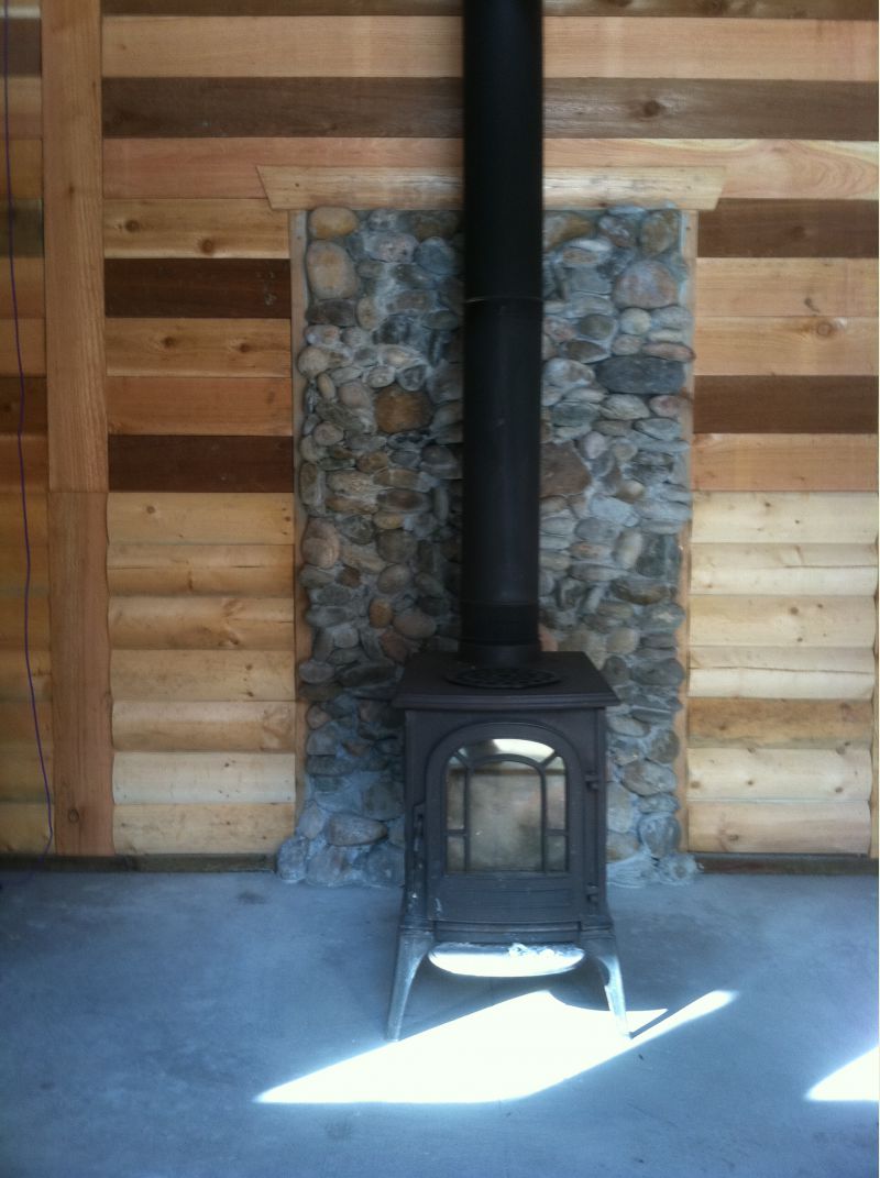

I have a Lopi Republic stove I paid $100 and though I'm well aware it's like six times the size I need for a 8 X 12 cabin, I'm contemplating welding up a small grate and lining the sides and back with additional fire bricks.
Thoughts?
# Posted: 21 May 2011 12:46am
If you put in more firebrick you will probably have more of a delay in getting heat flowing into the room. At the same time the extra mass will hold heat longer. That may be a good thing. Might be worth a try if you can do it in a reversible manner.

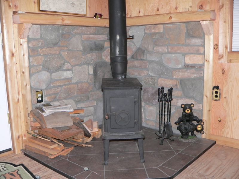

You can just see the corner of the stove. It's a large stove, but I havent needed much of its capacity to keep the cabin warm. Bought it at a yard sale for $300 used.

Love the bears.
