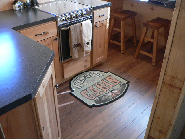

# Posted: 19 Jan 2015 10:38pm
Round and round we went on flooring. Decided on a cork floor. It's t&g lock in place. It has a 3D imprint of a wood plank. Used in commercial applications(restaurants and museums) and residental. Like the cork because it can be installed on a sub floor,has insulation built into the plank, it will be warm and cushioned(unlike a wood floor,our first choice).

Toyota , I was just worried that muddy boots (dogs too) would damage the floor if it wasn't waterproof. I have laminate in the basement at home and a bit of water (from a freezer leak) damaged it somewhat. I really like your laminate floor! Silverwaterlady, is the cork a lot more cost than something like laminate?
