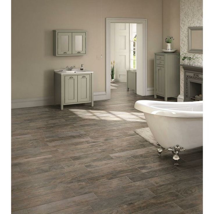

Decided on the porcelain wood look tiles at HD for the mud room and bathroom. We designed our cabin to have a mud room at the back door that leads into the bathroom. So if the outhouse is in use one can come inside and use the facilities without removing shoes.

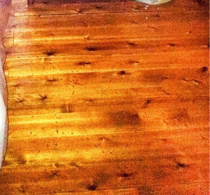

The remainder of the cabin will be the same flooring we used in the loft. Wide plank white cedar. It is indigenous to our area. A farmer we know in a nearby town cuts it from his acreage and kiln dries it. The price is up to 80 percent less than we would spend Online or at a box store.

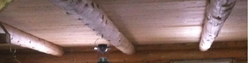

Steve_S brings up a great point. The cost of our loft was minimal due to the floor being laid on the joists and being part of the ceiling. The beams were cut from our property.
