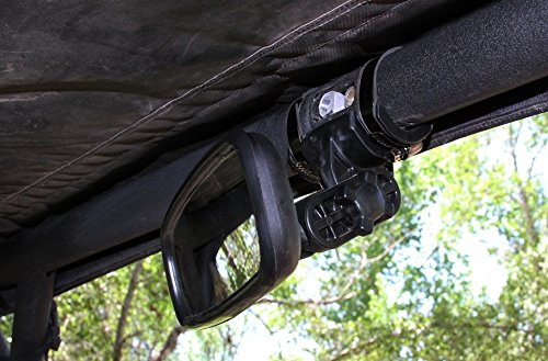

 Quoting: turkeyhunter cant decide which one to get ...looking on Amazon last night
  T/H, this is the one I got from amazon:
  ATV Tek (UTVMIRCTR) Clearview UTV Center Mirror
  Nice unit, fits right on the roll bar (ROPS)

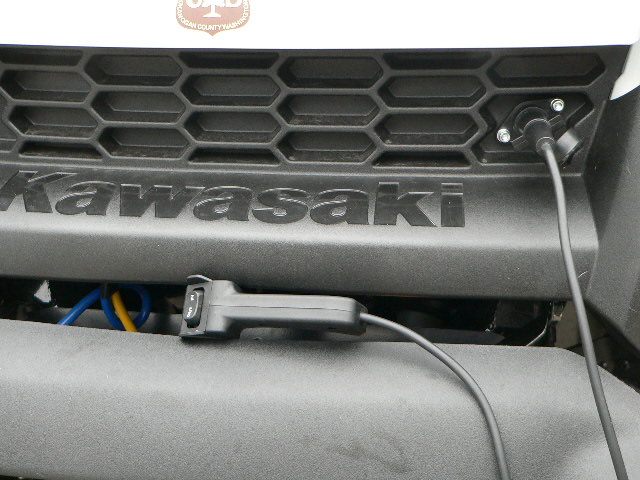

  Updates photos. I have been working on this thing for several weeks now. My last and maybe final project is to remove the rear add on turn signals and incorporate them with the rear running/stop lamps. I will have to wire in the turn signals other circuits to turn off left brake lamp when left turn is on.
  New, it came with one tail/stop lamp, mounted drivers side only. It looked lopsides. So I bought a complete OE Kawasaki lamp and all mounting hardware to add a RH lamp. Well, go to tip up the bed, it hits the muffler pipe and I used the existing holes in the bed. So I ended up moving the lamp to clear the muffler, this meant moving it further outward, but I didnt want it right behind the rear tires to take in a bunch of mud/road spray. Then I moved the other side to match it.

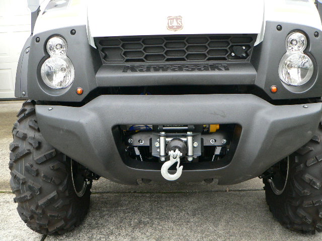

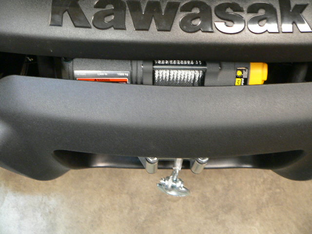

  Winch fully installed, I added a neat bumper, I call it a rubber biscuit at the cable end. Was a bear to get the cable loop through it, silicone spray made it an easier task.

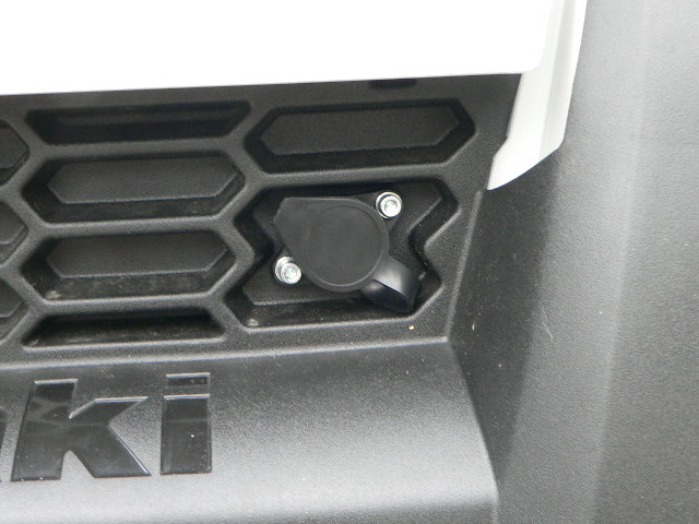

  I installed the remote hand control plug for the winch also. I have a rocker switch inside for in/out but needed to have one for the outside too. Really critical to winding the cable back in feeding ti across the spool/drum evenly. Once winched in for storage, I always leave the transmission for the winch in a disengaged mode in case it powered up or someone just pushed the button, it wouldn't tear itself up.

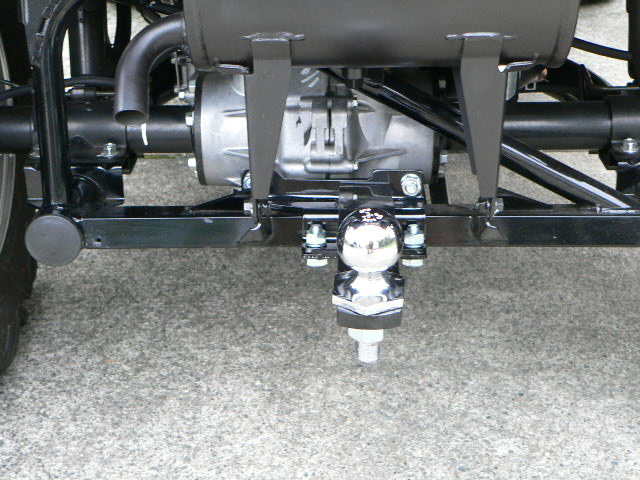

  I added the factory tow hitch, it was the best set up. Plenty of other designs for less $$$ but mounting was sub standard. So paid $140 for the OE unit. Pricey, but I only needed to do it once.

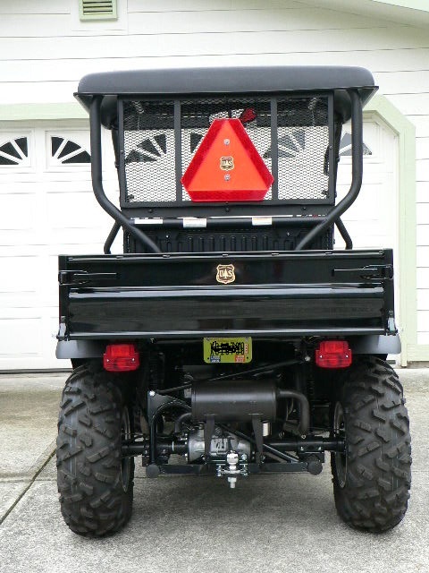

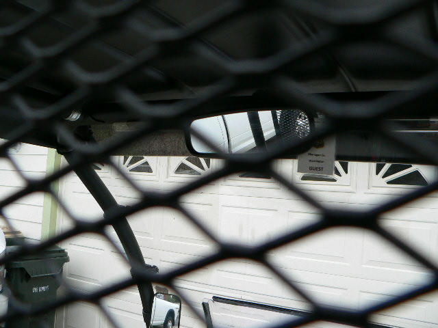

  Added the rear view mirror, slow moving vehicle triangle on the rear of the rack and a few more of my Do_uble J Ra_nch stickers.  back_view.jpg

  I will probably install some large rubber mudflaps behind the rear tires.  mule_hitch.jpg

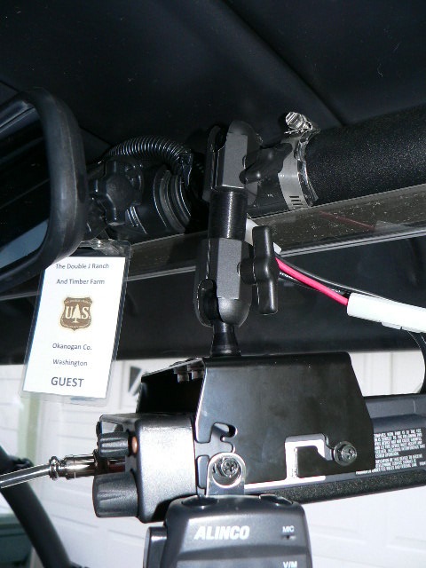

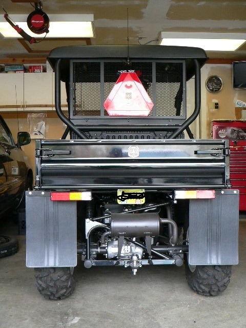

# Posted: 26 Jan 2016 11:38pm - Edited by: toyota_mdt_tech

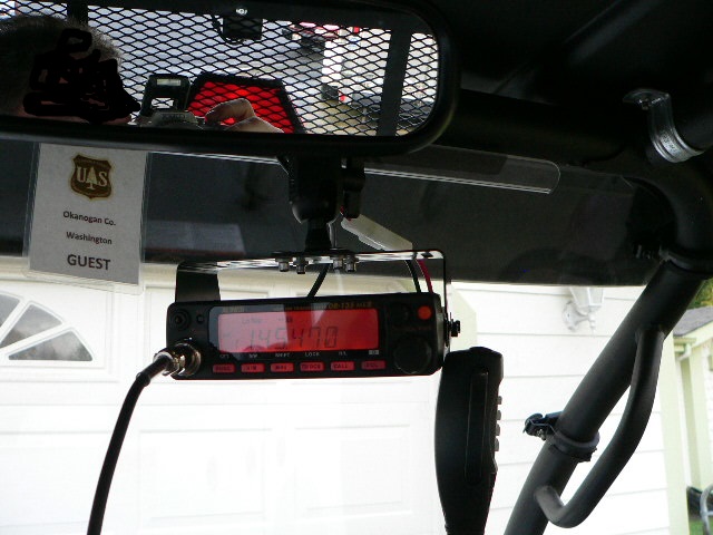

  Ok, added more modular LED tail lights for the street legal Mule.

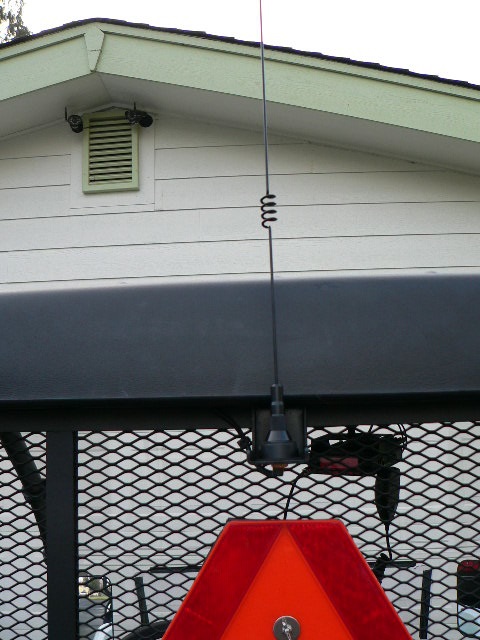

  I also added a 2 meter Alinco DR135 II ham radio. I used a 1/4 wave Tram antenna vs my favorite Larsen NMO 150B 5/8 wave. I wanted a shorter antenna for the heavier brush I may encounter.
  I modified a Panavise mount to secure to the rollbar for the radio and the antenna mount is home made, no drilling required to mount it, made it fit an existing hole.
  The rollbar/top unbolts and I used Anderson Power Poles to separate the radio power wires for easy top removal. The Mule has no "ACC" position on the key, so I wired the radio hot all the time. But the radio has an APO feature, ie auto power off if there is no radio activity in 30 minutes, it shuts it off preventing a dead battery. So I activated this feature. I am close to a local repeater at the cabin, so I have a radio range in excess of 40+ miles.
  I did find 2 neat dome lamps/reading lamps in LED that used velcro straps to mount on the roll bar, one for each occupant.
  I added the slow moving vehicle triangle. Its road legal, but has a top governed speed of 25 mph.
  I am looking into 2 large rubber mudflaps for the rear, i they need to support the flaps sticking out wider than the bed, but flex when hitting obstructions.
  I am done, there is nothing more I will do to this at this point. It heads to the cabin in April.     modular LED tail lamps

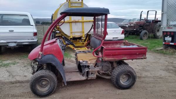

  Alright, so here it is- a beat up old Kawasaki Mule with missing fenders, was smacked into immovable objects by joyriding farm workers, needs a new seat but supposedly runs well. He wants $3000 OBO. Is that a good deal?
AK Seabee
# Posted: 28 Jan 2016 12:41am
  If the exterior is abused that bad I would not trust the motor, axles or tranny. Thats my two cents anyway.........
# Posted: 28 Jan 2016 01:32am
 Quoting: bldginsp Alright, so here it is- a beat up old Kawasaki Mule with missing fenders
  bldginsp, I was looking at craigslist for used and I seen way better than that  for around the same price. Also, there is rental places that rent out heavy equipment, up here, called Star Rentals/Equipment and they had a bunch used for sale in good shape. Prices varied from $3500-$5000. They had Mule 610, 4010, Kubota and Polaris Rangers.
  That rig IMHO is worth $1500 max.

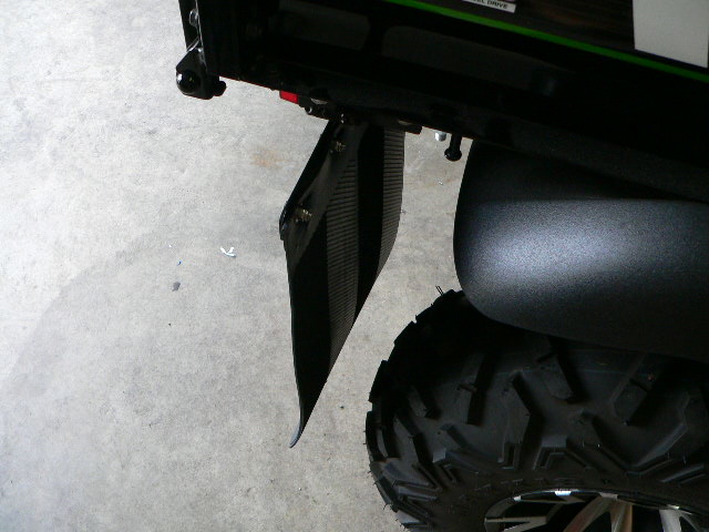

# Posted: 14 Feb 2016 01:10am - Edited by: toyota_mdt_tech
  OK, final modification. I can not think of anything else I'd like to do. Had it since last summer, drove it so far, about 2 miles. Its cabin property ready now.
  I added large mudflaps in the back, 12 wide, 18" long.
  I may spray in a bedliner. It has the rubber mat in the bed now. I may also add a chunk of plywood to the tail gate for a nicer work surface.  mule_flaps.jpg

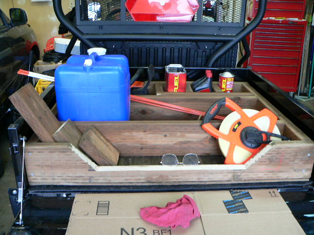

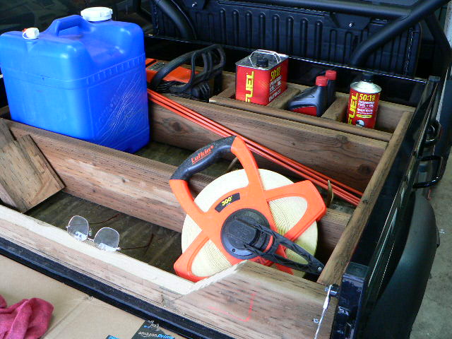

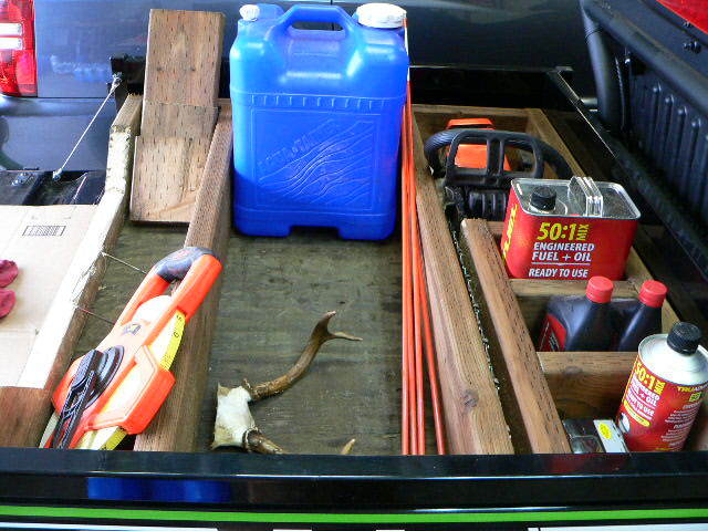

  OK, been a while and really no modifications left, but I did make a compartmentalized box that fits right in the bed, used all treated wood, floor is 1/2" treated plywood. I will almost always have my Stihl 026 with the 20: bar, some gas, either the gallon can or the qt gas can, couple of bottles of oil and file with bar tools.
  Second compartment in the middle will hold 3 of my 8 gallon water jugs. It will hold my Honda generator and a gas can and the rear compartment can hold misc items. The middle and end rack will change contents, but the saw will be almost a permanent part of the Mule.  mule_rack01.jpg
