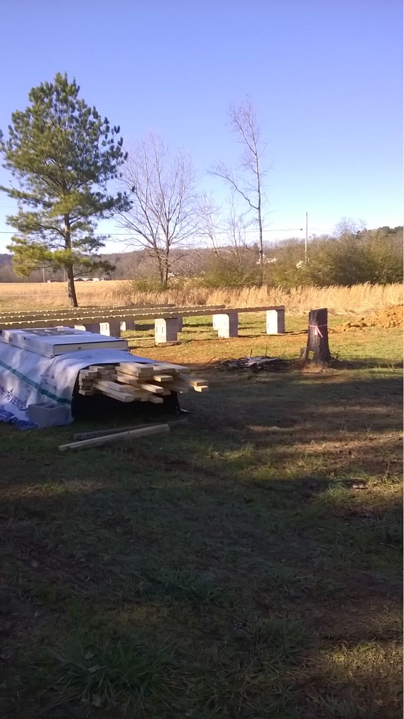

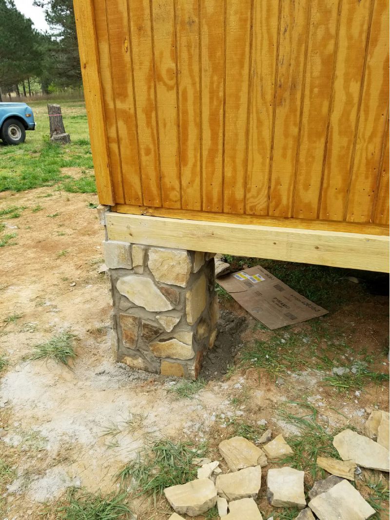

Great! We did an onsite build 16x32. We had it put on piers as per flood easement for the lake. We will next rock around the piers then build a full covered porch on the front and back. Add windows, French doors and start the inside. It's an exciting process, but not a lot of time to invest. Hopefully have it mostly complete by the holidays. Congratulations WP_20160117_12_46_59.jpg

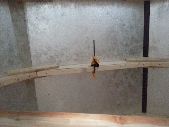

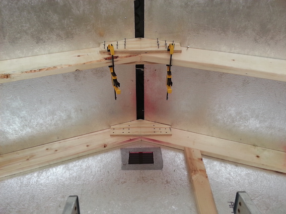

Thank you! I already added corner studs for the flat ceilings under the lofts and for the long walls. I made up truss plates for the gambrel trusses to strengthen them and prevent the strong ties from walking themselves out over time, and now I'm cutting truss extensions to increase the depth to account for 3/4" foam sheathing in addition to 5.5" of Roxul rockwool insulation.
I will not be wiring up the gambrel roof, as I have decided to use puck lights with rechargeable batteries for the gambrel ceilings in the loft areas, as that will be storage areas, primarily.

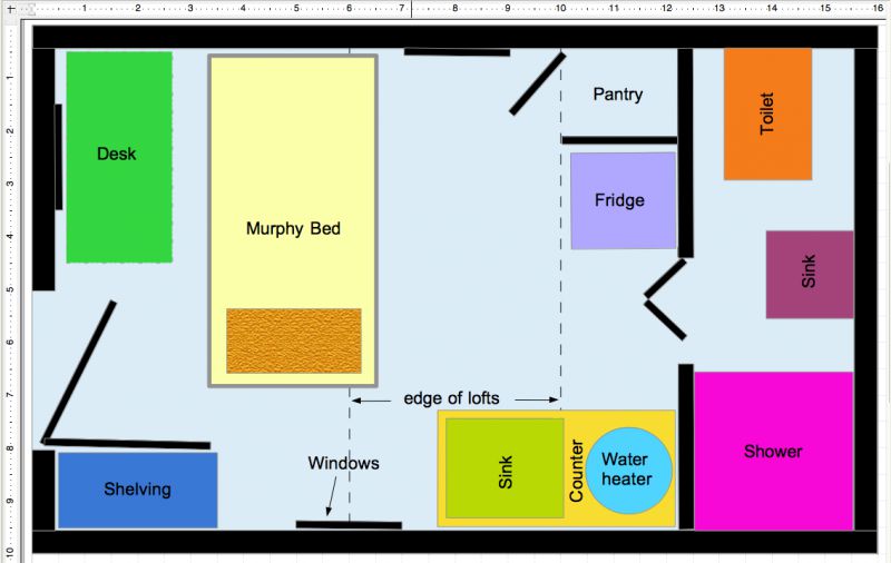

This is the current floor plan so far.

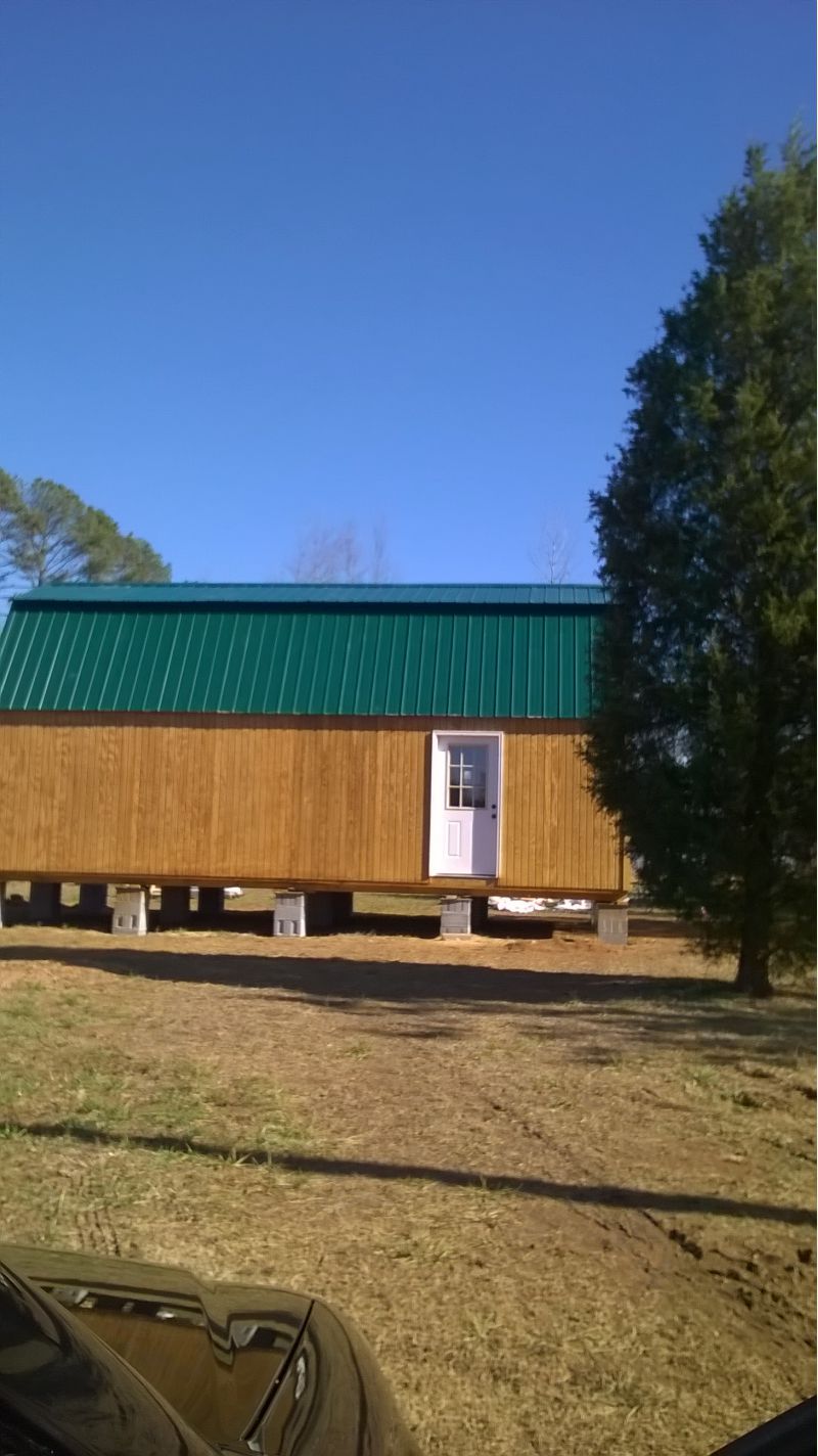

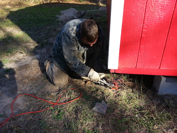

The cabin was anchored the week after it was delivered, as the driver's anchor machine was broken.

# Posted: 17 Feb 2016 12:35pm
I put up these truss plates, 48 of them! The first day was rough, no knowing how to leverage my body against the trusses behind me to drive the screws in a lot more easily, but the second day, I figured it out and was able to go running after each day of truss-plate installing, about 16 per day.
