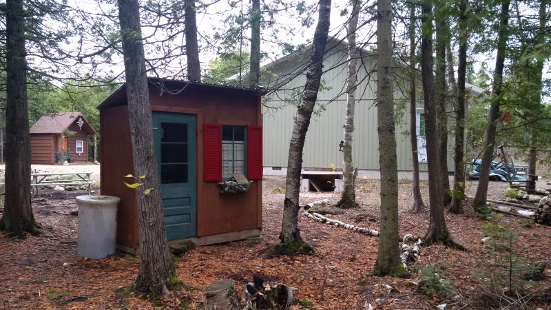

You can learn more on pg.2 of my thread on Members Projects - My 100 sq. ft Cabin in Southwestern Ontario - Lake Huron.
I had 70 acres around Lindsay (Balsam Lake) and got rid of it because of the standard rules...no building a shed until you have a habitable building...has to be a minimum of 1000 sq. ft etc...must have a septic system, etc. I bought 2.2 acres up on the Bruce and the rules are the exact same, though I've yet to hear about 2000 sq. ft as the minimum...usually 1000 sq. ft. This is why so many folks are trying to locate in unorganized townships...but it is only a matter of time until the local municipalities catch on to the potential $$ they could be charging. I built a 100 sq. ft Bunkie anyway...and made sure I was great pals with my neighbours...didn't have an issue for years...My wife and I recently had a 1000 sq. ft cabin put up, but just the shell and I will be building it out for the next five years...as $$becomes available. Unorganized Township options are a great, if you are in the position of not having to drive 6 - 10 hours to get there. We weren't prepared to do that...it's all about what fits for you. I live in Lambton County (Sarnia area) and can get to my place in 3.5 hours.
