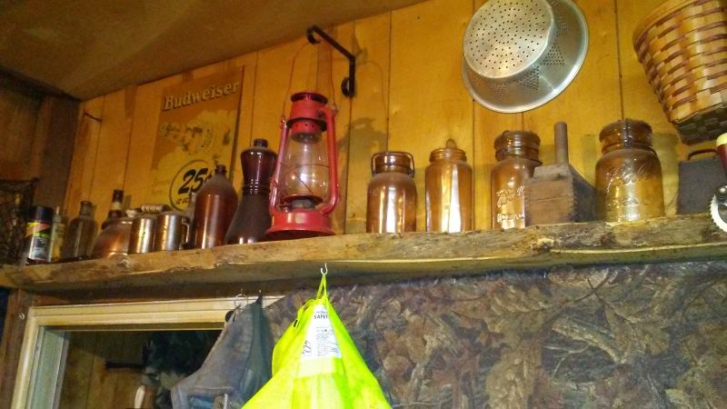

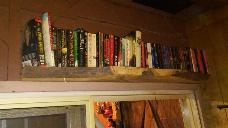

We have a few of these "Live Edge" shelves.

Wow. Those are just beautiful and exactly what I am looking for. How do you attach them? Just nail them on to the window ledge?
# Posted: 23 Nov 2018 07:30pm
You can screw them in at an angle if you pre drill a pilot hole. You can also hide a smaller bracket on the ones up high. That will help make them stronger, and prevent them from pulling away from the wall.
I am making a smaller thinner version to use as an actual window sill.

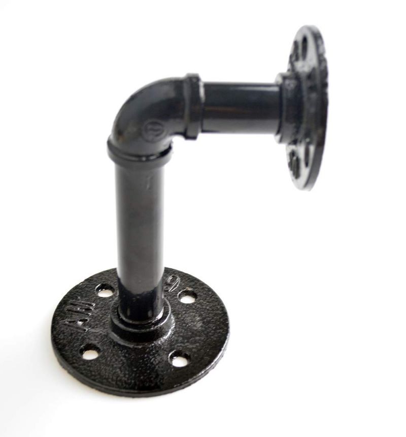

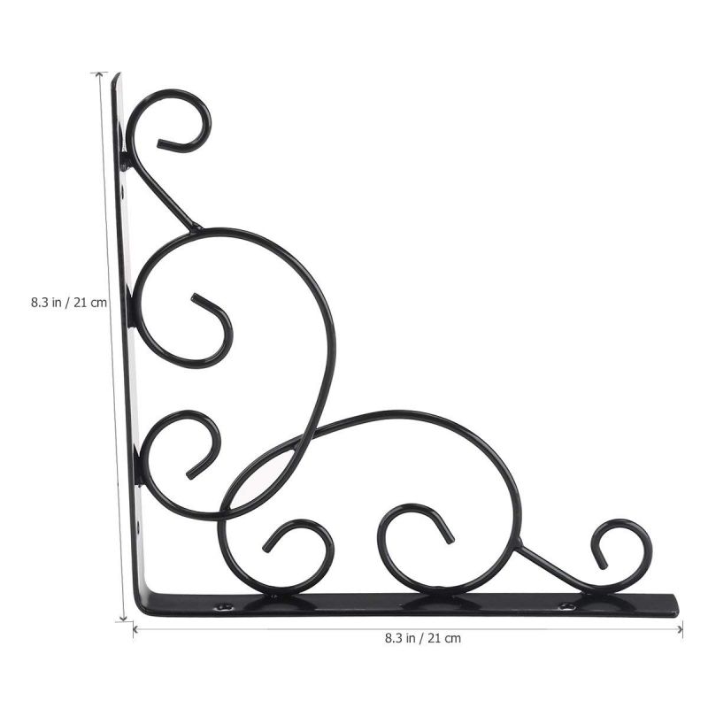

Here's some different brackets. You can put them on top or below the shelves.
Small brackets
Small brackets
Wire bracket
Wire bracket
Steam punk look
Steam punk look

Add a cantilever board to the top of the shelf with those brackets if its going to carry weight. Poplar boards are very stable and stain/seal well.

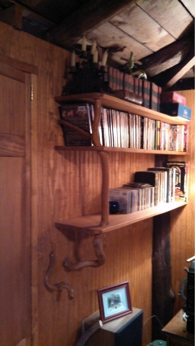

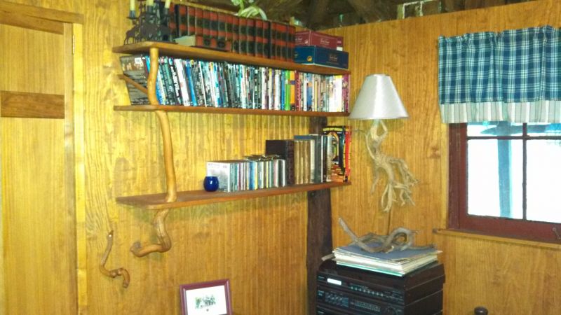

Here's one of the shelf sets in my cabin. Just basic pine boards, the supports are mountain laurel, all stained to match the walls. Sorry for the crappy pictures, all I have... the yellowish picture is in better focus but the reddish picture is closer to the true colors.

The live edge with branches is just SO nice. Thanks gentlemen for some great ideas.

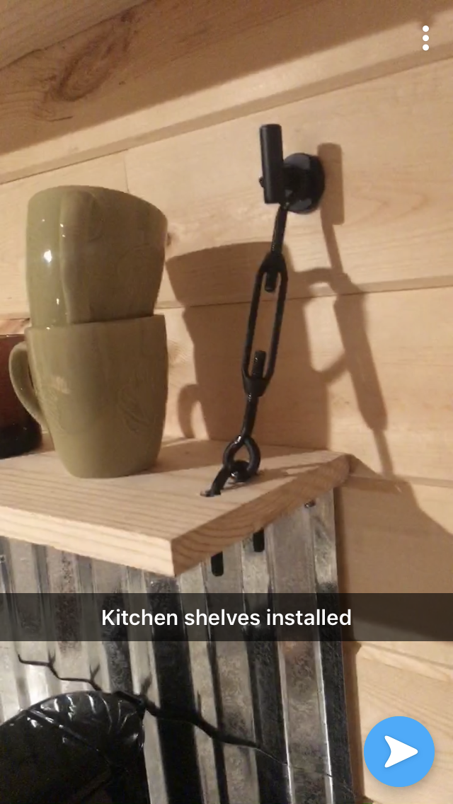

my wife saw this on pintrest so we did it in the kitchen, turned out nice in our opinion.[img=null]null[/img]
So very nice.
Thank you.
