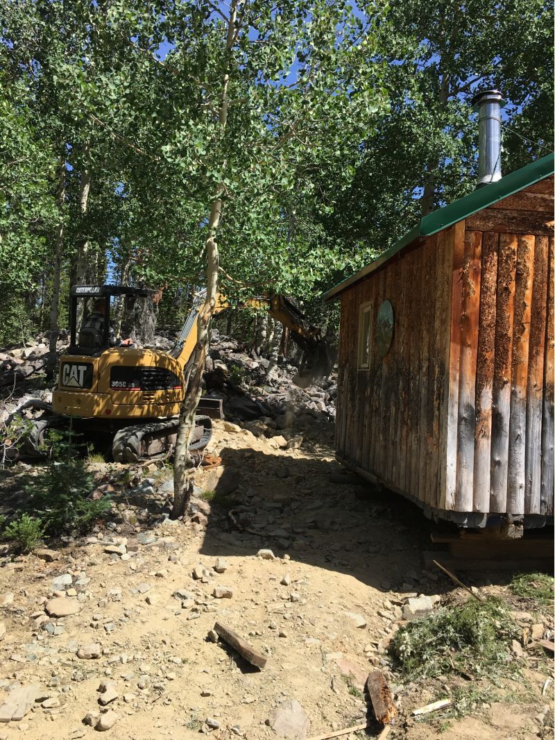

Here is my Massey and Cat...I was moving my small cabin with the cat. I had to build a pad back in the aspens and move it.

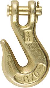

Use this for your search, "G70 rated chains, binders and hooks 3/8" shows up everything. Chains will have hooks, they are 20 feet long, if you can cut it in half, grab some hooks and make 2 chains from one. I was able too. Just make sure the hooks are the "grab type" for hooking on chain links by locking on a link.
Chain and hooks are all cad plated and about every 3rd chain link reads "G70", your state patrol checks this.
The 3/8" hooks will lock on to a 5/16 chain also, but for your tractor, get all 3/8" chain.
Also, each implement needs to be secured, but a yellow ratchet strap across the front end loader, is acceptable. I run one across my back blade too. This isnt critical unless you are commercial, but if you have an issue, this covers your butt.
Grab hook vs clevis hook

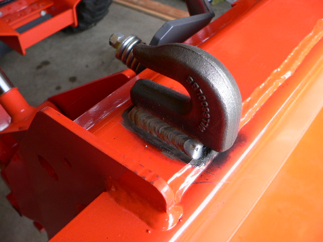

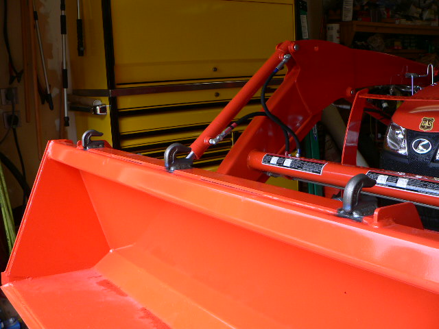

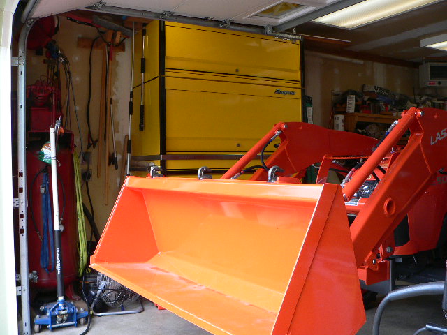

Oh, a must have, get weld on chain hooks for the top of your bucket on the front end loader, a must have deal.
Just use G70 weld on hooks, pick 3/8" also in Amazon search. I put 3 on mine, 2 right in line with bucket curl ram for max torque without bucket deflection and one in the center.
Of course, I bought some genuine Kubota orange paint and painted it, looks like it was always there.

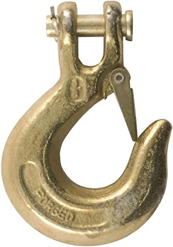

G70 clevis hook with latch

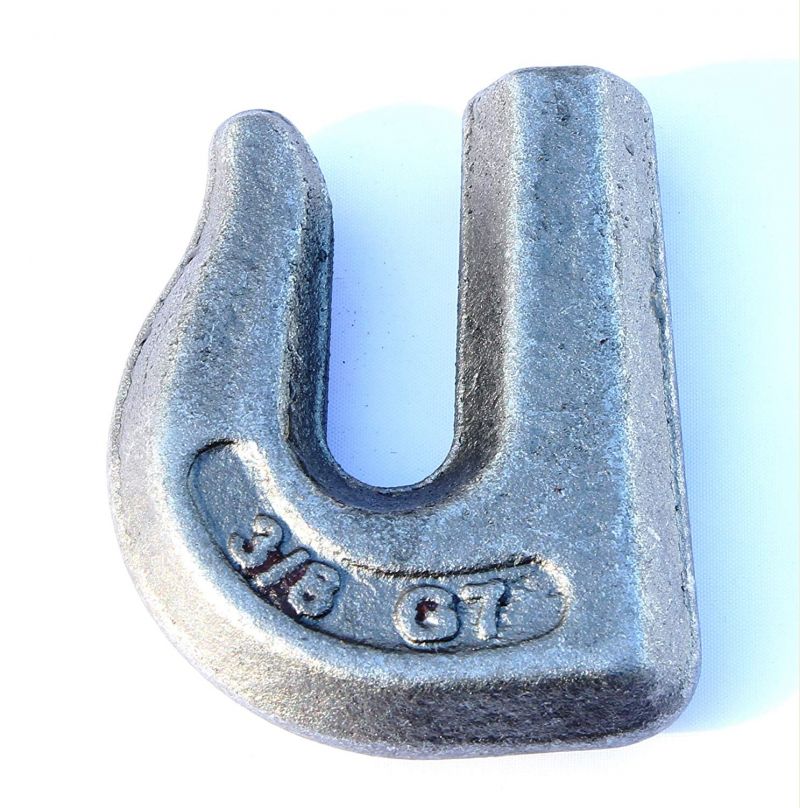

Weld on hook
Weld on hook
weld on hooks
weld on hooks

The final product minus paint job.

Toy: your hooks on the loader are just what I need for moving logs.

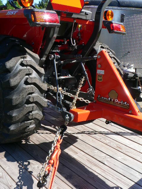

Dave, as long as you have the welder out, I assume you will haul tractor on a trailer to and from property, grab some of those 1/2" weld on D rings, rated for 12,000 lbs. Good news is the 3/8" grab hook will slip through the inside of the D ring making lashing tractor down easy. I put these every 2 feet down each side of my trailer. It came already with 2 across front and back for tying down a car, I just wanted more lashing options. Makes it easier to lash down lumber, pipe and grab weld on stake pockets too if your trailer doesn't have those too.
You can lash down tractor using just stake pockets too, drop hook down inside pocket and hook from underside. But if it gets loose, it could drop down and come unhooked.
Hey, welder is already out, what the heck...

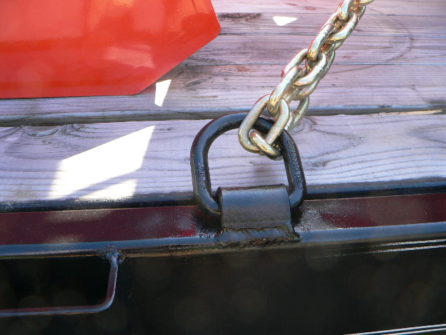

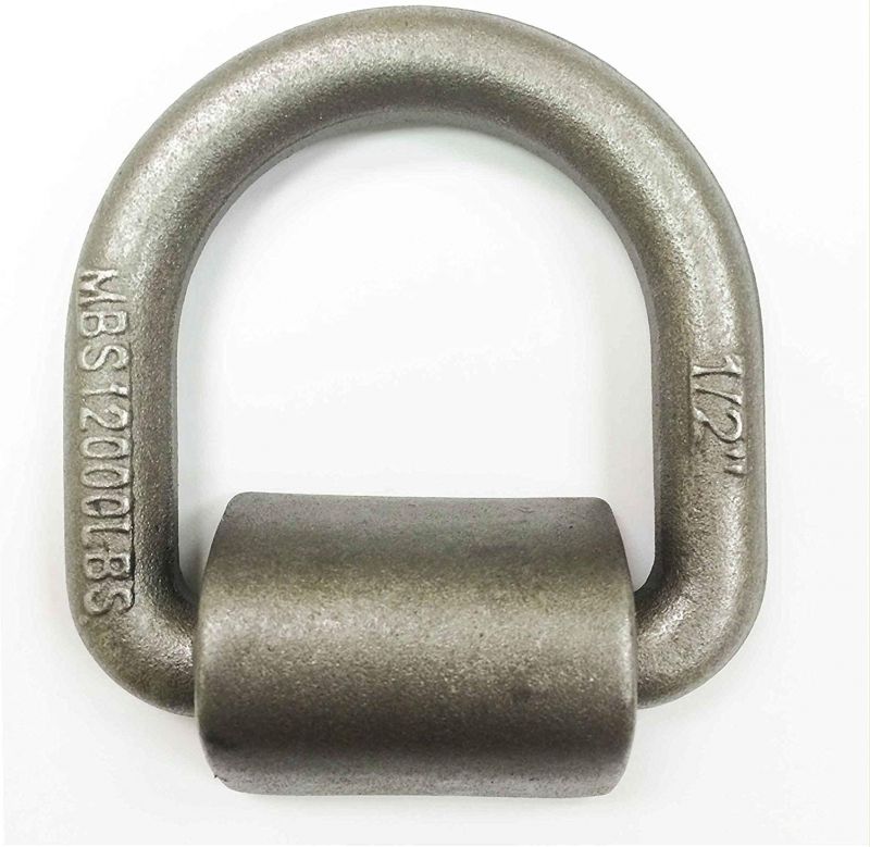

In amazon search, use weld on 1/2 D rings. They come in singles, 4 packs, 6 paks, 10, 12pak and so on.
Welded on D rings
Welded on D rings
Weld on D ring 12K rated
Rear bindiners
Rear bindiners

Toy: When you welded your hooks, did you grind off the paint first?
sparky30_06
# Posted: 7 Oct 2019 07:25am
Any time you weld you want to make sure your metal is as clean as possible. Grind all paint and rust until you have good clean base metal, if you want your welds to hold. Make sure you use the right rod and get a good burn on them. If you are using a small rod you may want to put multiple passes on it.
Remember that those D rings welds need to hold that tractor down not only driving down the bumpy roads but also if an accident happens.
# Posted: 7 Oct 2019 08:43am
Quoting: DaveBell
Yes, I didnt use a grinder, I used a scotch brite pad in a right angle air grinder, this removes the paint, but doenst blemish metal surface. You want clean bare metal for welding. A propane torch and warm up paint, then wipe off. Factory paint on these is pretty durable and tough.

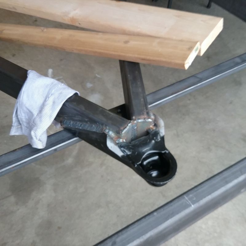

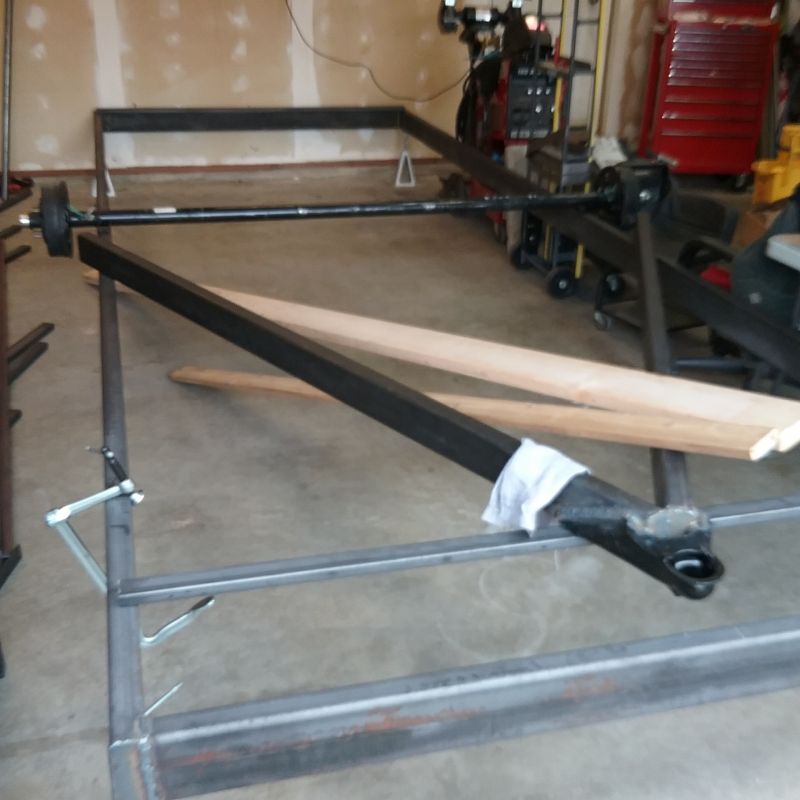

Started on another 18 foot flatbed trailer. Cloning mine for a friend. I mean doing a chinese reverse engineer, Hey, no since in reinventing the wheel. Its going to be a perfect twin to mine.
Perimeter is done and A frame tongue is done. Axle is just setting there, not its home, ignore wood. Will be used as blocking to set fender height above tires.
Just started Sunday at noon, hitting it the next 2 full weekends, should be done by then.
