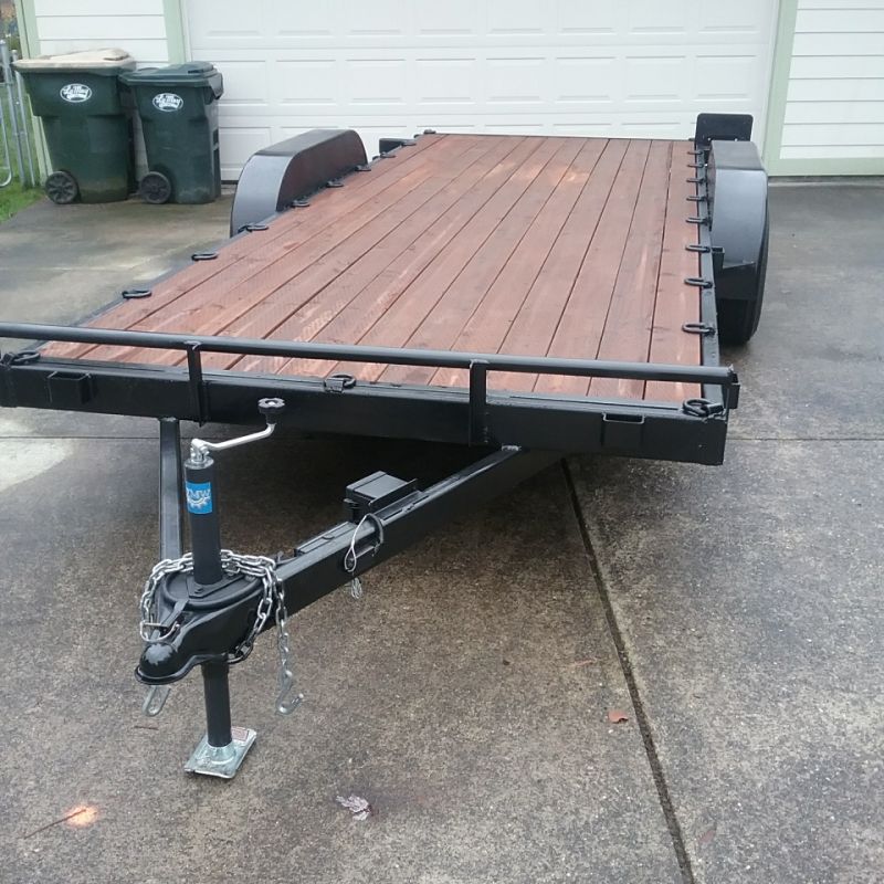

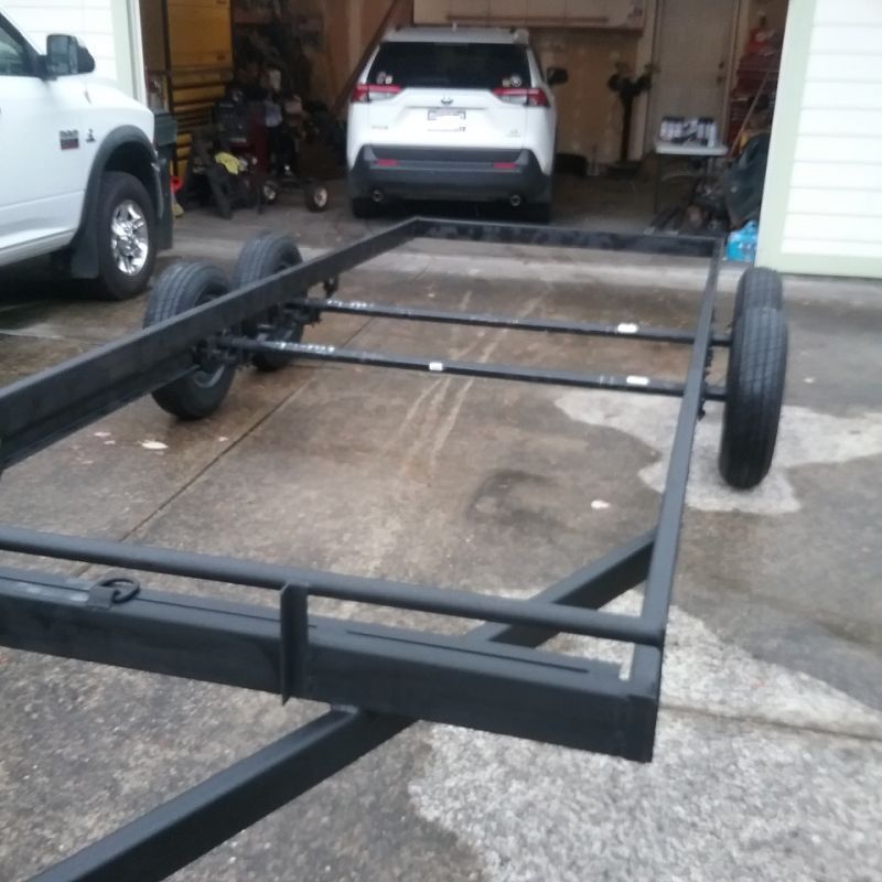

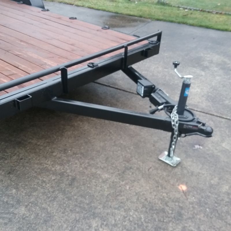

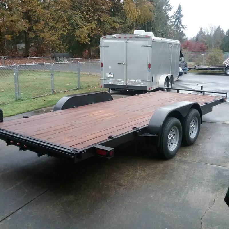

OK, decking will be 2X6, need to hang fenders, build under deck ramps and attachments, tail lamps and all wiring, stake pockets and 1/2" D rings down each side. We put on in the middle front to winch up a deal car if needed. So far, 3 days of work, about 6 to 7 hours per day. I figure 2 more days, maybe 3 max and its all done. I have all the metal cut for the ramps, just need to glue them together.

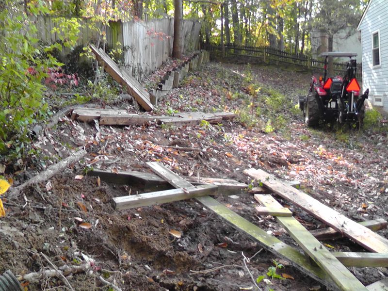

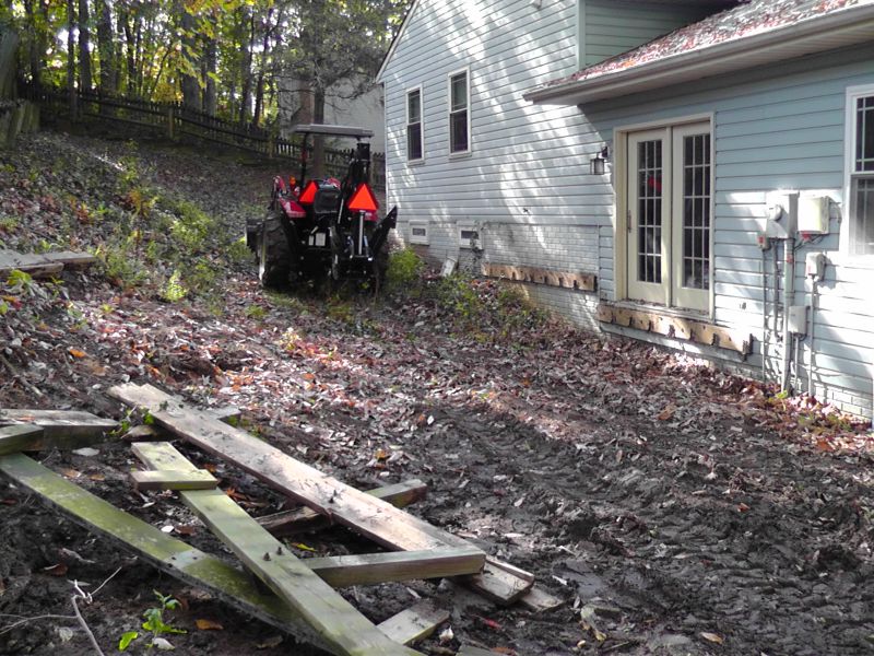

So, day 2, tearing out the deck. Ran over a board nail, right front tire goes flat. Front loader is also the tire jack, lifted the front end right up. Plugged the tire, inflated it. Tomorrow we attack the retaining wall that does retain anything.

I see I need to follow up with my trailer build too for tractor hauling. Maybe add some final pictures.
# Posted: 2 Aug 2021 09:51am
Toy, thanks for the advice. Multiple shallow passes sounds good. Nice work on the trailer.
