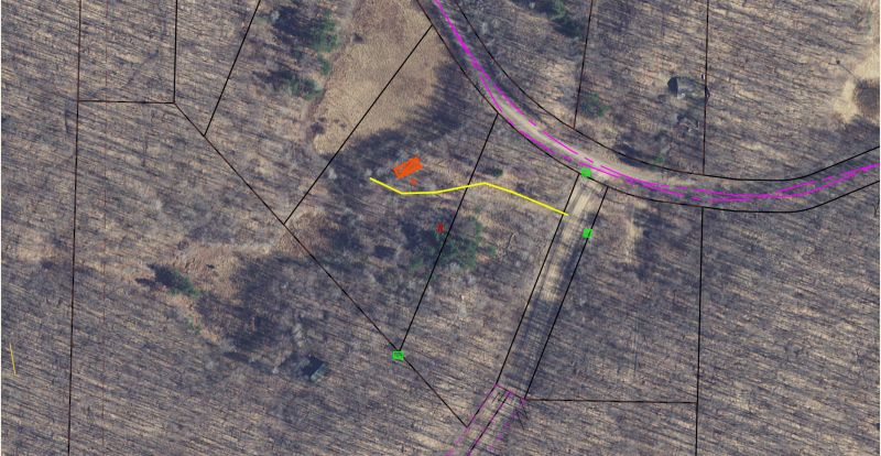

Just bought 6 acres in NE Wisconsin and we would like to have power run into the property.
The local power company will run power up to the meter located either on a structure or a freestanding pedestal.
They will run up to 250' until another transformer would have to be installed. The cost for this is $8.50 per foot. If you don't need a transformer and it's service power only (so 250' or less) it's $6.50 per foot and the first ~125ft is free.
In my photo below, the red box shows where we plan to setup our camper for now, tiny cabin later. The yellow line shows the driveway we plan to clear to the spot. The green boxes show current transformers on or near my property. Going from one of the two transformers in the top right, our spot would be ~400ft from either one. The ~250ft mark would be where the yellow line goes from horizontal to bending towards the bottom left.
So what would be the most economical way to get power to the spot we've chosen? Have them run 250' in ($812 after 125' free) to a pedestal and then i run my own line from the pedestal to a sub-panel located by our spot? Or do i have them run 275' in and drop a transformer and then run another 125' to my pedestal. Only cost for this option would be for the 275' to transformer which would be $2338
Looking for ideas/ways to keep the cost down.

I had a similar situation and I found the most helpful thing to do was to call the guy at the power company and send him a picture just like you have here. You want power here at this spot for a few years years and eventually you plan to build over here.
When I did the same thing, he came up with a plan that I hadn't even thought of. After watching them use their purpose-built machinery for installing underground cable I pretty much would never dig another trench if I had the option.
They did a 300 foot run for me in about 20 minutes using this tractor sized sewing machine looking thing - it plowed a perfect trench a couple feet deep in front, int he middle it dropped the cable and then stitched up the earth behind it. After they ran over the stitch with the truck on the way out you could hardly tell they were there.
Knowing what I was planning to do in the future, they left plenty of expansion line in the cavity underneath the transformer so it could be moved later when needed.

Well i met with the engineer/designer from the power company this weekend up at the new property. Let me say that if you can get one of these folks onsite vs. just over a phone, it makes a world of difference having that conversation in person and onsite!
Although i spoke at length to another engineer/designer early on in my land search, the info was either inaccurate or i misheard it.
Anyways, i was under the assumption i had to calculate my footage from an existing transformer. Come to find out that was not true and they were willing to drop another transformer closer to my driveway or in my property depending how far back i wanted to be. This was great news as my primary driveway was almost 100' from the nearest transformer.
The bad new was our chosen spot was 300' down the driveway. So my options were to run heavier gauge service wire from a transformer dropped at my driveway entrance and assume the risk of voltage drop, or bring a transformer into the property and pay $$ for primary and service wire.
As the engineer pulled up a map showing all the wire in the area and i noticed the wire running along my property on the other road (i am on a corner lot)near what might have been an old driveway on my property. I said can we tap into that wire and he said sure. Come to find out i've got enough clearance going through the woods from this spot so that a service line would only be 160' from the road!!
He didn't want to commit hard numbers onsite, but he's thinking my cost will be around $500 to bring power in!!! This was great news! So i should be receiving an official quote this week.
Now all i have to go is send in the check as soon as the quote comes and that'll get me on the schedule. Then i just need to install the meter base/panel i choose from their approved list. Then we should have wire run in ~3 weeks. Once that's done, inspector has to sign off on the pedestal and they'll activate power.
