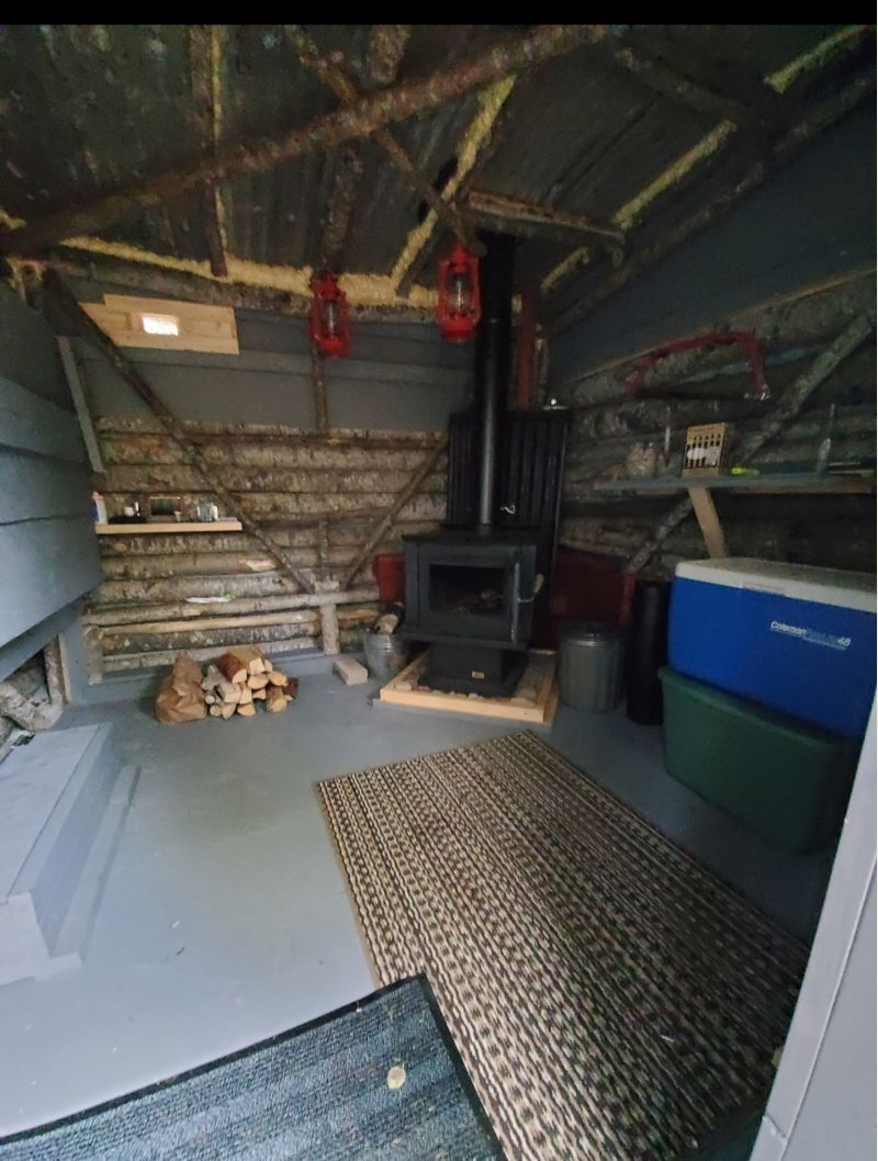

Pictures would help

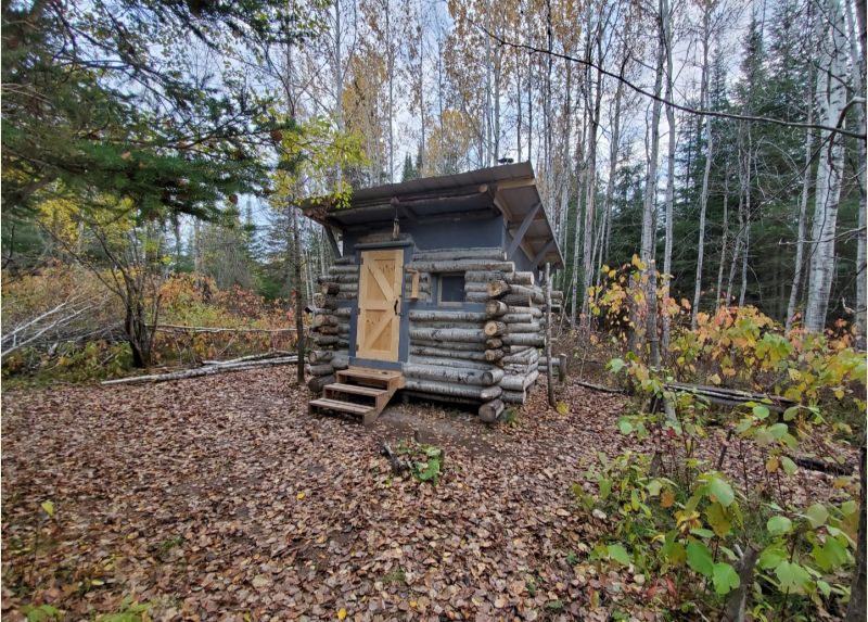

Here's a couple pics
TheRealNorthernOutdoorsman
# Posted: 9 Oct 2020 02:17pm - Edited by: TheRealNorthernOutdoorsman

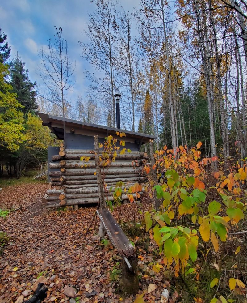

Another pic
# Posted: 9 Oct 2020 02:20pm - Edited by: TheRealNorthernOutdoorsman
Another pic
# Posted: 9 Oct 2020 02:32pm - Edited by: TheRealNorthernOutdoorsman
The pipe is clear...no blockage...its all bran new
...if I hold burning newspaper up the chimney it has a bit of a draw...when I pull it back into the stove it burns but all the smoke comes into the cabin....playing with the damper and adjusting the opening of the stove door doesn't help

I'm thinking the cold pipe and cold air and length of pipe and single wall pipe are too much to overcome to get a draw going.
# Posted: 9 Oct 2020 05:25pm
https://fireplaceuniverse.com/why-wood-stove-not-drawing/
Fanman
# Posted: 9 Oct 2020 05:53pm
Yes, the black pipe outside may well be the problem, it cools too fast. Black pipe should only ever be used inside, it should transition to insulated chimney pipe before it passes through the roof.
# Posted: 9 Oct 2020 07:00pm
Quoting: Fanman
Yes, that is likely making this installation not work well. Single wall is also dangerous if it was used to penetrate the roof. Do the install right and it should work right.

Just for fun, take the chimney cap off and try it without a cap. Hard to tell from the picture but everything else looks right, the cap looks a little odd from what I can see in the photo, the design might not be allowing enough draft, especially if there is no breeze blowing.
Love the cabin by the way...
