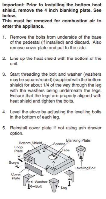

You did not say which model Regency stove you have. So, I picked one at random from their website and downloaded the manual. There is an interesting note on one page. See the picture. If your stove has a similar "blanking plate" has it been removed as noted in the sample image?
manual
manual
# Posted: 14 Oct 2020 08:29pm - Edited by: ICC
I also note there is a minimum flue length listed and this gets longer and longer as altitude increases. Is your installation within those guidelines for your stove? I assume if they have chimney length specs for one of their stoves they will list specs for every model.
