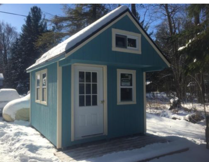

ShantyBay
# Posted: 7 Nov 2020 05:46pm
Hello Everyone:
I've spent quite a bit of time surfing the internet trying to find plans for a 10' x10' or 9' x 12' shed/bunkie complete with 4 foot overhang/porch for a loft, there are plenty of companies that want to sell me a prefab kits but no plans available for purchase.
Sooooo I am circling back and attempting another longshot hoping that someone on this forum may have plans that I would willingly purchase to help me with my fist DIY .
Looking forward to great replies
ShantyBay
Reference photo as concept idea of what i want to build.
frankpaige
# Posted: 7 Nov 2020 06:24pm
https://jamaicacottageshop.com/shop/component-bnkh-plans/ $79.00 USD.
