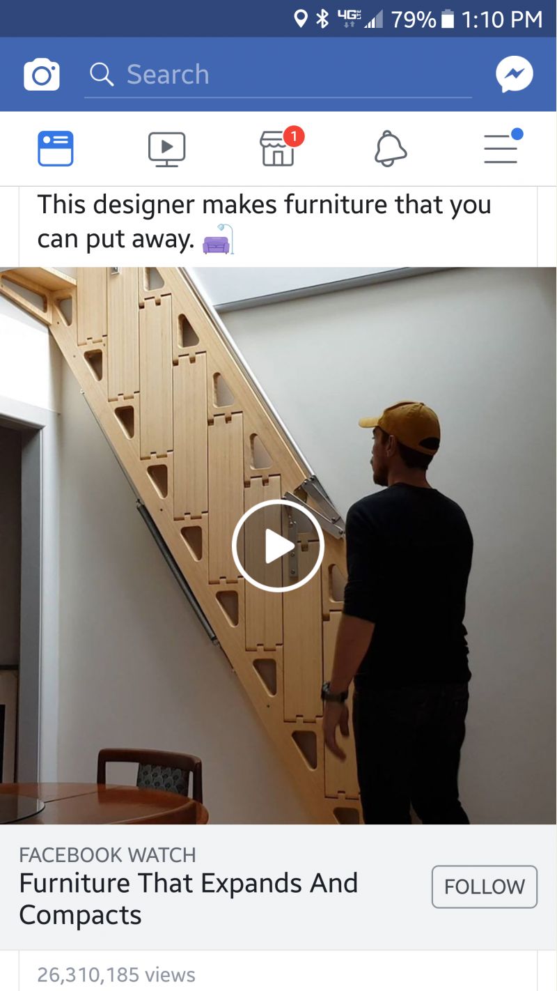

dsmith14469
# Posted: 9 Feb 2021 12:04pm
I saw these once but no longer have the link. The stairs fold down to use and fold up when done.

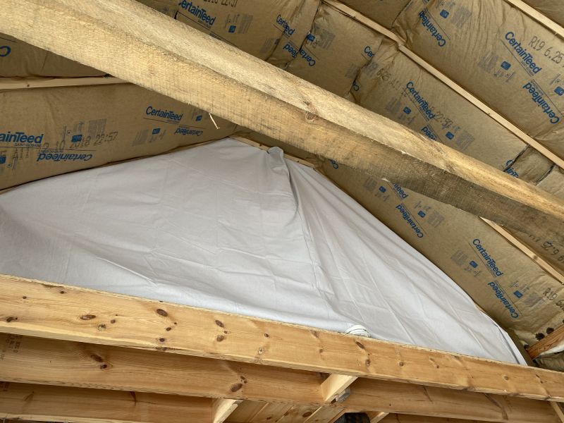

Irrigation Guy
# Posted: 9 Feb 2021 01:28pm
Quoting: Brettny
I have slept in lofts and I have slept in the lower floor of lofts with people sleeping in the loft, Heated by a wood stove. The people on the ground floor are frozen and or feeding the fire and the people in the loft are having the window open all night or it's hot as hell. Even with a large ceiling fan going full time theres just a huge temp difference. Hot air always rises and cold air always sinks.
We were having the same issue so I stapled a canvas painters tarp across the opening to the loft and it has helped a lot. My son slept upstairs last night and said it was comfortable. Last time he was here they were sweating. I plan to cut it to fit and make some hooks to hang it easily.
