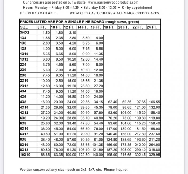

# Posted: 14 Feb 2021 05:11pm
I used all rough sawn from the local mill when I built my addition and saved considerably from the lumber yard. And when finishing out the interior using the rough for the ceilings may not have been cheaper than sheet rock but I got it cut and nailed up and was done with it in an hour and a half and it looks cool.

# Posted: 16 Feb 2021 07:50am
Irrigation guy. Those prices are about the same as my local mill is showing too. There prices really haven't gone up in years.
