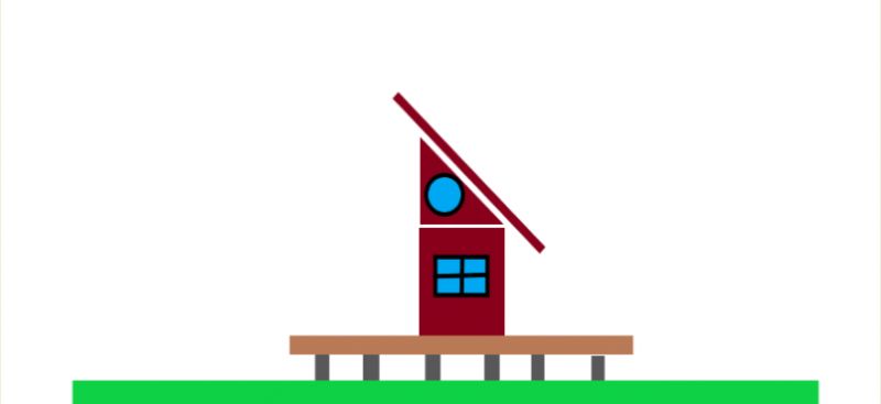

anyway my idea is a tall and skinny 10x20 with a 10x10 loft area. single pitch roof 24 inch overhang on all sides, with one wall either 16 or 14 foot on the tall face, and either 12 or 10 foot respectively, with the loft being either at 8 foot up (for the 16 by 12 foot wall) or 7 foot (14 by 10)
perhaps it would be easiest to just show a basic sketch
anyway, obviously its taller than wide, which isnt the greatest for balance, however, if anchored to a sono tube pier post deck it should be fine right?
i get a good snow load up there so metal roof obviously, woodstove too, its going to be a ski cabin,
10x20 downstairs for a living/hangout area and a large 10x10 area up top for sleeping/storage/whatever

Rather than snow I'd say your primary concern should be wind. A roof with 24" overhangs is going to act like a sail.
I would put the roof on so that the ceiling is lowest over the living space and highest over the loft so if your cabin is 10 x 20 and your loft is 10 x 10 over the east side of the main floor your roof would slope up towards to east.
This avoids having a high ceiling over the living space {empty space to heat}and you get a full height loft wall along the east side.

My logic for going with a single pitch ceiling is for more cubic volume as an emissions compliant wood stove is a bigger deal where I’m at than an actual permitted building, and more cubic volume will help regulate heat with a wood stove meant for a building 3 or 4 times as large, larger area to heat, greater heat transfer, to those familiar with engines, basically a larger plenum that will be more forgiving to manage a stove with an almost 50,000 btu output in an almost 2200 cubic foot area (if my math is right)
Chinook92
# Posted: 3 May 2021 10:59pm
And I am in deep timber, I have yet to experience high winds where my property is at
Another idea to add to my sketch is posts going from the lowest part of the roof anchoring the lee side of the roof to the deck/foundation making for a greater support and to off set any fulcrum the wind may produce, although the bulk of storm damage appears to be from heavy snows followed by rain and then wind, I am down in a river bottom at 1000/ft elv. With 3000-7000+ peaks. Ice and broken tree limbs seem to be my biggest enemy

If you want tall and skinny a gambrel roof gives you the most loft head room and keeps a decent pitch.

Hey there! I'm in Washington and I built a 12x20 (fudged the sq ft requirements a bit since I'm so deep out there...) shed roof style cabin this past year with a pretty major overhang and no permits. Definitely got some flack here for how much I cantilevered my roof. Sue me.
My walls are shorter (12' and 8'), so the loft is really just a place to lay. I'm pretty short and so built the cabin loft height as ideal for me to have enough space in the kitchen and optimize for loft space - tall humans be damned.
Couple things to consider:
- my roof slope is pretty low, which means i had to beef up my structure to ensure it could carry the full snow load in case it didn't slide (this is similar to the way the swiss build often). Make sure your wood stove is on the high side and has roof braces installed before your first winter.
- wind will be huge for your roof. You'll want to have hurricane ties on your rafters to top plates.
- it's a lot to heat if you have high ceilings. get that big boy stove!
