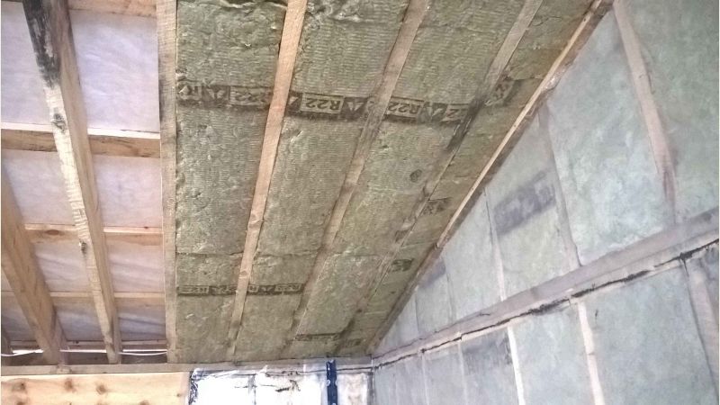

I am building a 12x14 weekend cabin. I plan to do a metal roof with no underlayment. So, I will do 24" on-center 2x8 rafters with generous blocking, R23 rockwool, and then wood 1x shiplap boards on the inside. This will be a lean-to/shed-style roof, i.e. one eaves low and one high, no ridge.
The cabin will be in a dry NorCal mountain climate zone that is also a fire risk area. I see no need for the cost, effort, and fire risk of putting wood underlayment down.
As there will be no attic, I need to ventilate the rafter bays. I was planning to put a metal mesh screen 1" below the top of the rafters to keep the insulation in place and maintain a 1" channel for air flow from the low eaves in the rear to the high eaves in the front. I will put fire-code compliant mesh to cover the openings at both eaves. I am thinking that if I let the corrugated roof panels hang several inches out from the house at the high end, I won't need a drip edge.
Any reason not to do this?

Theres really no good way to vent a metal roof with bat insulation. The risk is an air leak..that you will get with batt insulation and mold starting in the attic.
Can you use 2in foam board ontop of the roof rafters then perlins ontop of that?
As for the 16-24in on center idk..what does the span calculator say?

I built a 14x24 shed-style workshop building last fall. Rough-cut 2x8's on 12" centers were used as rafters. 1x4 strapping on top, plus layer of Tyvek, then roofing steel on top. The rafter bays have snug-fit R22 Rockwool batts (custom-cut due to 12" centers and non-dimensional lumber) with vapour barrier, then siding steel inside as a ceiling. Vented aluminum soffit panels are used on the high and low sides of the roof.
The venting gap above the Rockwool batts is huge in my case: 3" plus if the strapping is included, so no other venting channel material was used there. For your application you mention blocking in the rafters - does that not interfere with the venting?
Weekend occupancy only does allow lots of drying time between heat cycles. There's many places in my area with questionable insulation and vapour barrier that have been used for decades with similar "duty cycles".

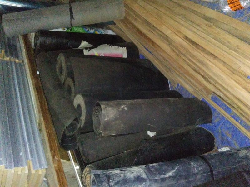

Speaking of tar paper, what about using it? Too much sag between perlins? I have many rolls.
# Posted: 21 Jun 2021 11:09am
Paul, for a carport Id use whatchagot
# Posted: 21 Jun 2021 01:22pm
For a car port I wouldnt use any underlayment. I would only use anything but just perlins on an insulated space. Car port, shed, or other in insulated building just put the perlins on the rafters then screw the metal down.
# Posted: 21 Jun 2021 01:27pm
Yessir, that's the plan. I need to use up all the materials I've collected over the last decade instead of storing it endlessly.

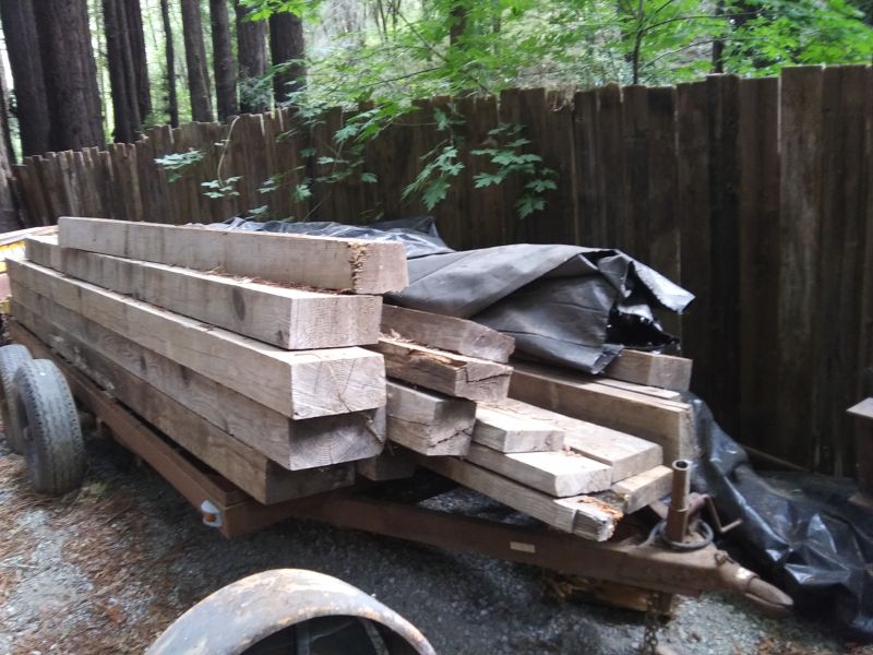

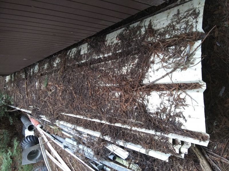

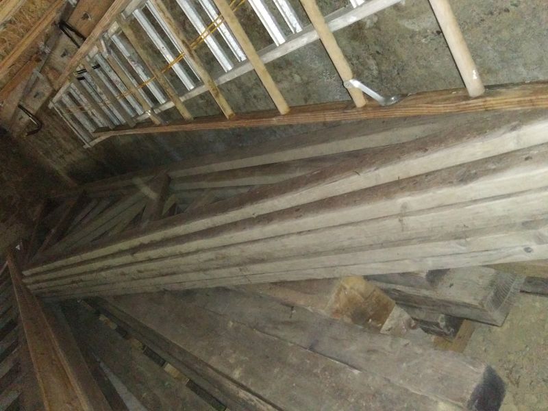

Got 6x10 and 4x10 for the posts and rails, ten 20' trusses, a dozen 3x25 metal roof panels, that 1x pine I just got for the perlins...
Like to use up the tar paper but if it's not right $100 for that Tyvek underpayment won't kill me.

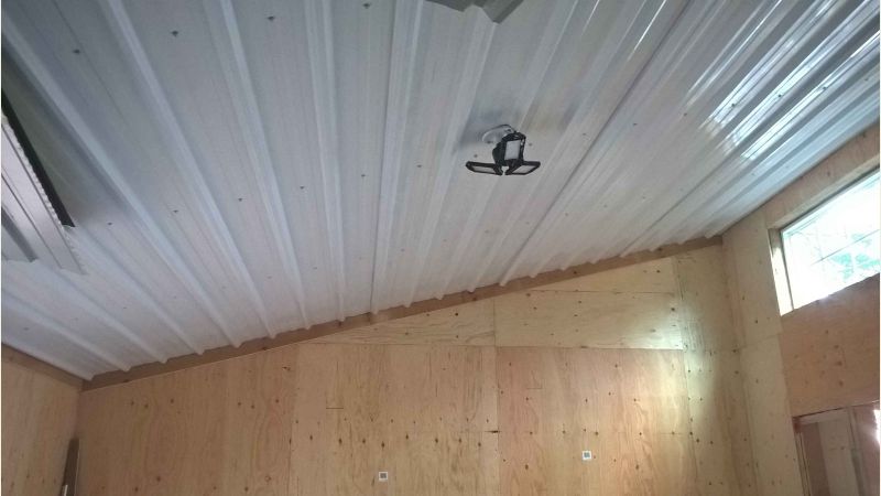

# Posted: 21 Jun 2021 02:45pm
You wont get interior condensation because the top of the metal will always be the same temp as the bottom. Even a shed with walls wouldnt condense.
