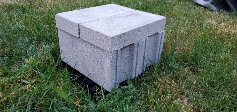

I was at the home hardware today and was explaining how i was building my piers and they told me that the solid 3" concrete blocks would not hold the weight of the cabin and would just disintegrate into pieces from the shear weight. Now i find this a little hard to believe, but here I am asking the real experts with experience
So, Plan "A" was to build 1 layer of 2 8x8x16 concrete blocks on top of a 2" ABS mini-home pad. Then place 2 solid concreate block of 3x8x16 sitting on top. Then i would have a Pressure Treated spacer on top (not shown in picture) and then the skids/girders on top of that. The guy at home hardware said the solid blocks were not made for compression and would break apart.

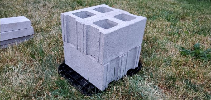

If the first plan goes to shit, Plan "B" is to use the same ABS mini-home pad, then 2 layers of 8x8x16 concreate blocks and a layer of PT spacer, then the skids/girders
so my question, structurally, do any of these 2 design have capacity to fail under load?
Plan "A"
Plan "A"
Plan "B"
Plan "B"

They make 8x8x16 blocks with no holes.
How big is the building and what's the frost dept?

If you stand the blocks with voids so the void is open to the top that is correct and as strong as that block can be. If the block is laid on its side so the voids are going side to side horizontally, the block can easily collapse depending on the load. So both of your pictures look okay for concrete blocks used to support a small cabin.

20x28 I would be putting on sono tubes below the frost line. That's a prety big building to keep level...and some times more blocks just means more area for the frost to push on.

Blocks have no lateral support just laying on the ground. Then only have compressive support.
Need to bed them in somehow to get that lateral support to keep the cabin from moving and side to side. This could be as simple as driving in rebar 4 feet through the blocks and mortoring them in. It's not perfect, but it would sure last a long time.
